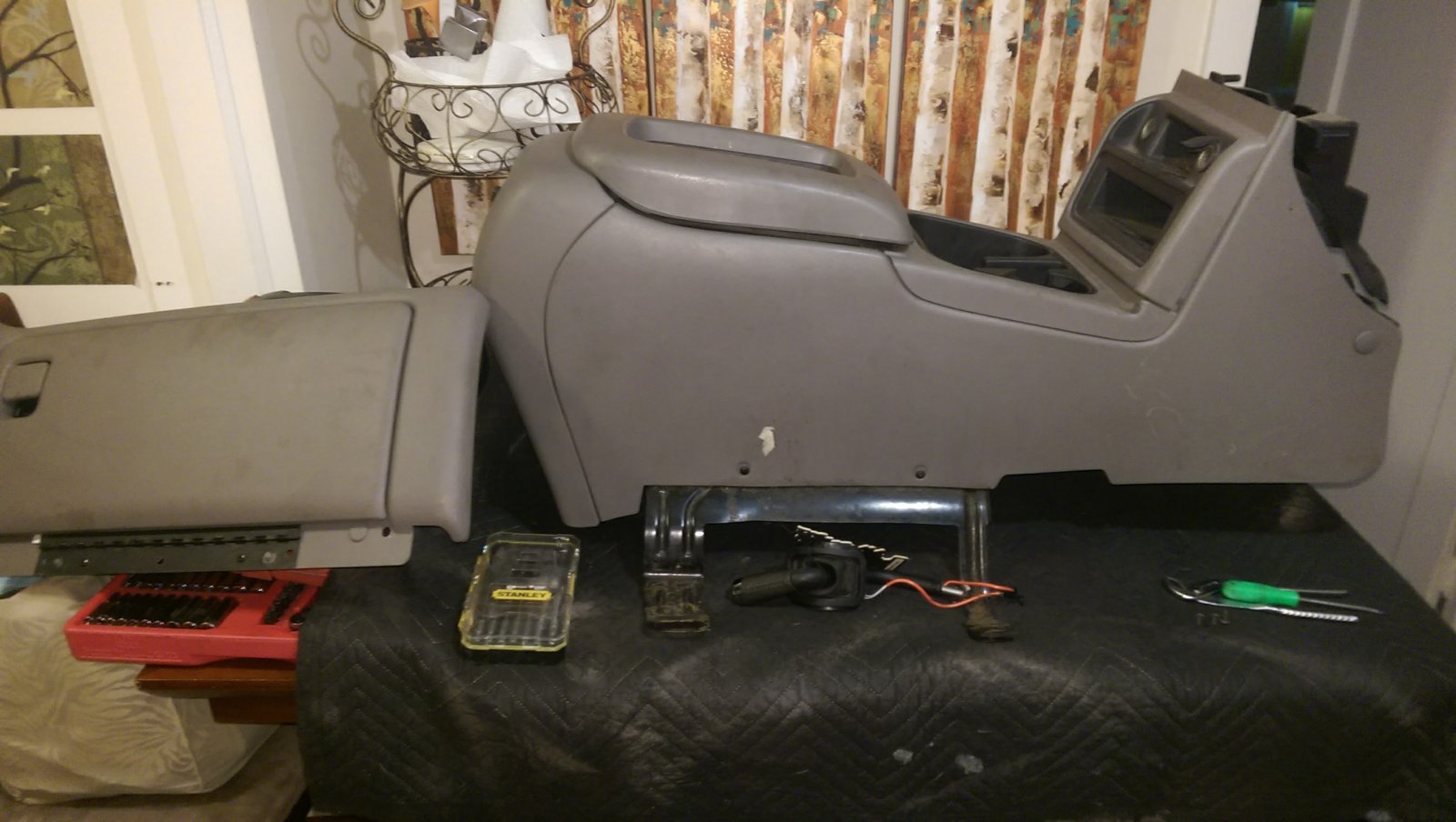

Welcome. The speaker that came behind that panel, on the drivers side, stopped in 2002. After that (2003-2006) they were in the center console. The Bose systems came with or without a subwoofer. Your RPO codes listed in the glovebox, will tell you which audio system your Yukon came with. 6 speaker system came without, 7 speaker system came with a subwoofer (or maybe its 8 and 9. Odd number system came with the sub). I think the three digit RPO code for stereo will start with a U

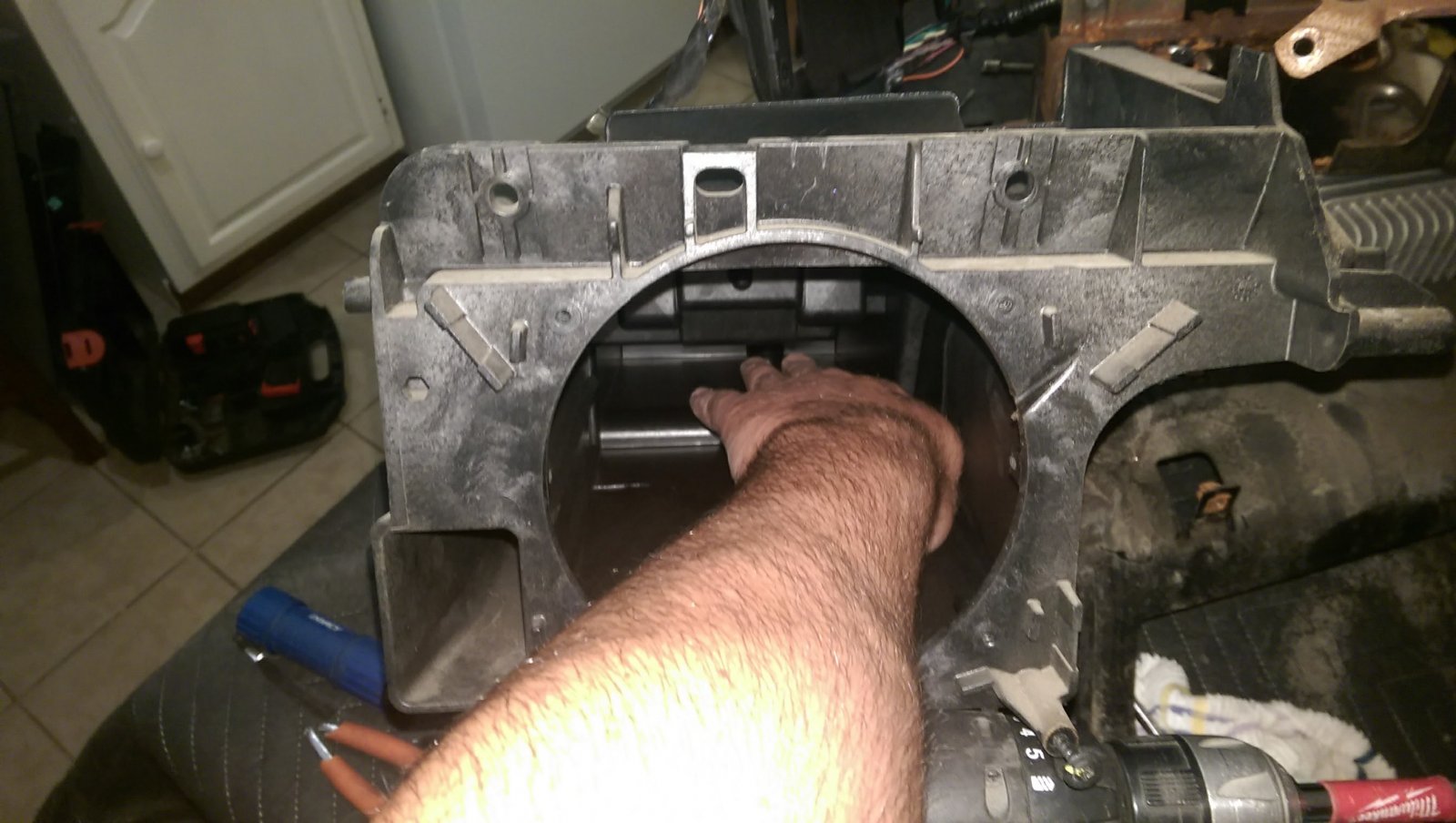

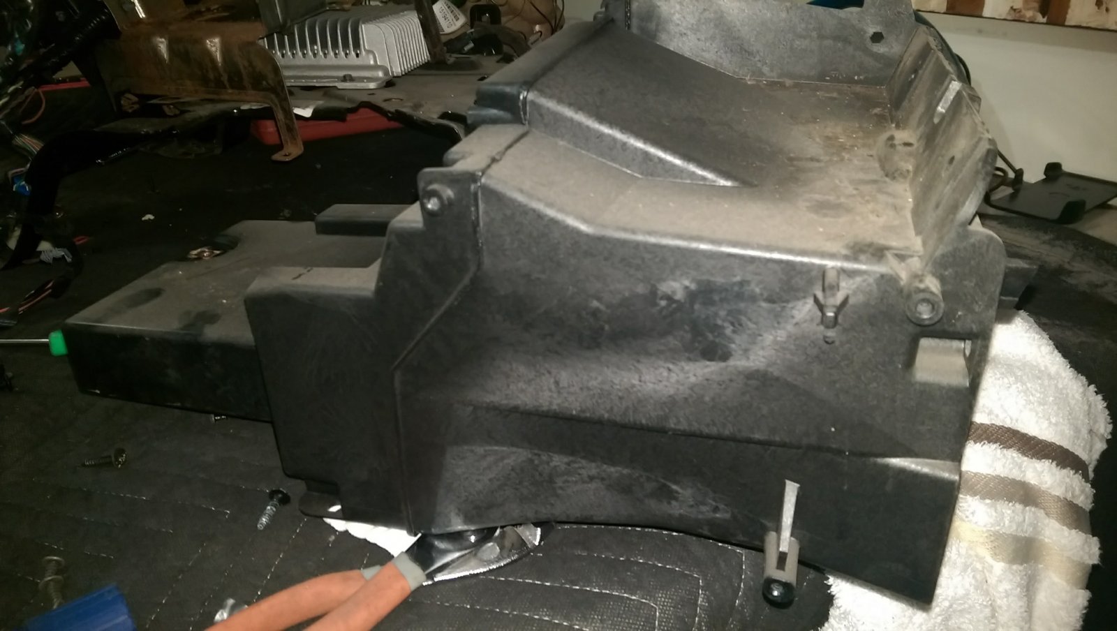

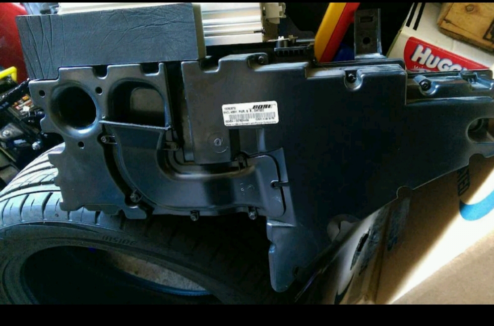

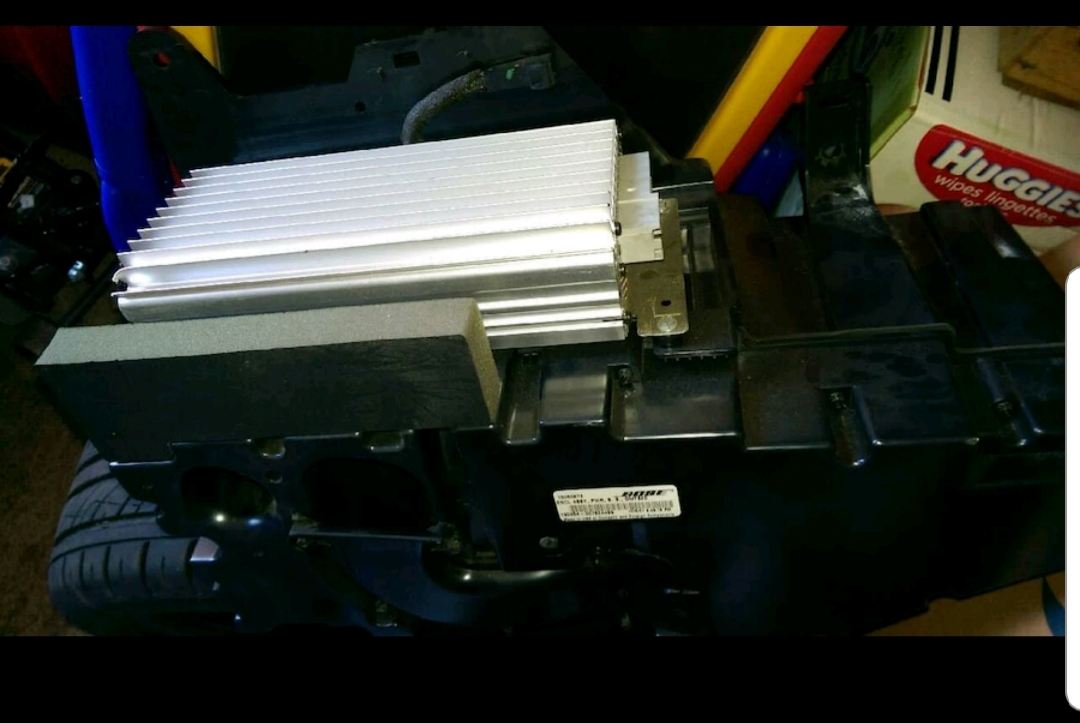

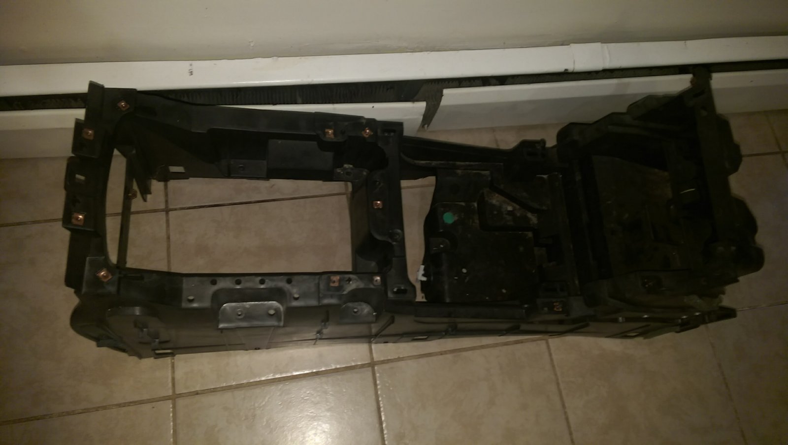

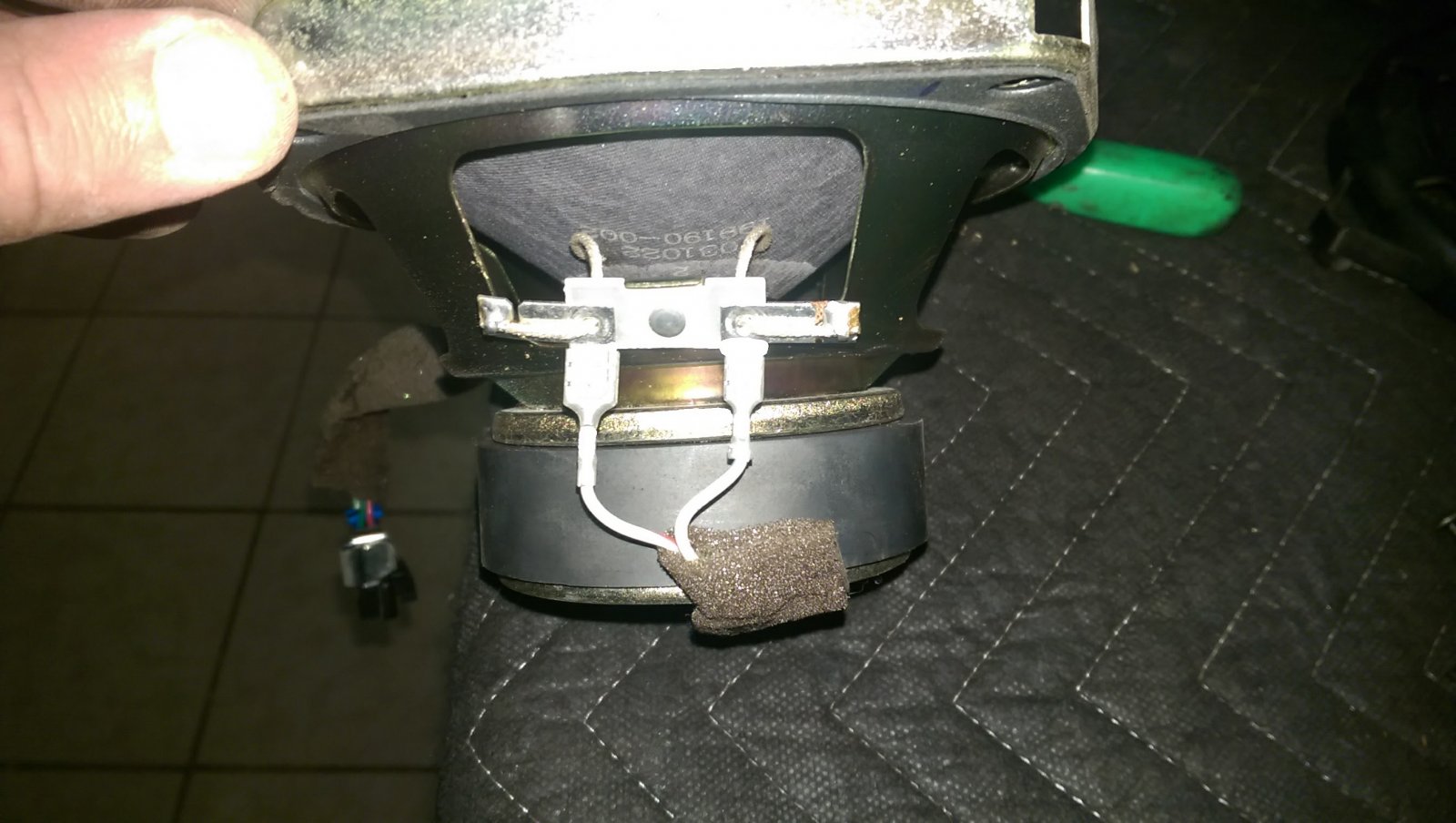

This came in an 02 Denali with Bose.
The rear speaker grill didn't have the holes cut out.
