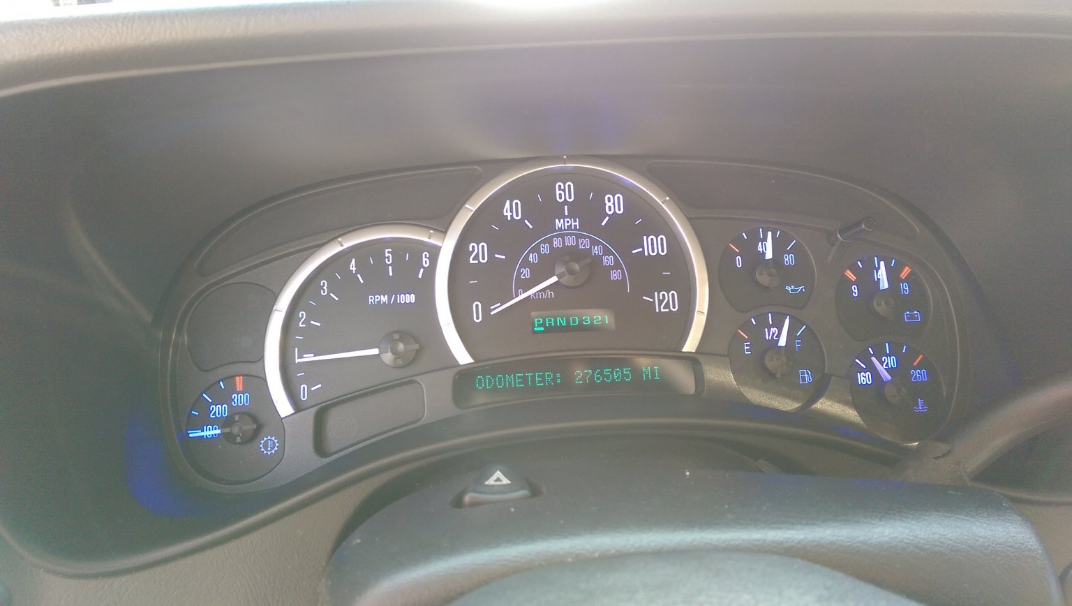

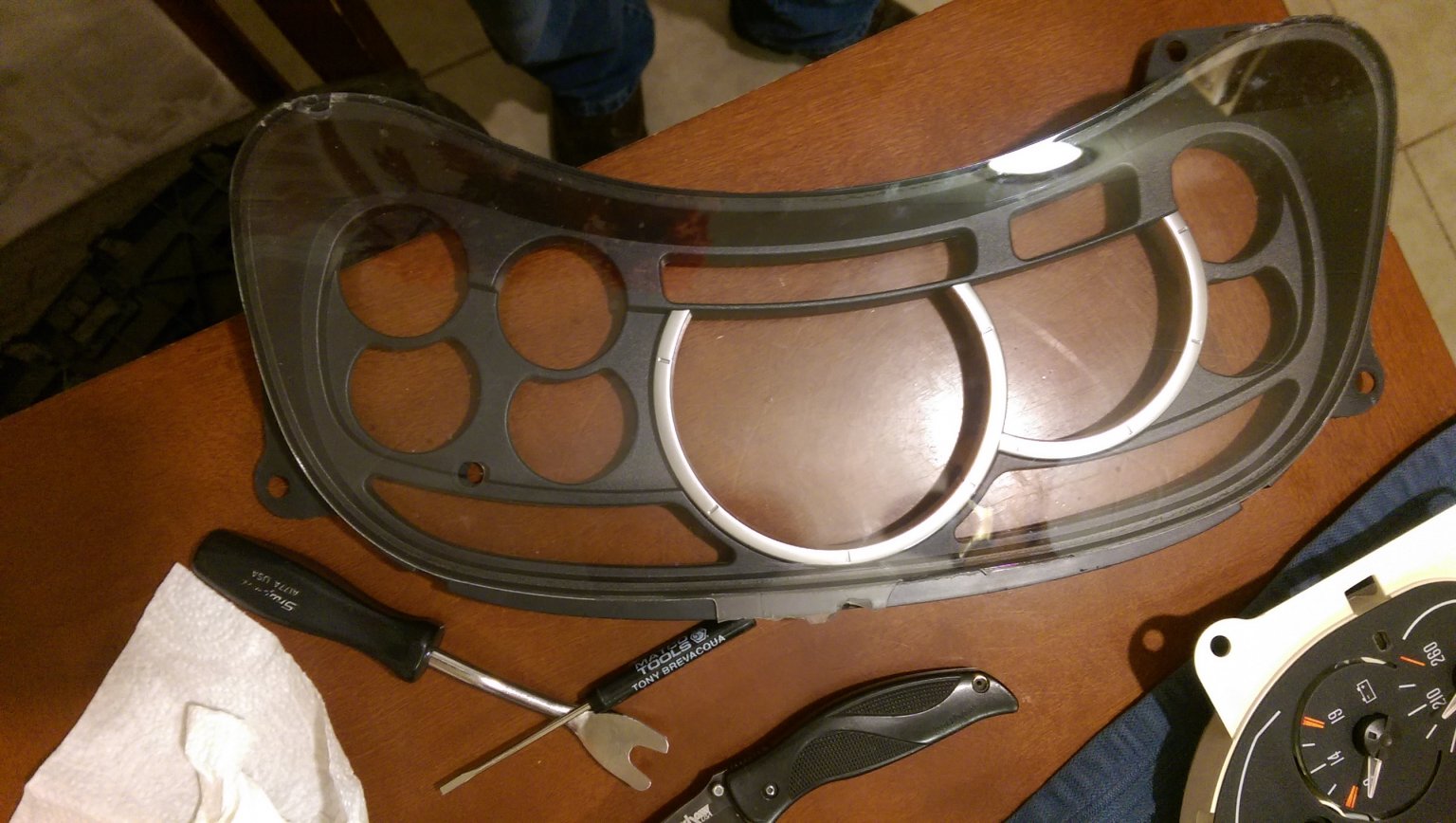

You'd have to swap out your entire cluster if you wanted to add those chrome rings. I'm not sure if they came on certain Esky models like the Platinum. I have a cluster out of an 04-05 Esky and mine aren't chrome. View attachment 80283
They're just painted and gray. View attachment 80284
Your esky cluster is out of a pre 2005 esky. 2005 and 2006 eskys had the chrome rings, both the regular and platinums versions. But the platinum versions had white backed gauges behind the chrome rings.

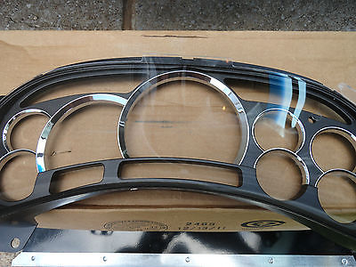

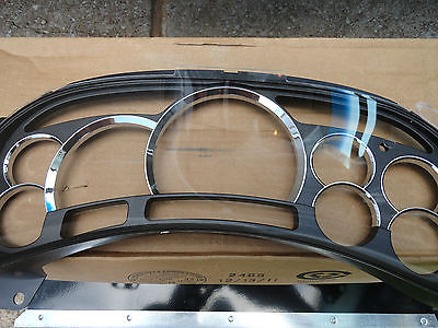

I was hoping I could just buy this (pic from eBay):
...to make my gauges look like this (pic from this forum):
I'd think it would be a fairly straightforward swap, but maybe I'm mistaken.

I don't see why it wouldn't. It's the exact same gauges and the sizes don't look different from the pics.
That's what I was thinking, BUT I'm definitely going to look into it more before I spend the money on the Esky piece. Our maybe I'll get lucky and can find one super cheap at a salvage yard locally, then I can find out for sure without having to shell out too much cash.

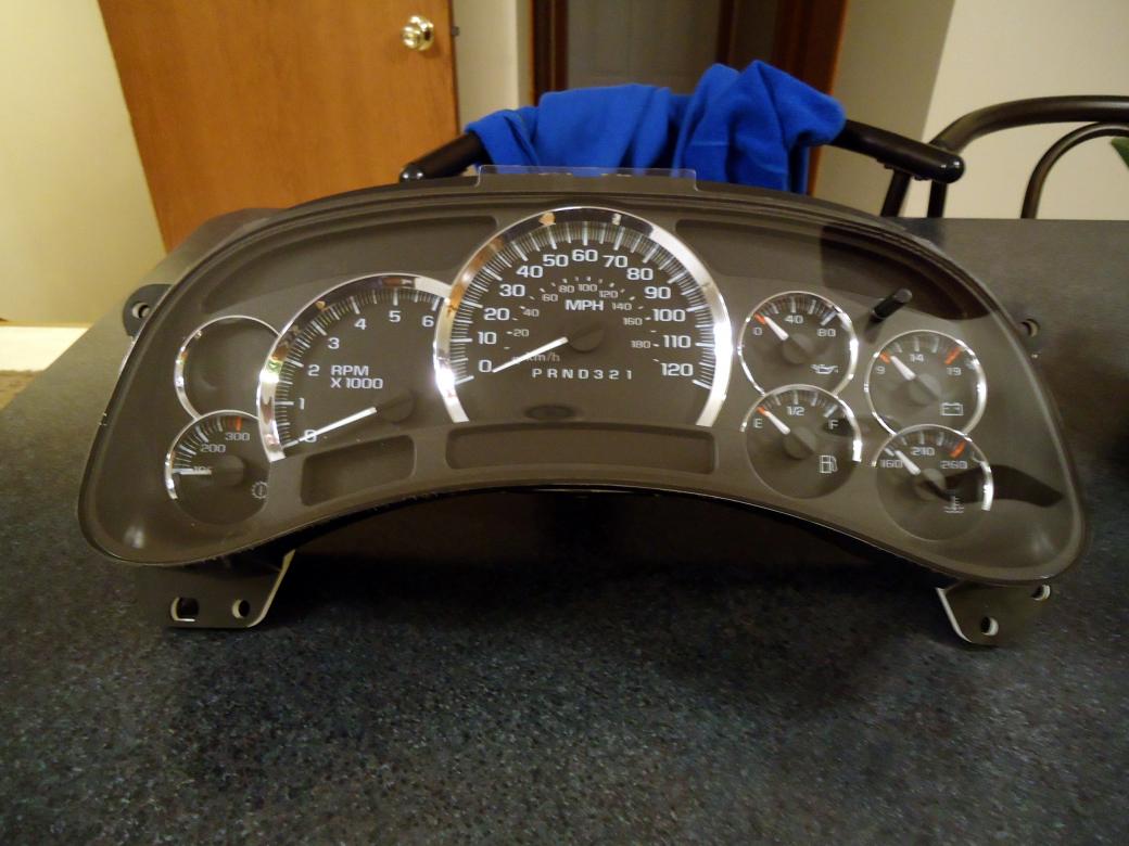

Here's an Escalade overlay on a Denali cluster with the Denali bezel. It needs an Escalade bezel. This overlay is for sale in the classifieds but it's only for an 01-02. $40 shipped.

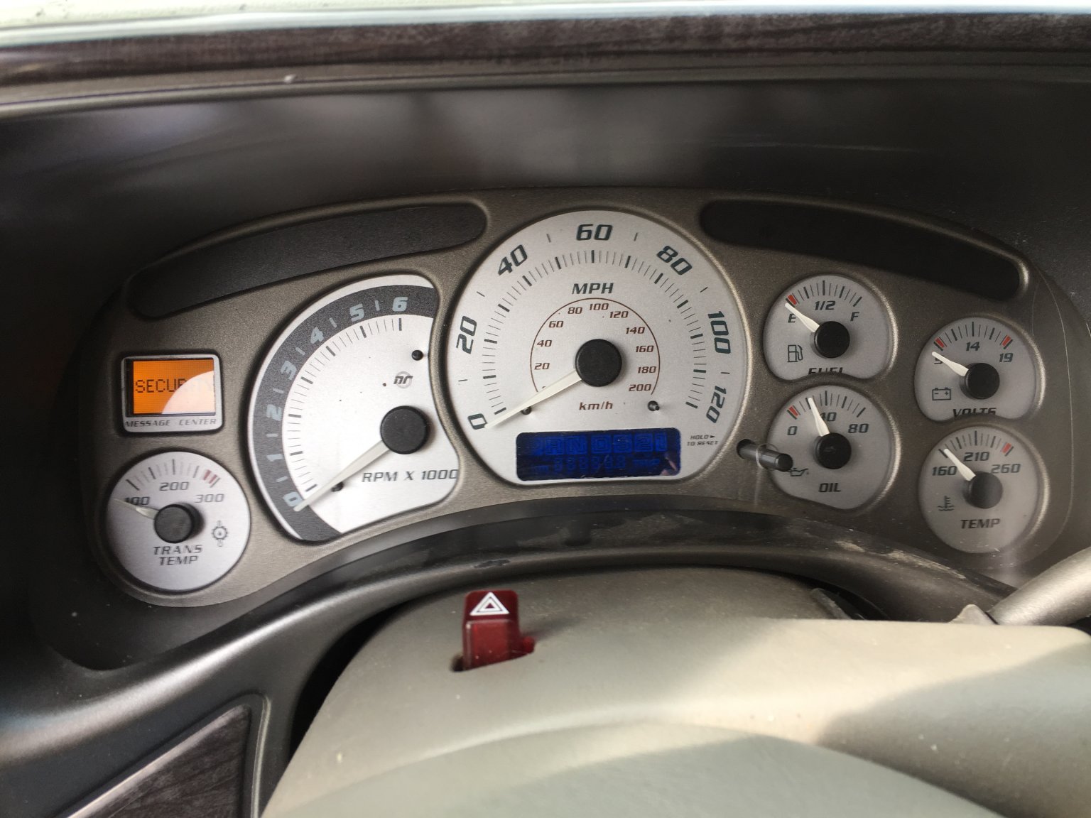

img_6252-jpg.79974
The problem here is the faces. The overlay doesn't matter. They all fit any stock gauge face. Including the SS white set.
52,954
Not according to all the vendors. The 01-02 are slightly different. Every single place I've tried to buy them from say the same thing. It's not just the faces. The gauges themselves are slightly different.
HiHoeSilver
Away!
Feb 28, 2017
10,918
14,578
Chicago
Does your stock face (or any other aftermarket ones you've seen for yours) have the words FUEL Volts OIL or TEMP on them? everything I've seen just has the symbols, which are in fine locations on that silver one (I have seen these locations vary a little but always work with different bezels).
Also where it says RPM X 1000, usually I see it up to the left on the gauge, not underneath like that, although it ALMOST fits there, I guess.
My point is, it seems to me to be a layout /printing issue with that particular face, no?
52,954
No. It is for an 01-02 Escalade. It just needs the Esky round gauge faces.
