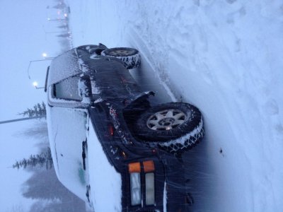

What do you reckon I need to replace here?

Lower arm for sure, looks like probably the upper arm and the inner rod end. Once you get the thing apart you'll know more for sure. I can't imagine that spindle bent instead of snapping, also can't see the sway bar bending either but you never know.
Nope! Turns out everything was straight and the upper ball joint had snapped off. $30 part later and I'm back on the road :). Glad I didn't have the body shop do the $500 arms+ labor
