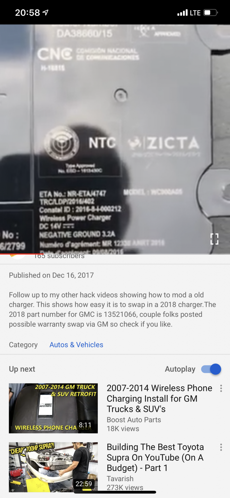

I got a 17 tahoe premier, not charging my xd max, anyone can share the part number please
Thanks
Jb
PERKINS PICHARDO
Sep 8, 2019
Thanks
Jb
The Original GM part Number is on the Text with the new Module Qi
