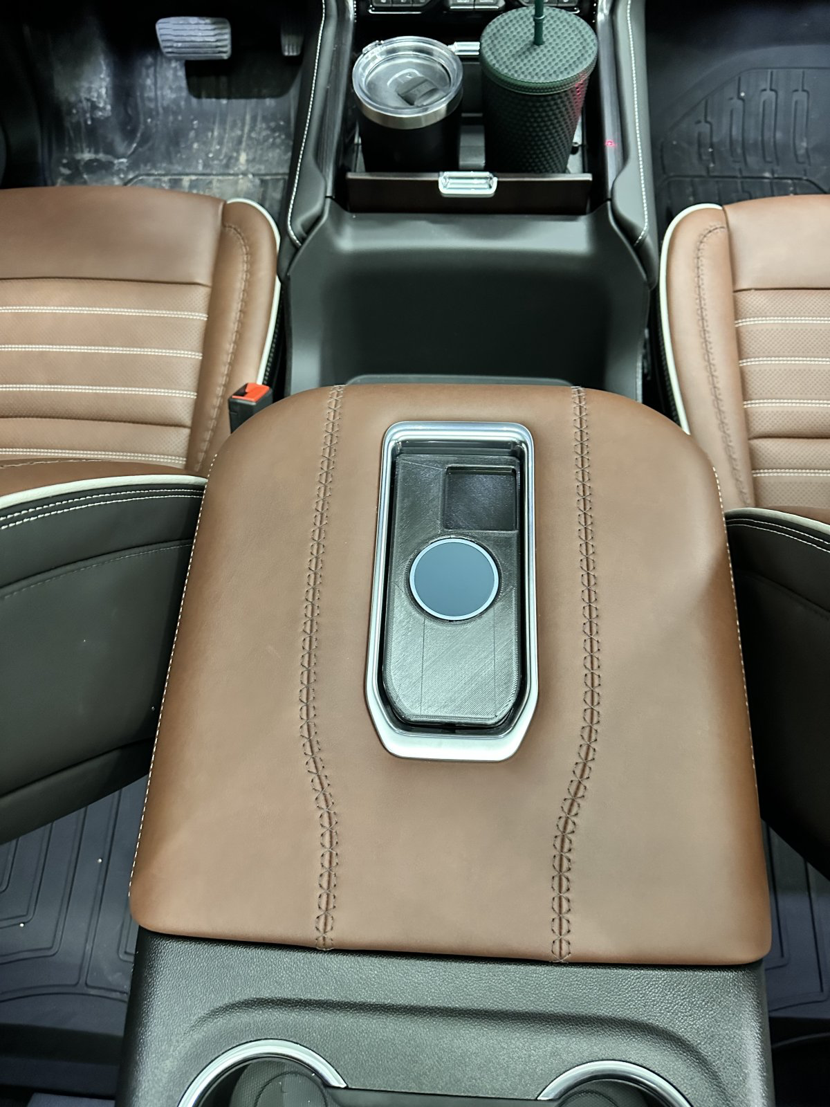

install this, will solve your problem and work much better than factory charger
My only hesitation with this device is it may present the same problem as the issue is the phone not the stock wireless charger.

It works without any issues, i even have a case on my 14 and it charges without any issues. IMO this is where gm should have put the wireless charger
Is it an iPhone 14 or 14 pro? Currently the issue is only on the pro due to the camera.

Its a pro, i can even lift the phone completely off the pad about 1/4 inch and it still is charging. Plus the added benefit is that it is a fast charge unlike the factory charger. look at the youtube video reviews
