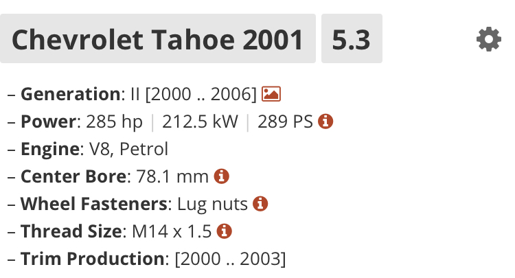

Make sure the rims have the correct bolt pattern and center bore. 6 lug 5.5” with 78.1mm centerbore
