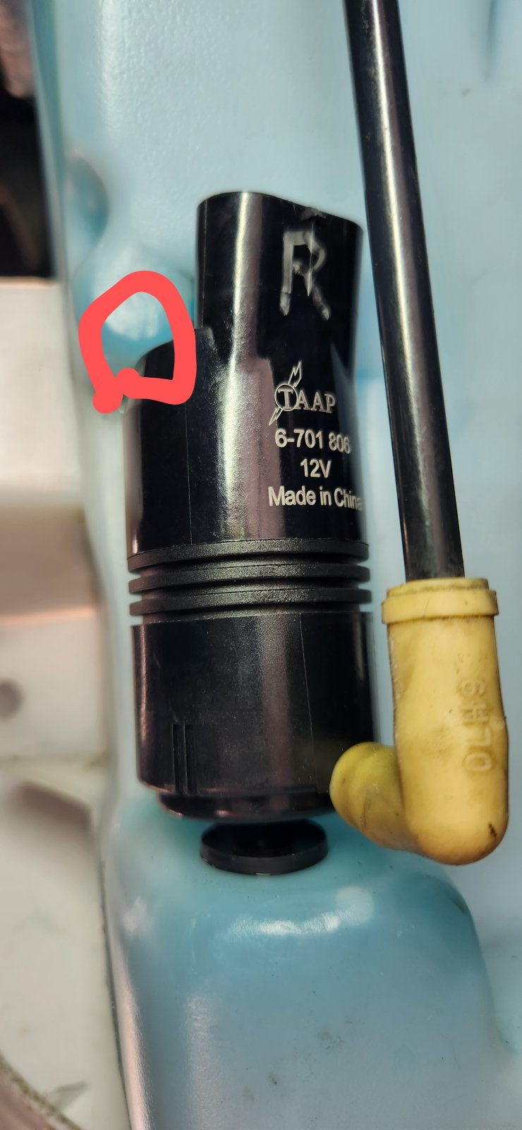

Found the problem..... A tiny leak, right at the corner, where the upper pump 'clicks' into the tank. There is a mold defect. It is very thin. I bought a new tank at Autozone ( Dorman)... $41.00.
Geeze.....
Geeze.....
Good job man.
Geeze.....
So there was a crack in the tank?? Well glad you got it figured out!!

Not a crack... I guess, during the molding process, the 'tight outside corners' developed tiny bubbles in the plastic, and eventually opened up .
I am going to get a 'warranty' free replacement from O'Reily Autoparts, then store it ...., since the new one is from Autozone.
