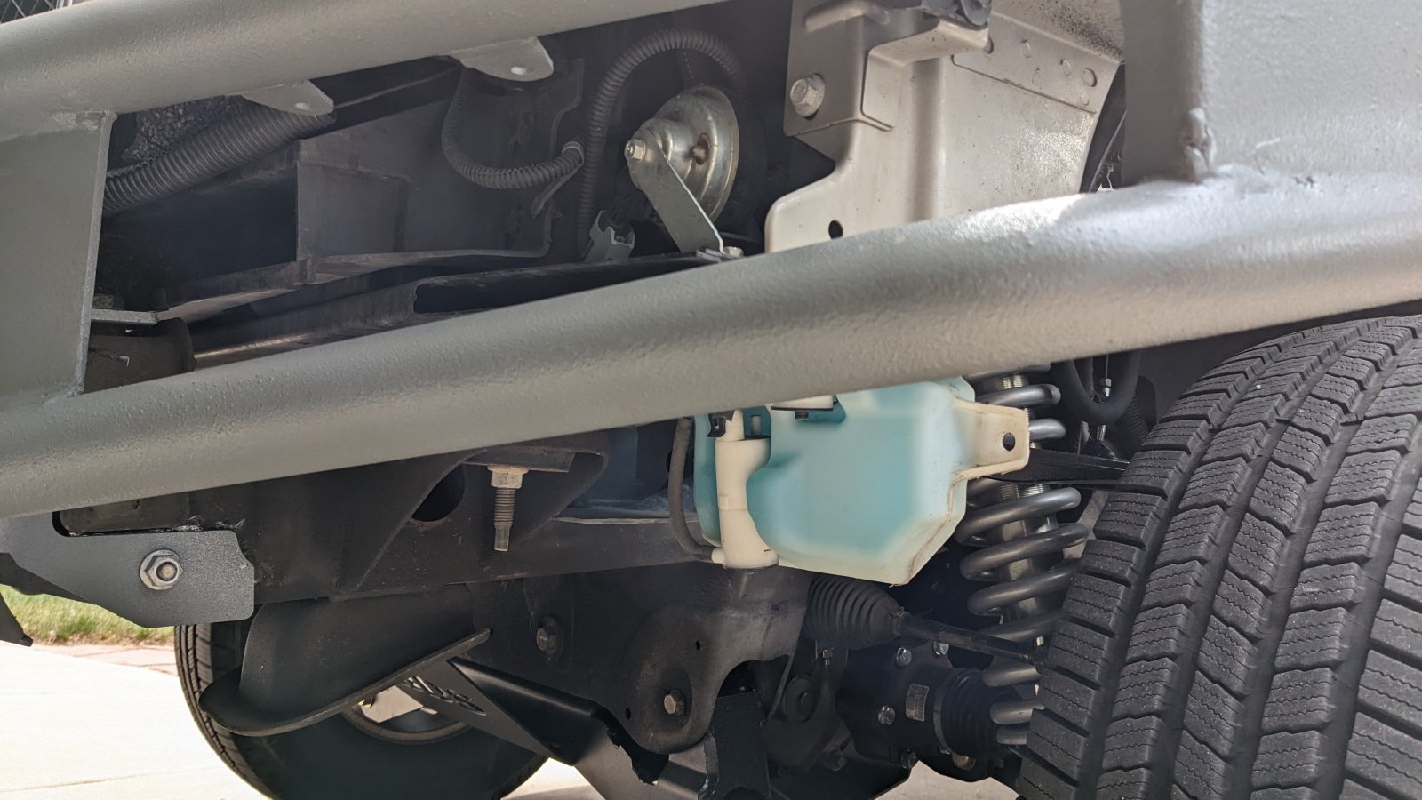

For you guys that have an aftermarket front bumper that exposes the window washer reservoir, what have you done to help protect it?
After I put my front bumper on, I don't like how much it hangs done and is exposed as much as it is.
I was thinking of maybe fabricating something out of sheet metal or plastic to wrap around it as one idea. Another idea is relocating it to a different part of the engine bay but that could be a big deal considering its shape. The third idea is to find a shallower tank maybe.
What ideas do you guys have, or have tried?

Mine is in the stock location and it has never been a problem.
Thanks @Tozan . Good to know. I may do something yet, though.

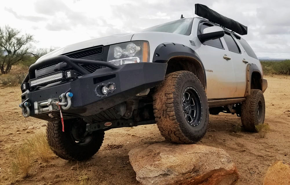

4 inch lift running 35's if you look close you can see my washer tank still in the stock location after thousands of miles off road.
Thanks @Tozan
That's good to know!
Your bumper conceals the wash tank more than mine so I may still do something later if I see it taking abuse.
Hey, what wheels are those you are running?
Also, what didn't you like about the fender flares?

Thanks @Tozan
The flares do not fit very tight and they start flopping around and the door flares are not very secure. One of them fell off when I was off road I was lucky it was on a trail I had to come back on so I found it on the way out. I also had to cut them to fit the bumpers...

I am still considering relocating/replacing my window wash tank. I have seen options for an aluminum wash tank, but the ones I found only have a single pump and no level sensor. I suppose I could modify one to have dual pumps and a sensor, but I would like to see if there are other options. I do want to keep the space open for a second battery.
I like @Swanbird11 idea. Did you ever build that?
Another option I read is where someone used a wash tank from a 96, but did not see any details on that idea.
Any other ideas?
