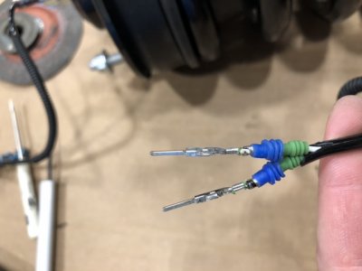

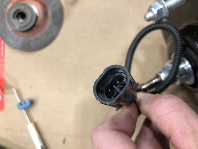

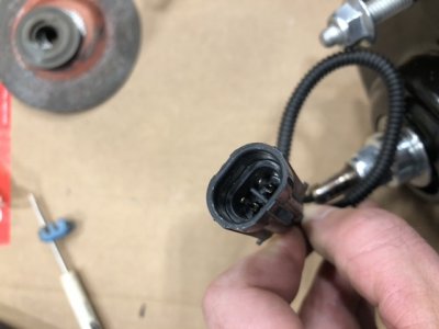

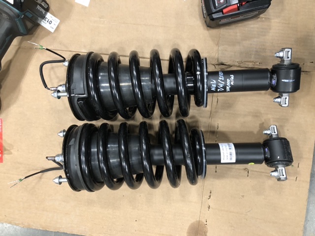

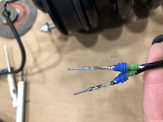

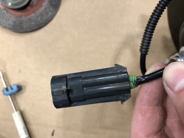

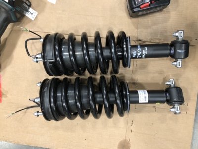

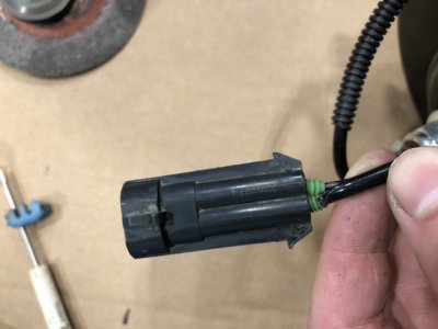

but here are some pics of the shocks put together with my custom HD springs and pigtails pinned into a connector that is compatible with OE GMT 900 strut plug.
7DABEFCC-91DF-4EA1-9F70-075DC8DEC041.jpeg EFB81930-0DAD-491A-BC32-D023ADFFD66B.jpeg 843AE9AF-0741-47BB-846A-97F016E9570B.jpeg 079A7022-3E4A-43B3-9026-D5778B597DE1.jpeg

I had a nice read on your CadiMax(zilla) build. Can't wait to see how the Magneride behaves on your Escalade.
Are you using the components from 07-14 or 15-20 Magneride. I'm looking to see if the later of the two are x compatible and if one is better than the other. All four corners need to be replaced on our 09 Escalade. As usual looking for an upgrade to sneak in a regular maintenance.
