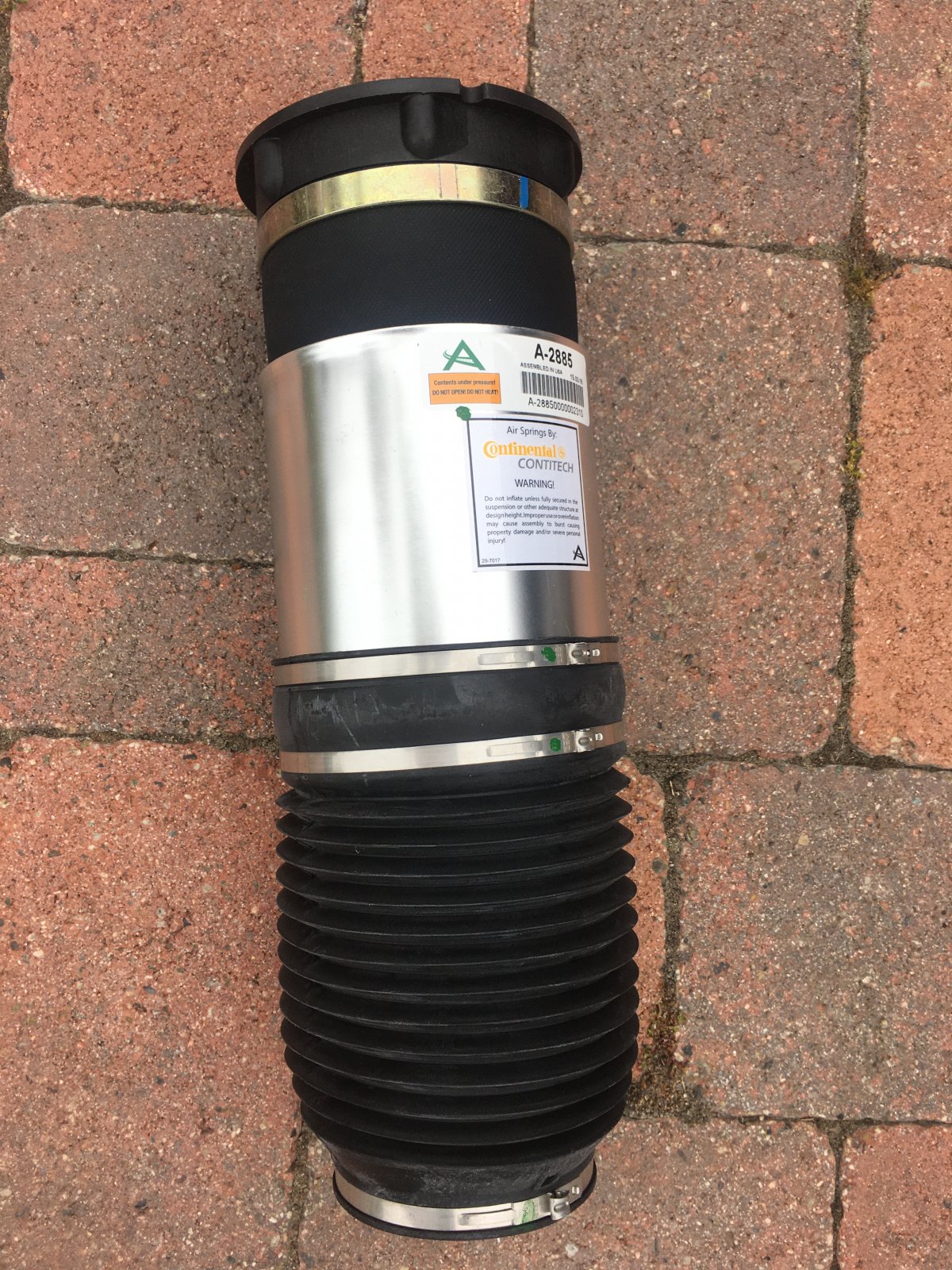

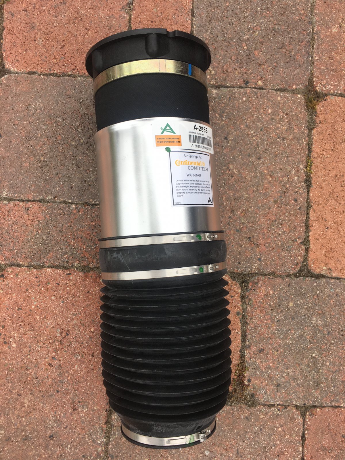

Glad to be corrected by Arnott. The bag below is why I’ve stuck with them. It’s for an 02 allroad 6MT 2.7t front (air strut). They evolved it with an aluminum surround to protect the bag. I’ve been enjoying the lifetime guarantee on them since nice about 09. Apparently they get their Audi bags from Continental.

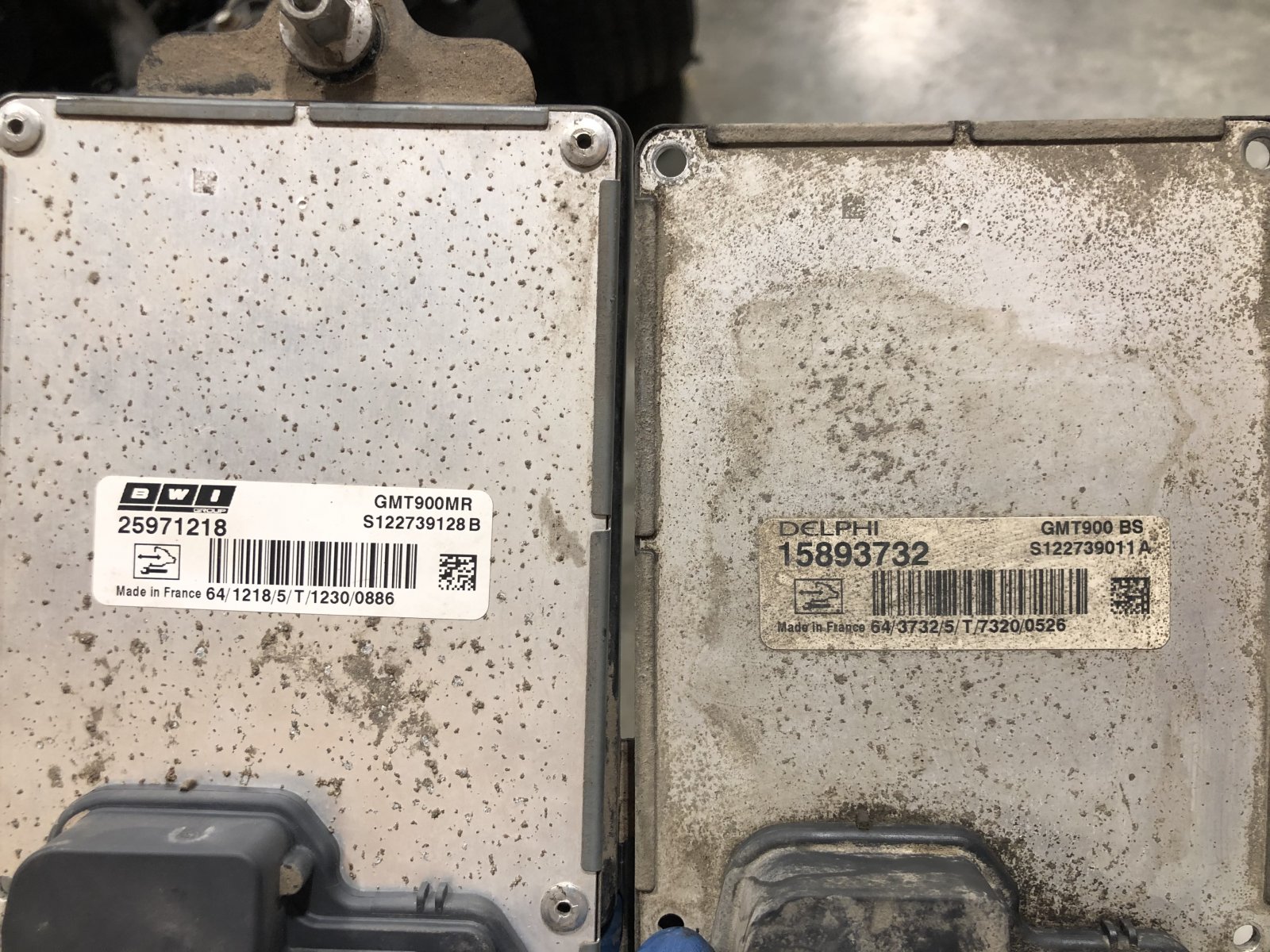

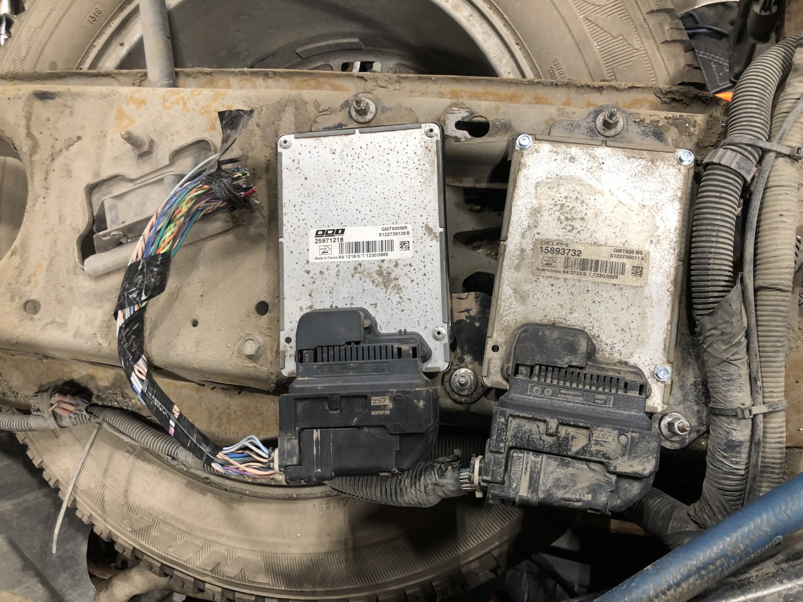

Been a couple years since I’ve been on here and forgot to report on the experiment of trying the newer (2015-2019 K2XX platform z95 front shocks with the pig tail wiring) in the older gmt900 platform (2007-2014). The short answer is they don’t work together. The signal from the older control computer doesn’t actuate the newer dual opposed magnets inside the shock, so even though the computer is happy and doesn’t report any codes, there was ZERO dampening happening…rode like boat on a wavy water front. I was hopeful that I would pick up a stiffer dampening rate with the thicker shaft and dual magnets inside, but ended up wasting a bunch of time, money and being super disappointed in the result, and put a new set of OE Z95s on all 4 corners.
I wish there were a life time warranty on the z95 shocks! I’m replacing mine AGAIN… for the 5th or 6th time, but just the rears this time.
I agree with petethepug’s last quote from Arnott. Very good and accurate description of Z55 vs Z95. I have cut both shocks open and examined the internals. Z55 just has shock oil and regular valving with a solenoid valve in the center that is naturally closed, but can be commanded open to allow an even softer ride.
The Z95 on the other hand has much larger open ports on the internal valve head that allow a special ferrofluid to pass thru. There is also a magnet on the valve head that can be commanded “on” to “thicken up” or increase the viscosity of the ferrofluid making it harder to flow thru the valve ports, so the z95 magneride benefit is a wider, more variable and fine tuned dampening spectrum than the Z55.
I now have a mason jar with GMs ferrofluid in it. My kids love putting a magnet on it to see the wild shapes the fluid takes on under the influence of field. The ferrofluid does settle out over time and takes some work to get mixed back to a homogenous consistency.
Oh, and I also now have both z55 and z95 controllers mounted on the frame near the stock location so I can plug the harness into either computer. The wiring is the same for both, I think they’re just programmed differently.

Good to hear from ya. That’s slick keeping the 55 & 95 controllers back there for ease of running both.
I wonder if the 15+ z95 controller has the same harness connector as the 07-14.

Seems like I checked the possibility of putting a K2xx controller under there as well, but I think the wiring, connector and software architecture is completely different. Even if you did re-pin the harness connector so it would plug in to the most compatible circuits, I’m not sure it would communicate with the bcm, ECM and other modules on the network properly.
Heres a couple pics of the gmt900 platform suspension controllers.

XLNT info and thank you for clearing up the cross compatibility possibilities in the 07-14 z55 / z95 & +15 z95 architecture.
It took me over two years to verify what you found by cutting open the z55 & z95 struts to now, be 100% sure, one was filled with Mag fluid and the other with hydraulic fluid.
