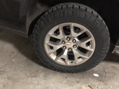

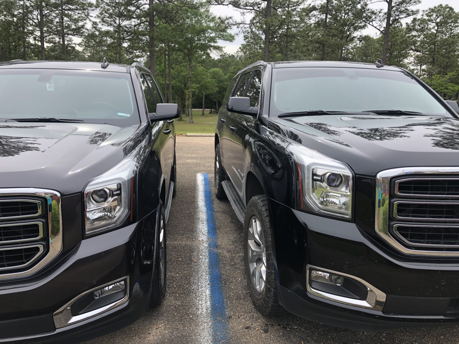

I have 286/60/20 ridge grapplers with 2in level and stock rim
There is slight rub at full turn when I try to make it

Any rubbing, either with normal driving or at full lock? You have to do any trimming?
Only rub at full lock. No trimming done
