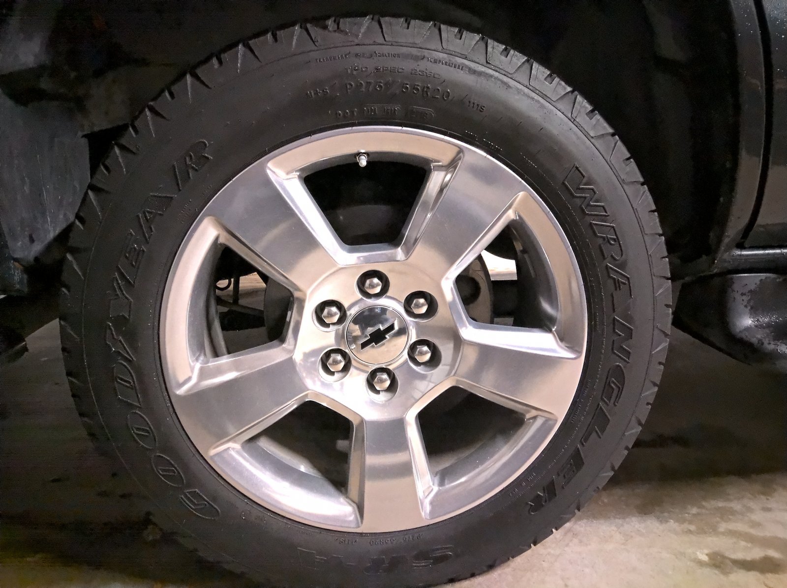

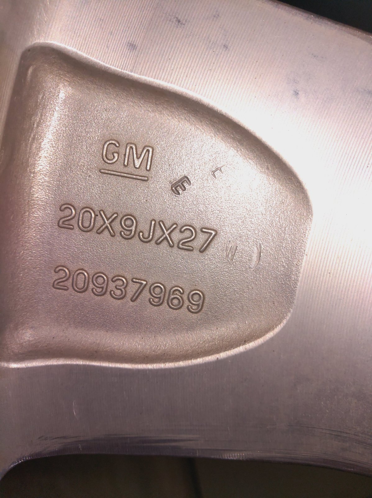

These were off my BIL’s 2018 Silverado. I think the offset is a little less than my 2004 Tahoe OEM 17” were. At full lock in reverse if I go too fast, I get a little rub but other than that are great. Need to see if there’s an appropriate setting in the Tech2 to correct the speedo.

That is a nice set from the 2018!
When I was last poking around in the Tech 2 menus, I saw the option to change the tire size from the 265/70 R16 to the 265/70 R17. I don't recall seeing options that let you pick other sizes on the Tech 2. Seemed like you could change it from the smaller to the larger, but only the two sizes available from the factory. I could be wrong, but I am pretty sure there were only two things to pick from.
