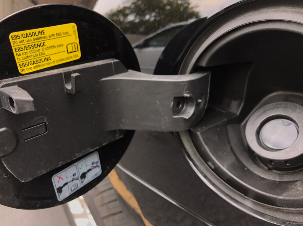

If they were all flex fuel I would think these sites would say that. Nothing I have found says they're all flex fuel since 2015, and even the owner's manual doesn't state it's flex fuel. It says it will have a yellow sticker on the fuel door (mine does not). Posting a press release of a flex fuel motor doesn't "settle it" in my opinion. It just means that specific Tahoe listed was flex fuel.
I clicked on the link posted and clicked the input my VIN, it just wanted to sell me tahoes.

Nothing on the tailgate or gas cap to indicate Flex Fuel??
coder
Aug 7, 2017
55
43
NOTHING. black gas cap, no emblem on tailgate
Same here. Nothing on gas cap and no emblem on my 2017. And from owner's manual "Vehicles marked as “E85” or FlexFuel can use either unleaded gasoline or ethanol fuel containing up to 85% ethanol (E85). All other vehicles should use only the unleaded gasoline as described in Fuel".
And the 5.3L v8 ecotec3 engine specs (http://gmauthority.com/blog/gm/gm-engines/l83/) do mention "regular unleaded or E85".
Very confusing.
