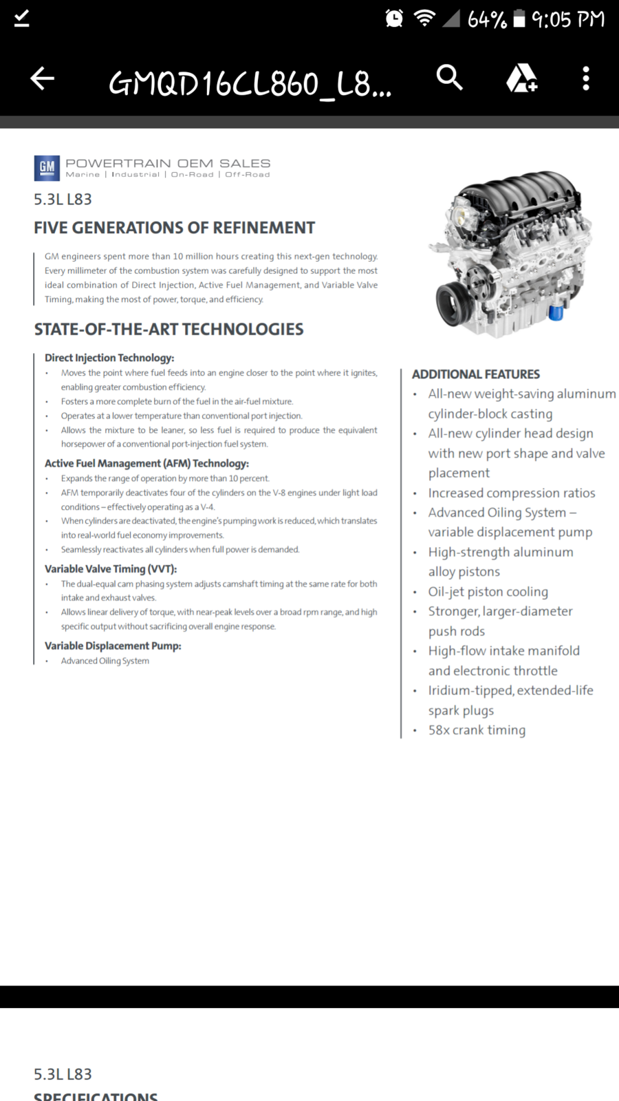

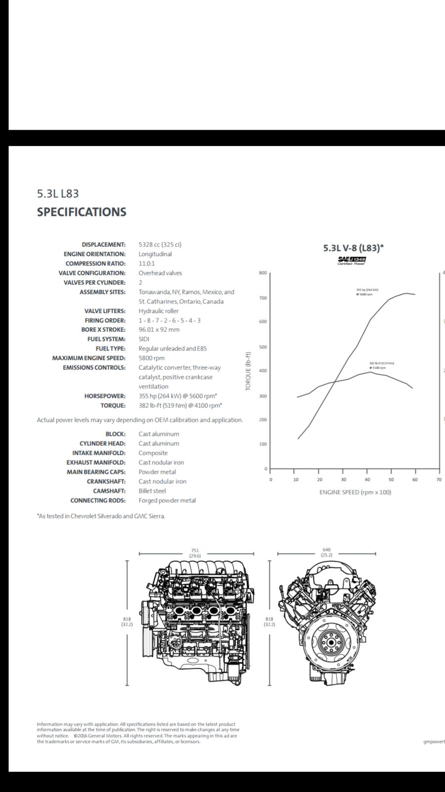

Same here. Nothing on gas cap and no emblem on my 2017. And from owner's manual "Vehicles marked as “E85” or FlexFuel can use either unleaded gasoline or ethanol fuel containing up to 85% ethanol (E85). All other vehicles should use only the unleaded gasoline as described in Fuel".
And the 5.3L v8 ecotec3 engine specs (http://gmauthority.com/blog/gm/gm-engines/l83/) do mention "regular unleaded or E85".
Very confusing.

So do you have the 6.2 L86? The 5.3 L83 is a Flex Fuel engine and has been since its introduction in 2014. If it were to lose the Flex Fuel capability, GM would assign a new name to the engine just as they did with the Gen IV engines when they got Flex Fuel.
Which RPO codes do you have?
