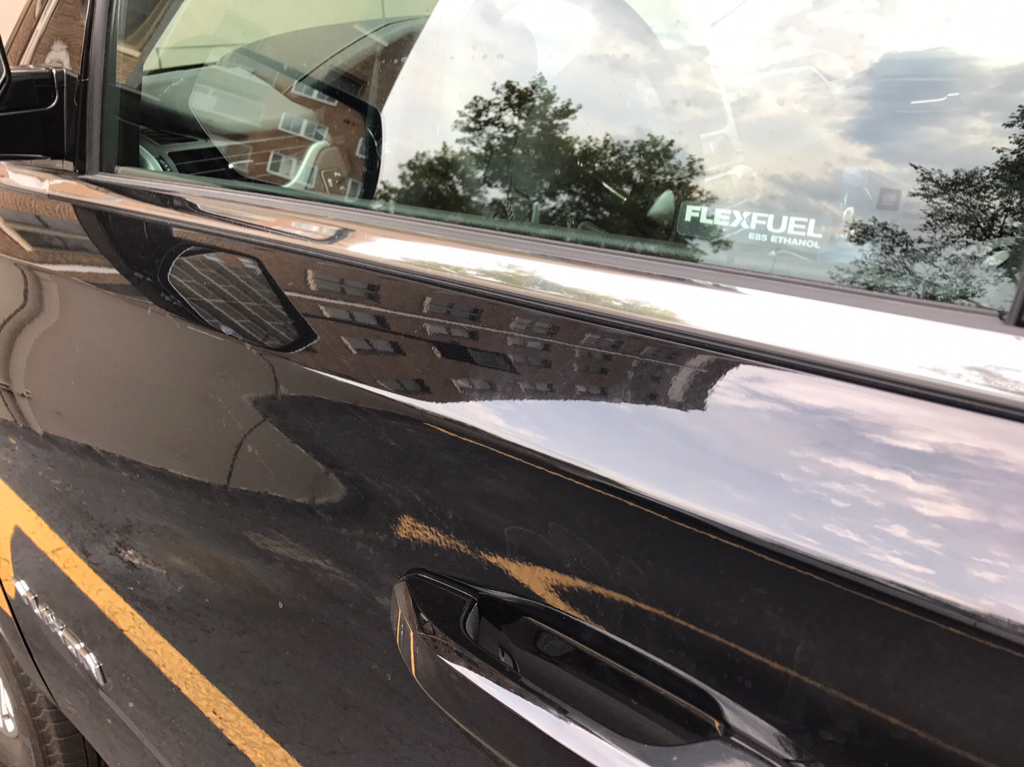

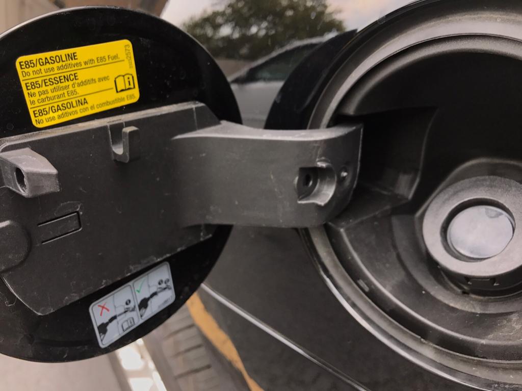

My 2017 rental Yukon SLT is flex fuel and it's clearly marked in two places.
