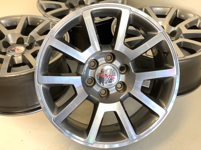

Tried googling around to see if I could get the model # of those GM rims and all I could find were images. Seems the most consistent model number is GM 5699 20" wheels.
But I believe this eBay listing there is for the same rims @Page1 is running with the GM Brembo brakes:
I realize they're the GM Brembo and not Wilwoods, but the overall caliper shape/design is similar. I'm fairly confident if this 20" wheel would work with the GM Brembo brakes they'd work with the Wilwoods as well. You'll want to stay more towards the 20" wheels with flat spoke faces, no concave. See how on this particular wheel the spokes don't angle towards the hub, they're flat to the entire face of the wheel. Then the center cap is recessed and the lug holes are deeper due to the spokes being flat faced. Hope my description is making sense here? That's what you're looking for in a 20" wheel to fit over the Wilwood 16" Front BBK.

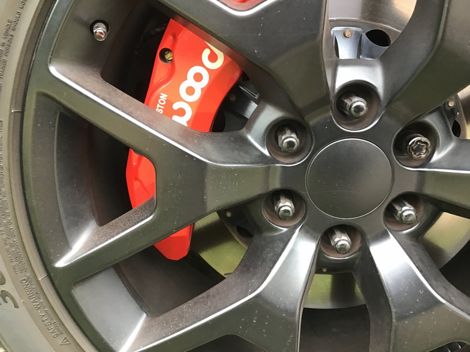

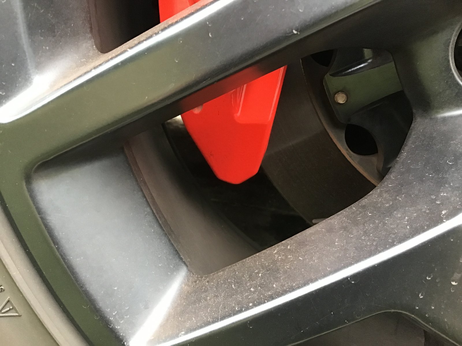

Wilwoods come with new stainless brake hoses too, at least the kit I bought came with them. I’m running 22” reps and they clear but that’s no help to @Slow5.0 so I took a pic to show you how much room they have. They come within just about exactly 1” from the top and bottom of the caliper to the wheel so it would be real close depending on the wheel imo. I think they offer a template on their website iirc.
Excuse the dirt, it rained today.

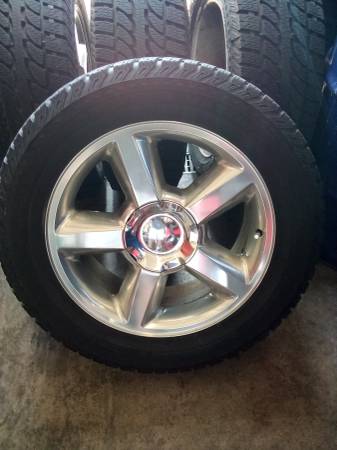

I found these 20" from 07-14 Tahoe cheep. Like i said i need these wheels just for winter. Ill be installing Bridgestone Blizzaks on these 20"
