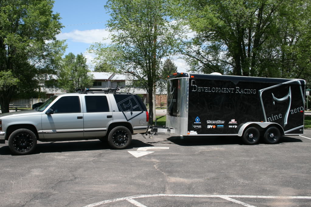

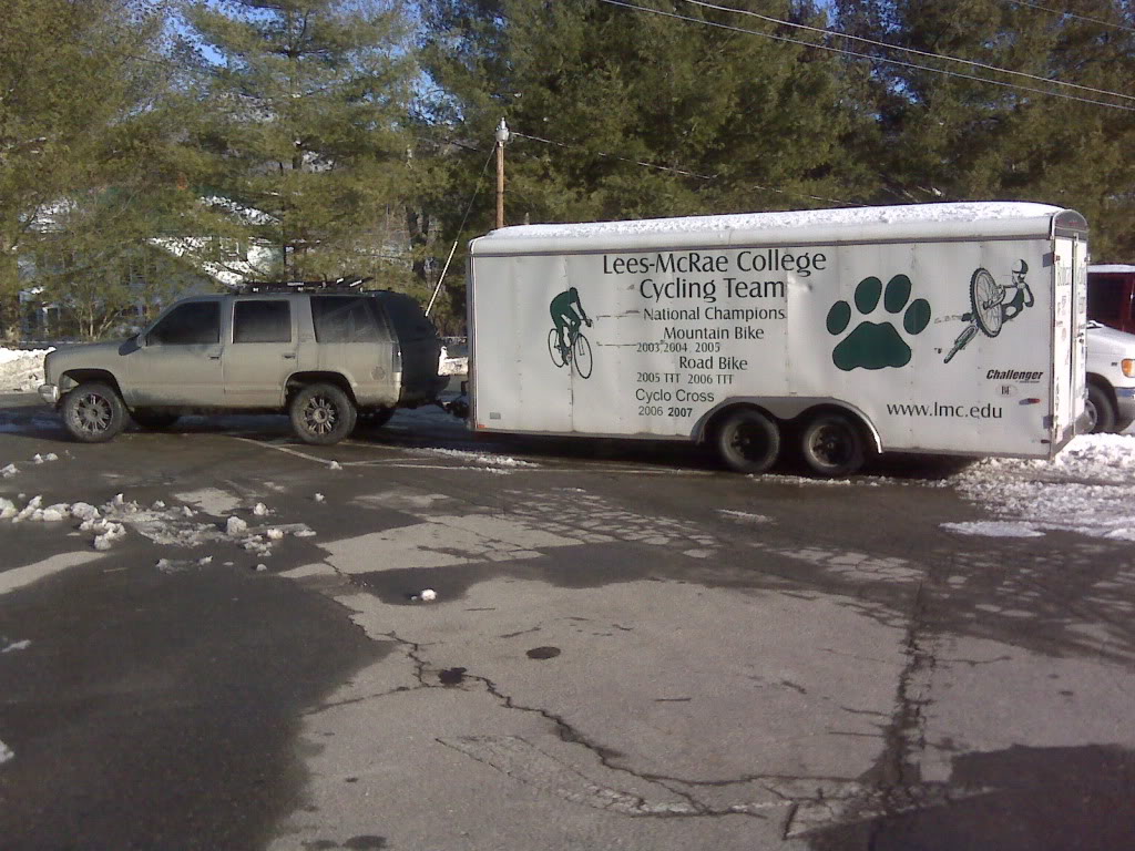

I put 5,000lb firestone load leveler bags and a proportional brake controller that will apply brakes when it senses that the vehicle is slowing down, or on grades...(saves me in the mountains)
Plus I have a sway bar hitch for the black trailer
8X20 with 34 bicycles and gear in it
7X16 with 20 bicycles in it, dirt bike, and easy up tents
YOU WILL Definitely need load bags with that much weight, you put 200 pounds on that soccer mom suspension that the tahoes come with and you will be on the bump stops.
Kits, run about $250...I got mine from suspensionconnection.com
---------- Post added at 11:36 PM ---------- Previous post was at 11:35 PM ----------
If you look closely at the tongue of my black trailer you can see the bars running underneath it and chained to the flip up hooks....so much easier in wind and turning, the white trailer does not have them and when it starts to get windy it gets interesting quick

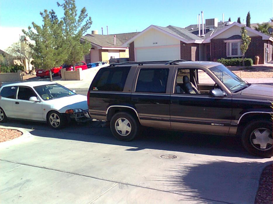

well you all seem to have large loads....does towing a can of rice count??? lol :laughing1:
