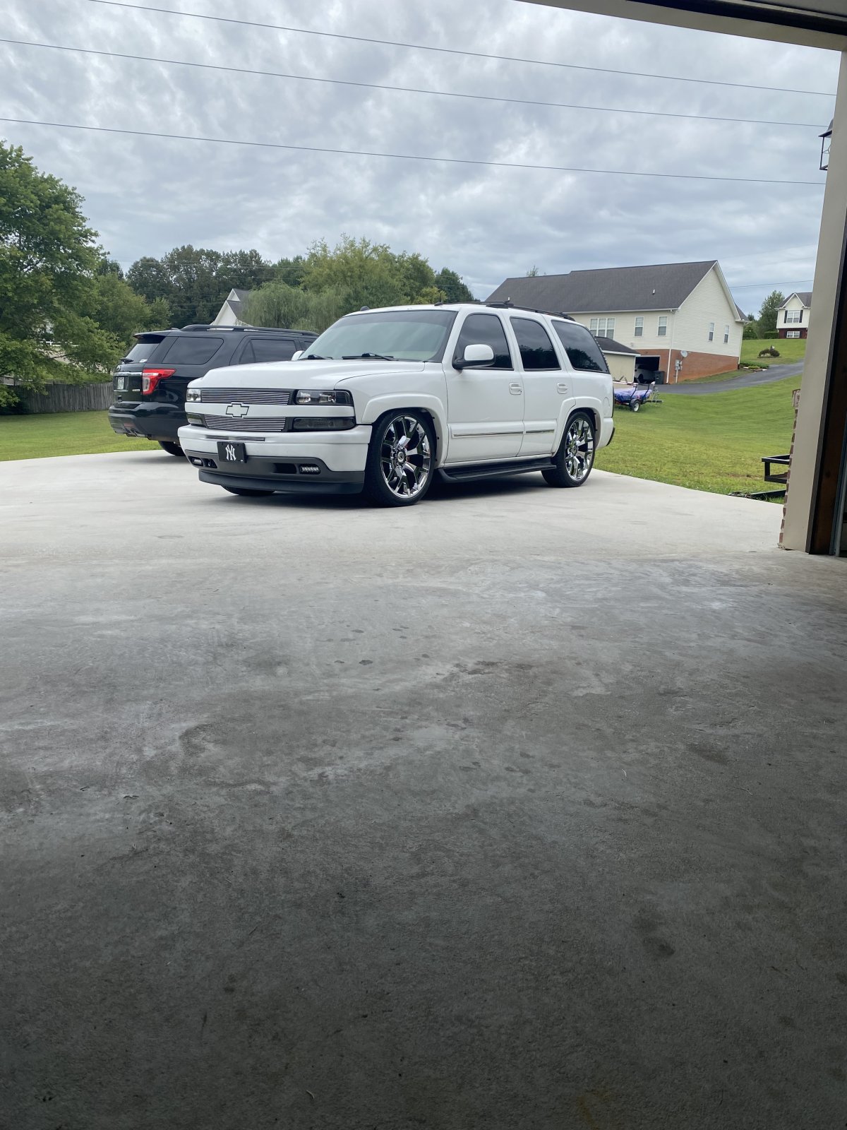

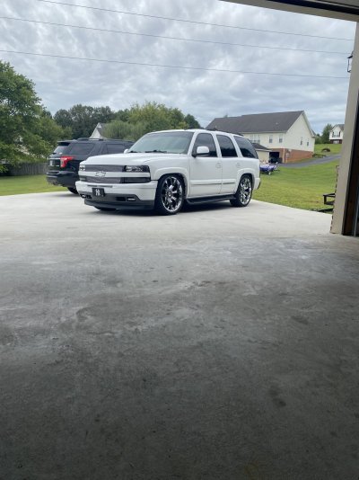

Currently have a 4in crown drop spring, which rides ok but want to go a little lower. Already have the lower arm kit, sway bar kit, shock relocation and free travel. From what I could search I see mixed opinions about 5in Tahoe springs, and using TrailBlazer springs.
