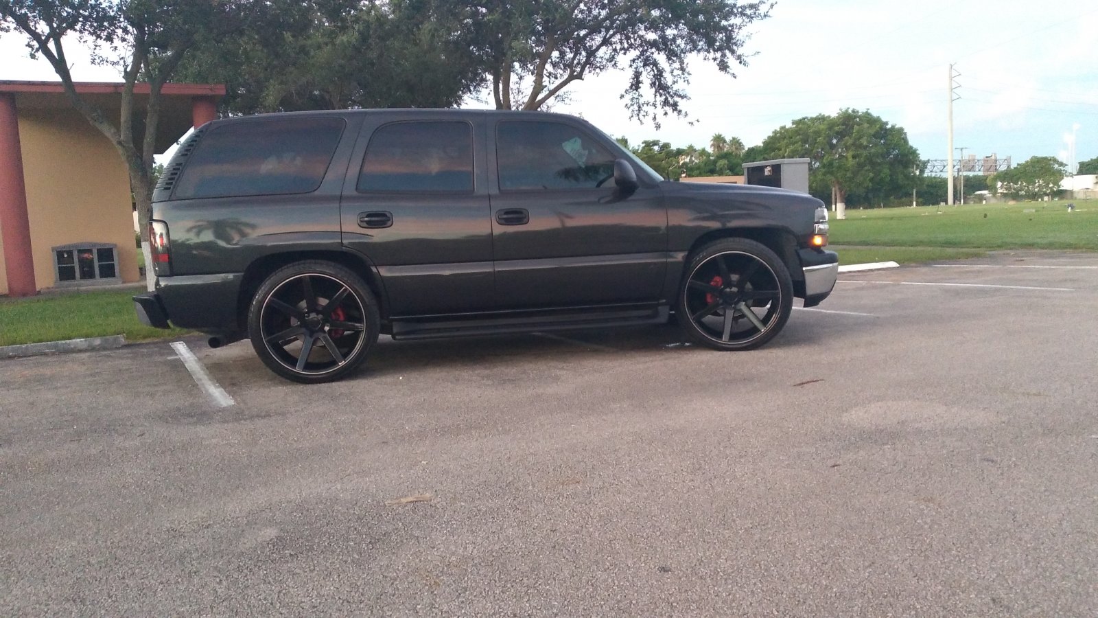

I have Belltech drop spindles, belltech shocks, belltech sway bars, Spohn pan hard bar, Spohn lower boxed rear control arms, Djm rear lower control arm relocation brackets , Djm rear sway bar links, 22" wheels, it's a 3" x 5" drop. relocated the rear bump stops ( free travel ) ....Truthfully I hate the ride and the front end keeps loosening up I had everything tightened up at an alignment shop and now it's making the same noises ( clunking ) when I turn the wheel as before.The alignment shop said all front end parts are good . Is there a better way to go ? coilovers ? air ride ? I just want it to be super tight I know the 22's won't ever be Great but I'm putting some Michilin Pilots or Toyo tires soon maybe a bit bigger

I did get the shorter sway bar links nothing is hitting there. I have Belltech 5"rear coils I'm not so frustrated with the ride as I am with the noises coming from it, seems like the front and rear like poping or clunking when I turn or start out of my driveway. and the steering feels really light, not what I expected with the dampner and the 22" wheels. I do have every new part for the front end all ACDelco professional and I mean every part which will be installed in 2 weeks, the car itself only has 120k original mile but I don't know if anything is new except I replaced the steering column parts. I have Bilsteins in my BMW 740i their pretty stiff. I jacked the front end up today and everything looks tight no bad seals anywhere fresh lube on all the fittings. The jounce stops look ok but not new I will get some for the front end overhaul..........Thanks. !!
