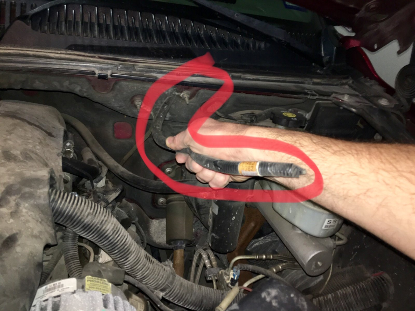

Where does this ground wire go to?
Z71Craig13
Jan 21, 2018
2003 Tahoe 5.3L z71. Found this ground wire disconnected and can’t figure out where it goes. Any help or photo greatly appreciated. Thanks

Is it needed? I don’t know what its purpose is.
It's the ground for the underhood light. If it's hanging loose, then I would assume that your underhood light is broken or else there is no light on the underside of your hood. Another possibility is if the hood was painted at some point and the body shop never reconnected the ground to the hood.
But to answer your question better about "Is it needed?" No, it's not necessary if you are not worried about the underhood light working. The truck will run just fine with it unhooked.

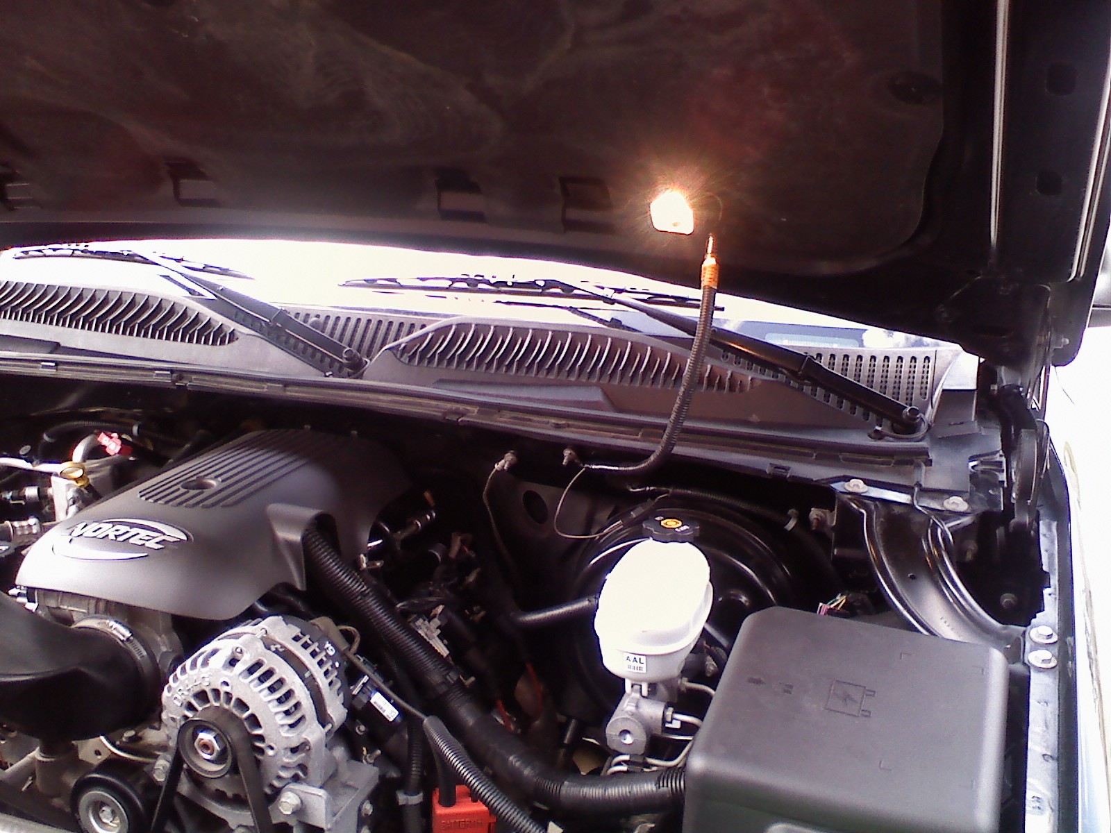

This is the underhood light that I am referring to. There should be a hot and a ground connected to it and it has a built in switch that turns it on when it tilts up.
My 03 has that ground strap, but it didn't come with the underhood light. GM stopped that starting with 03.
rockola1971
Dec 29, 2016
2,862
4,084
Indiana (formerly IL)
Yup, neither of my 2003 tahoes have it nor my 05 Denali.
But I would reattach it. What can happen is the hood doesnt get to ground potential because of corroded hinge connection (electrical) and what will happen is you will get some small current flow toward the hood and you can get arcing (very tiny) at the hinge mounting bolts or anywhere the hood has paint missing or thin where the hood is up against exposed metal (thin or missing paint on fenders). It will burn spots over long periods of time. The spots will start to look like pinholes.
