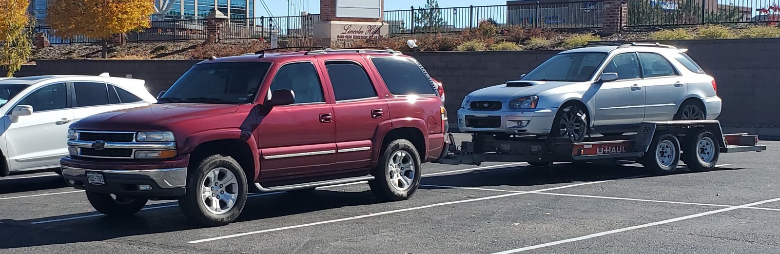

If they're the 18x8.5" wheels then, yes. I run 2015 Silverado wheels on my '04, with 265/65-18s, with no rubbing on a stock suspension.
The 8.5" wheels have a slightly different offset than the 16" OE wheels, and that compensates for the wider profile.

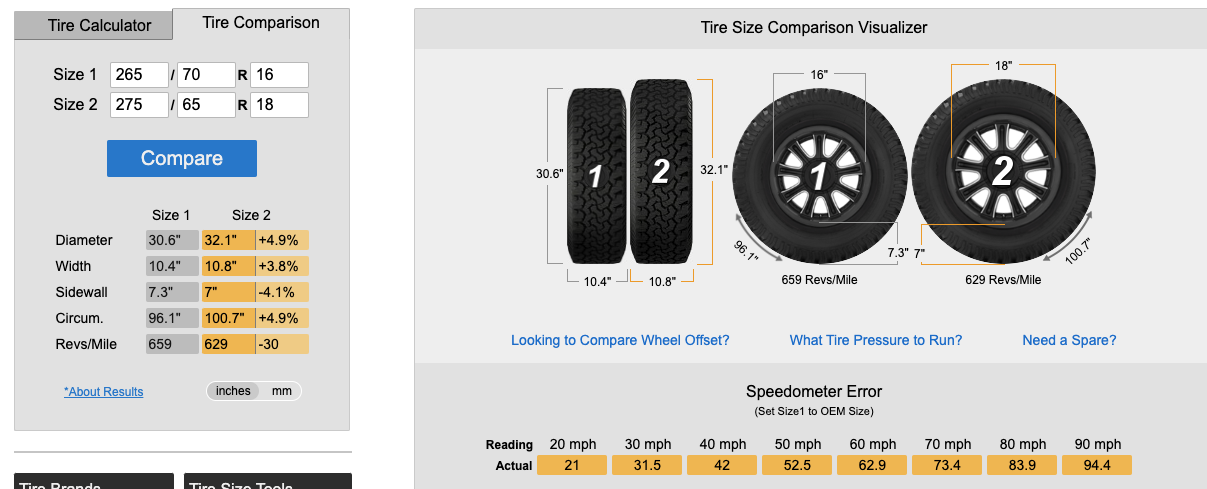

Keep in mind your speedometer is going to be off:
Looking to see if anyone may have an answer to this question. I have a 2005 Chevy Tahoe with stock 16’s and 265/70R16 tires. I also have a 2018 Chevy Silverado 1500 with 18’s running 275/65R18 tires and I wanted to know if I could swap these into my 2005 Tahoe? I can swap rubber if need be but primarily interested in if the 18’s would fit the Tahoe.
Keep in mind this is going to throw your speedometer off, and potentially your acceleration as well.
Which is why I run the 265 width tire; its reduces the error slightly. Mine went from reading about 1.5mph high at 60mph to around 1mph low. So when my speedo reads 60 I know I'm in the 61+ mph range. You can verify with a good GPS unit.
