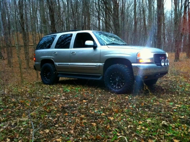

you'll need a leveling kit but they'll fit fine other than that
---------- Post added at 08:06 AM ---------- Previous post was at 08:04 AM ----------
btw, my wheels are the same size/-12offset you're looking at
