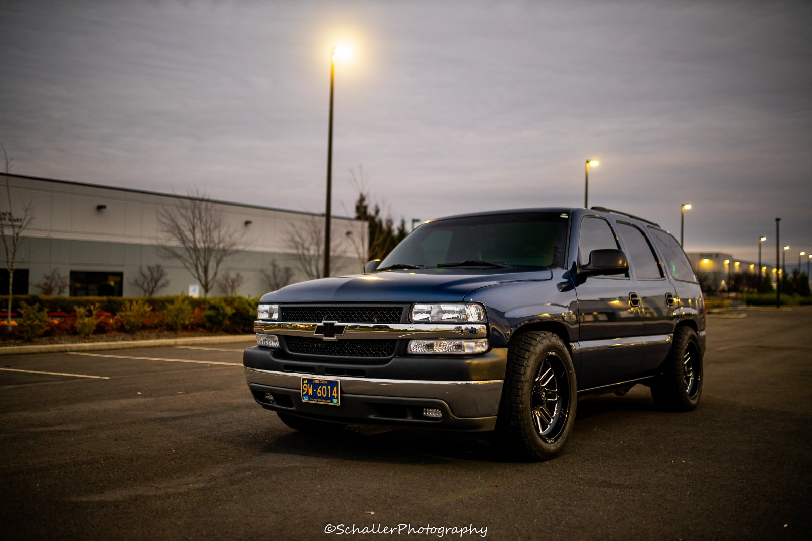

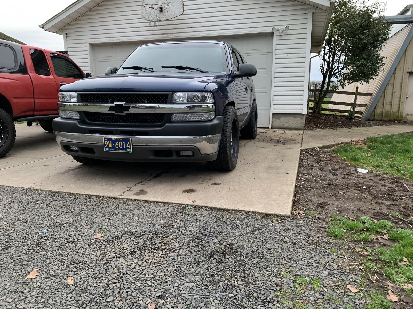

I used to be leveled on 20x12s -44 offset & 33’s. Did a NorCal inner fender mod to clear and cut the front bumper.
when I decided to lower mine I went to 20x10’s -19 offset and 285/50’s which look to be about a inch Less height than what you would have with the 285/45’s. I’m lowered 3/4 and sometimes rub firewall now. If you were gonna be leveled by lowering the rear and that’s it I think you should be able to clear 20x10’s pretty easily maybe light trimming of the inner fender. 20x12’s will probably be some heavier cutting.

when I decided to lower mine I went to 20x10’s -19 offset and 285/50’s which look to be about a inch Less height than what you would have with the 285/45’s. I’m lowered 3/4 and sometimes rub firewall now. If you were gonna be leveled by lowering the rear and that’s it I think you should be able to clear 20x10’s pretty easily maybe light trimming of the inner fender. 20x12’s will probably be some heavier cutting. View attachment 237678View attachment 237679
It does have a good look to it.
