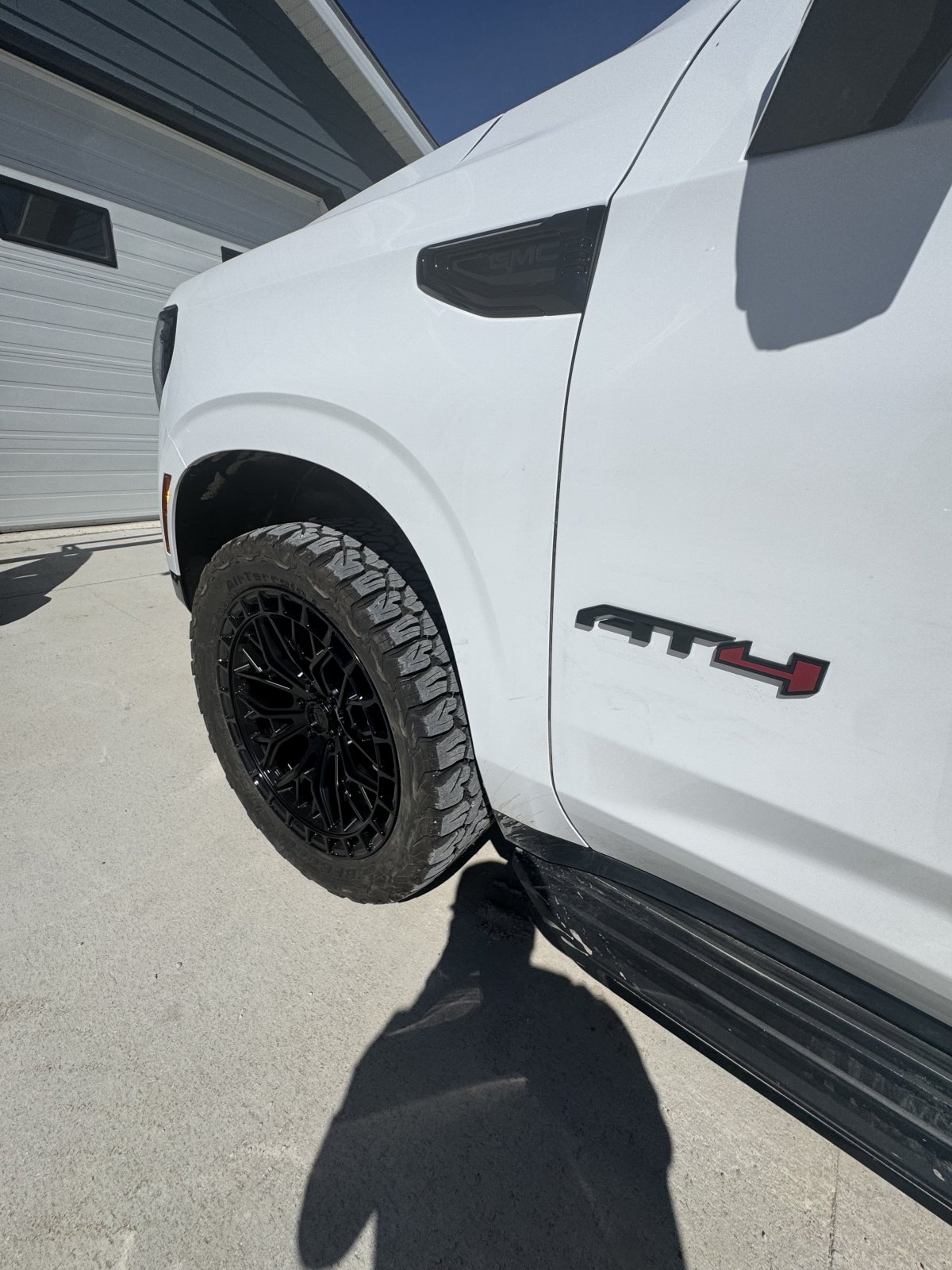

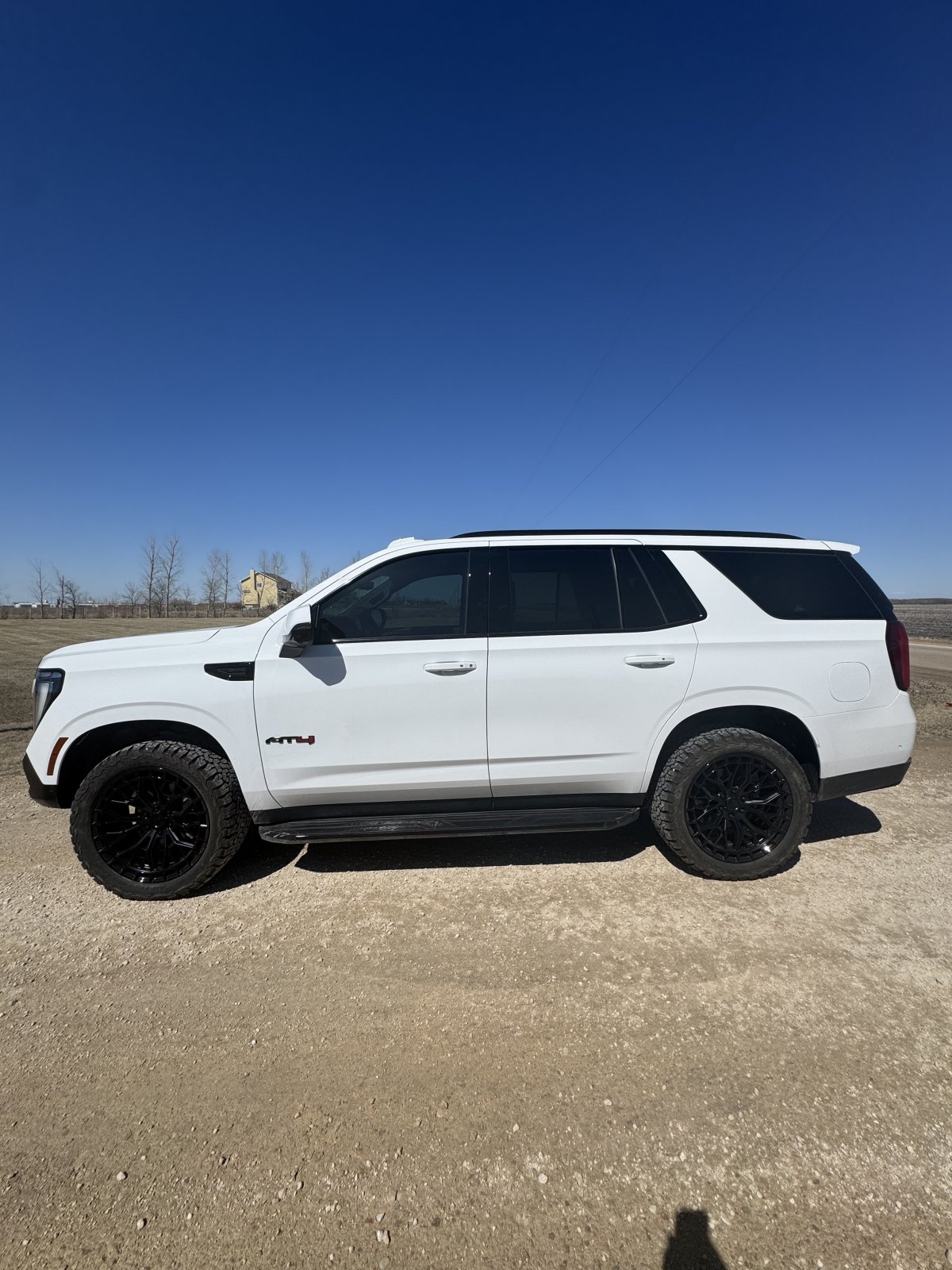

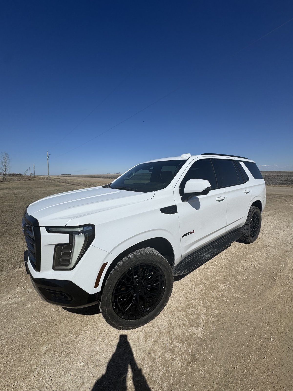

First post, I came here looking for info on some rim/tire setups so thought I would share mine, hope it helps others make a decision. Truck is:
2025 Yukon AT4 6.2
GM black emblem kit
30% front tint
22”x9.5” +18 Fuel Sigma
33x12.5x22 BFG KO2’s
I have zero rubbing, it does have the air suspension but can run it on normal ride height with no issues. They’re tight against the upper control arms but they do fit with no issues.

Lookin good.
I always wkndered if those would fit on the oem wheels…how much room to the knuckle?

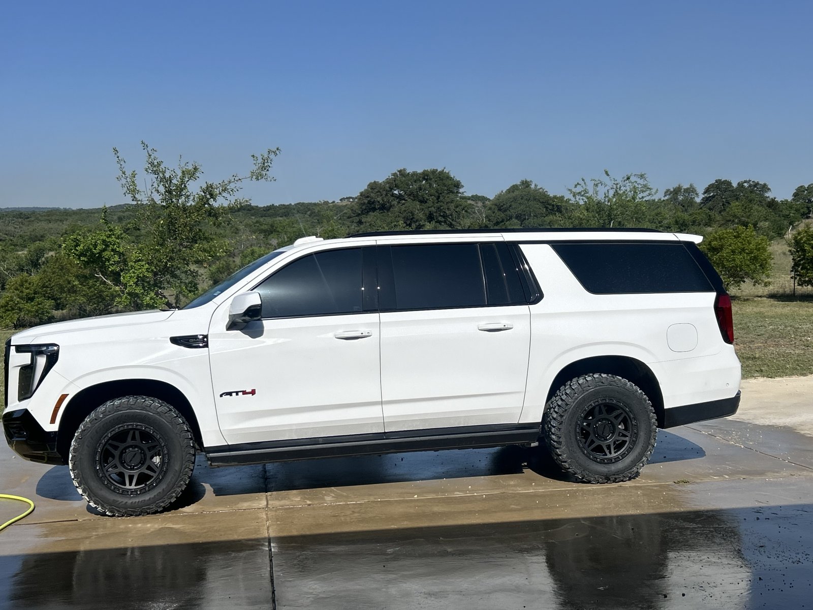

I had a crazy tough time getting this right. The brake calipers in the front mean only certain after market wheel spoke patterns with fit.

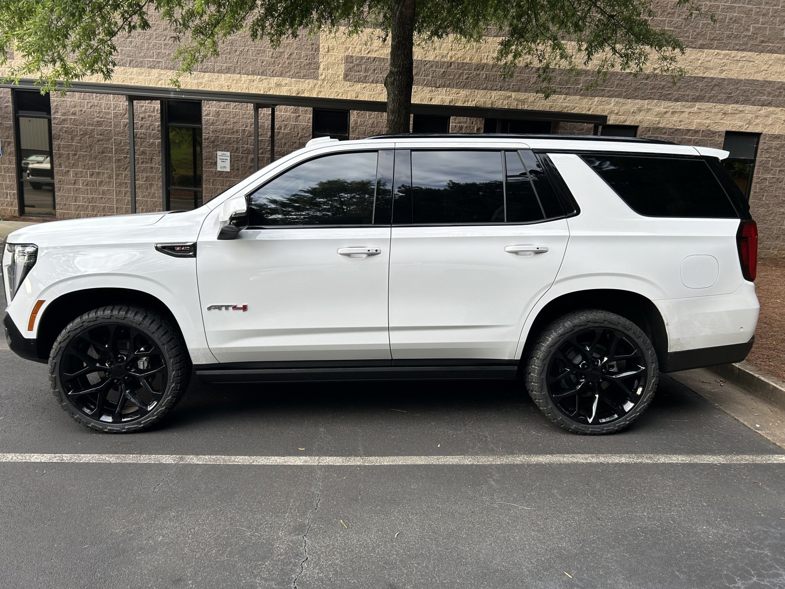

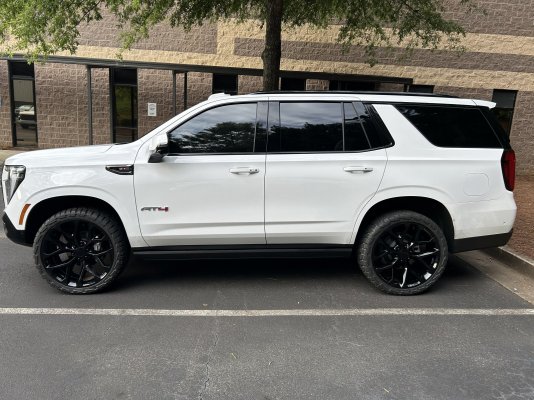

I went with 305/35R24. Had to add a 12mm spacer due to the brake calipers in the front but they fit great, no scrub. Went with the snowflakes...
