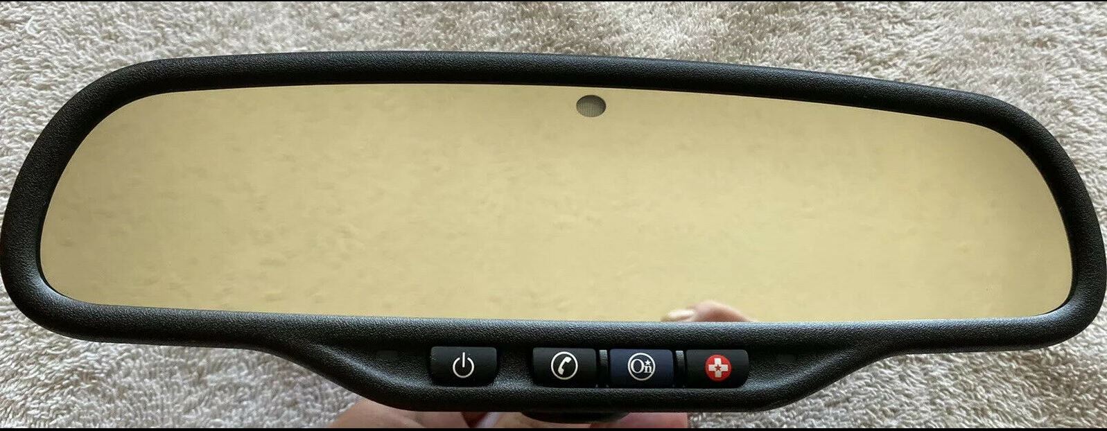

I am guessing since it is a 2001 that it would be for heated mirror option unless you have a sensor in your rearview mirror for the autodim, it will be a small circle about the size of a hole that ringed paper would have like one of these
View attachment 261898 View attachment 261899
These mirror you referenced weren’t an option til 2003. Lol
