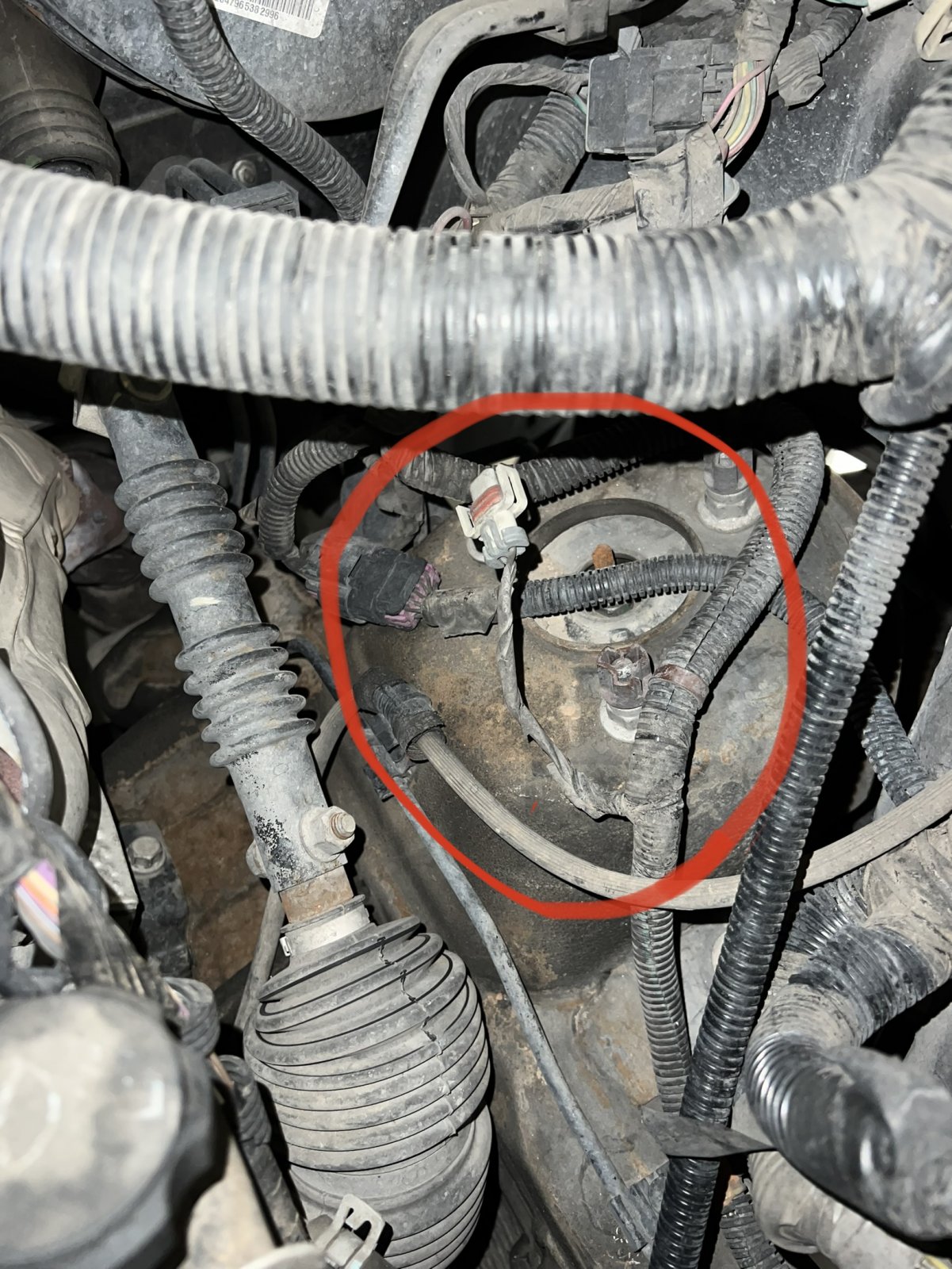

whats this loose wiring adapter in the engine bay?
Spencer DPH
Feb 5, 2023
hey all,
so was in an accident a few months back and i just recently noticed this loose adapter wire post repairs. surely this can't be. normal. anyone know what this is and where it attaches? it's on there drive side of the engine and wire seems to be coming from the radiator.
2013 gmc yukon denali 6.2

That plugs into what was supposed to be a sensor for the top of your front strut. You probably had some sort of Magneride or Autoride on it. Was the suspension ever swapped out at some point during the repairs from the accident?

yes probably have a service suspension message 24/7 too since there is no resistor on there
