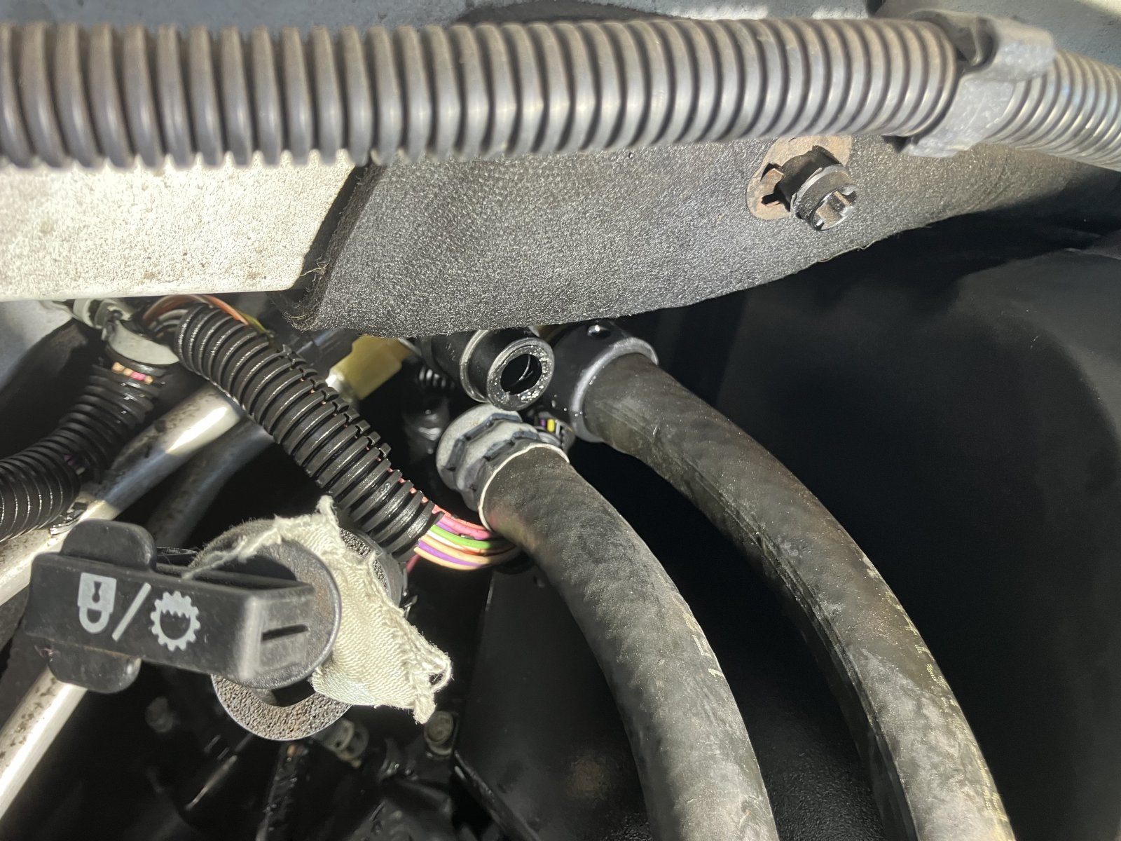

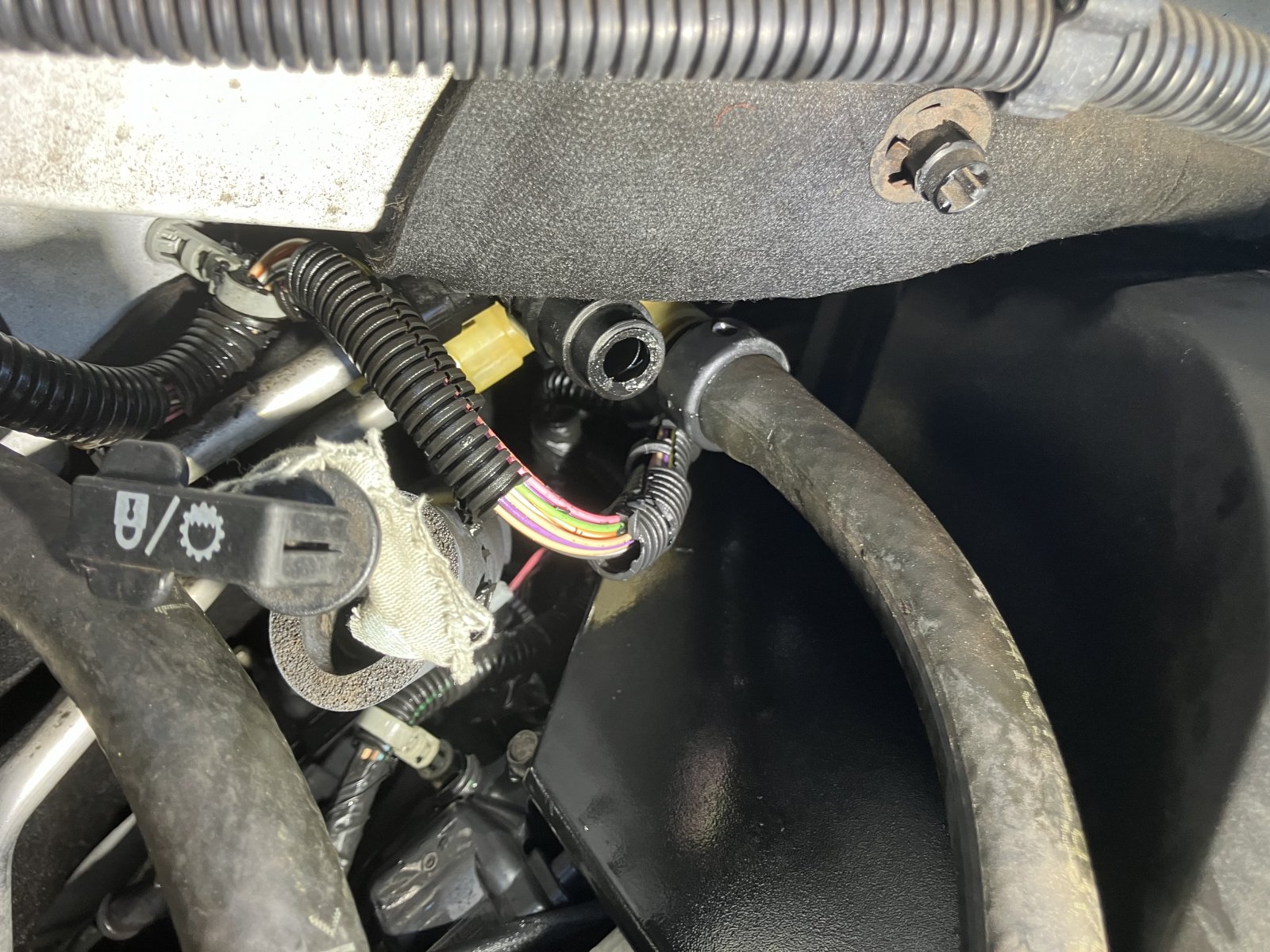

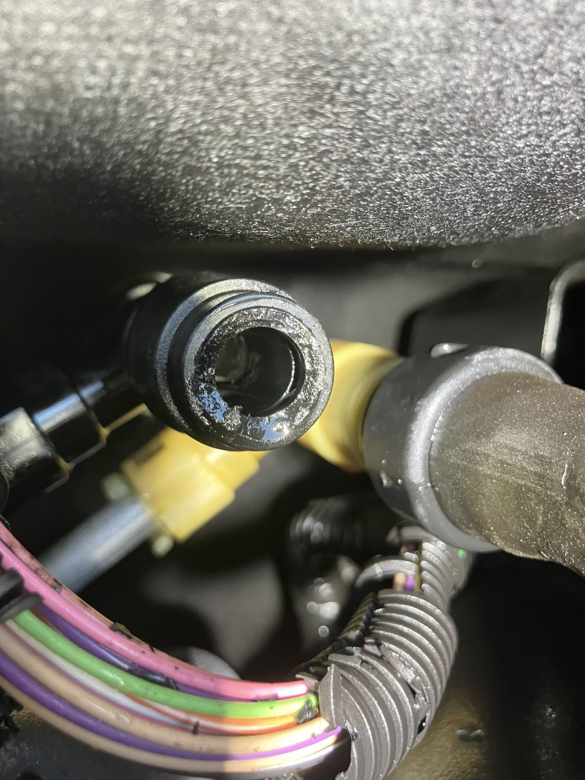

The plastic heater hose, where it goes into the firewall, may have a small crack. The engine RPM goes up and the water/coolant pressure goes up. A small leak, over time, becomes a major break. Hope this helps.

Oh yea, had that happen before. That made quite a smelly smell. Just don’t keep driving it till all the coolants gone.
