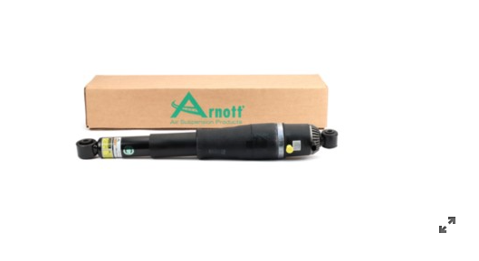

My rear air suspension is dead and the bags on my shocks are blown. I'm figuring I'll need at least shocks, and probable a compressor too. Looking at the various Arnott shock options around leaves me with a few questions - mainly what is the difference between the Arnott AS2715, AS2700, and AS3430? I'm not sure what I'm getting or not getting between these three. On the NapaOnline.com site, they all say the following:
  • Important Information: Includes Solenoids To Bypass Electronic Ride;w/o MagneRide Suspension;w/ Autoride Suspension
The 2715 is $175 and the others are almost $100 more
AS2715:
AS2700:
AS3430:
Thanks in advance

AS-2708 is a rebuild of a factory shock, and will retain the Z55 suspension completely.
AS-2715 is a new shock, that will put in a resistor to make the computer think the Z55 suspension is working, when it is no longer present. Still is air ride.
AS-3430 is the same as the AS-2715 is performance. Fools the Z55 suspension. Still is air ride. Not sure what the difference inbetween the 2715 and the 3430 is.

If they are all three air suspension, what is the resistor for? I'm not sure what is being bypassed...

The Z55 is an electronic adjustable suspension on all 4 shocks/struts and also air leveled in the rear. The resistors are to spoof the computer into thinking the shock is still electronic when it isn't so it doesn't throw a light on the dash.
The AS-2708 doesn't come with a plug in resistor because it's still electronic adjustable and the factory wiring connector plugs into it.

Learn something new everyday, I guess.... I thought what was adjusted was the ride height in the rear for load leveling. Is something other than that being adjusted?

The Z55 suspension has two separate components - air in the rear, and electric on all 4 shocks. The air is used for auto-leveling of the truck. The electric is used for automatically adjusting the stiffness of each shock as a stabilizing action, while the truck is in motion, and it comes into play mostly when cornering or other times when the center of gravity of the truck shifts while in motion.
I finally found the difference - the AS-2715 has an external resistor and the AS-3430 has that resistor internal. I ended up ordering the AS-2715 from Rock Auto since they were cheaper there and I used the forum sponsor discount code to make it a bit cheaper even still

FWIW I had an issue with one of my resistors and they sent me another which I was able to swap over onto the shock. If they were internal I’m guessing they would have to replace the entire shock.

I chose the AS-2715 because they were around $40 cheaper than the internally bypassed AS-3430, but your experience makes me think I made the right choice even outside of price.
