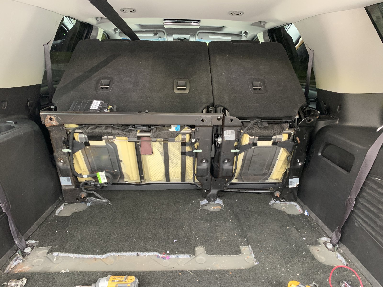

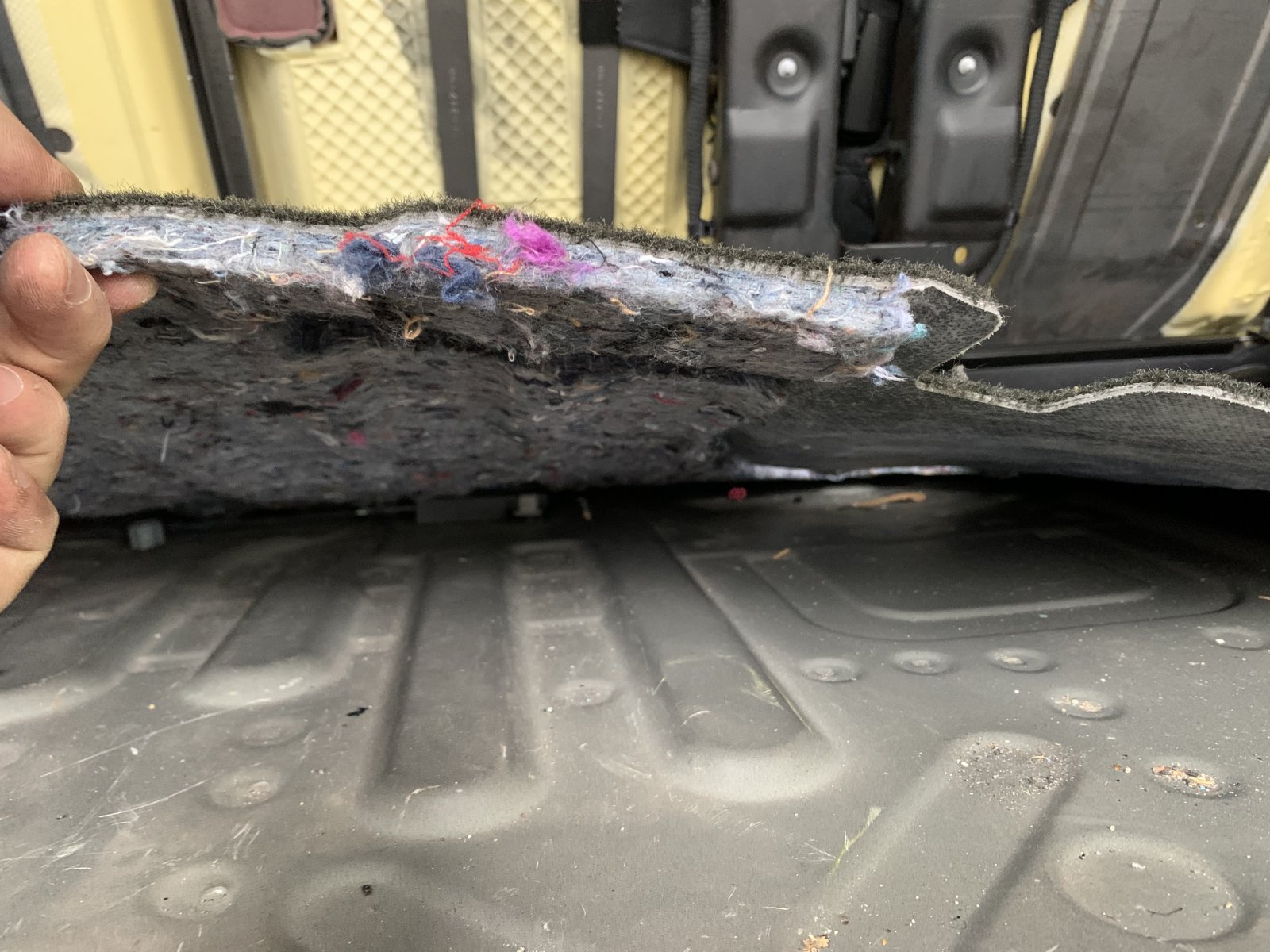

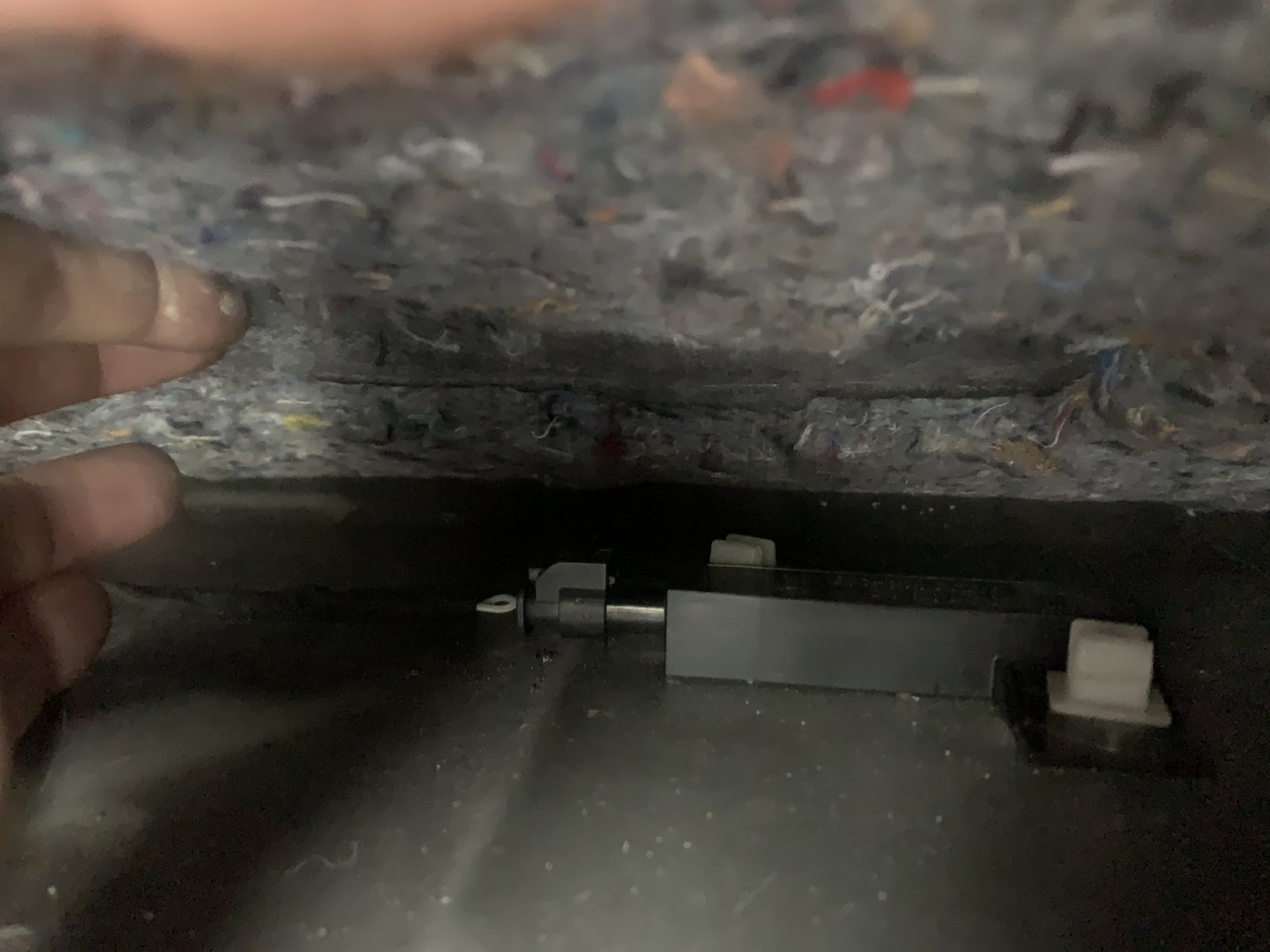

I had the same issue, here is the plug and the sensor under rear seat.
F79A43B3-D4BF-4892-95DC-B1E417A12873.jpeg 486D0217-AFC1-40CF-9184-B48BC06A1257.jpeg 9C52C612-70ED-4B37-AEC7-6A38D3C588BB.jpeg

I was told by my local GMC dealer (so maybe incorrect) that there is a passive entry receiver near each entry point to the vehicle. At least on the front and middle seats the receiver is mounted underneath each seat. It's possible that your rear receiver is mounted under the rear seat.

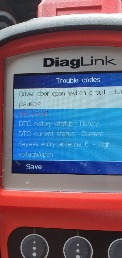

Hello, I had the same problem, suddenly the “Service Keyless system” appears at the dashboard, I get the code b3134-05 but I can't find the antena no 5 until I saw your photos. I access it from the 2nd row without remove the 3rd row, it's under the mat, it was bad connected, I reconnected it and now everything works fine. thanks a lot.
