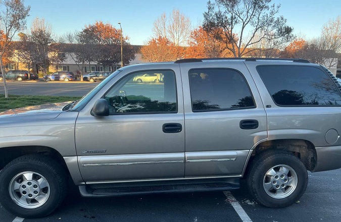

(1) 2000 Chevrolet Tahoe LS 4x4
"8 people seat (with removable 3rd-row seats). The body is in good condition. Runs good and has Low mileage 134k. Excellent tires. The tags and smog are up to date. I have the smog certificate. The seats are in good condition. I have the carfax report history as well. Asking price is 6000 OBO."

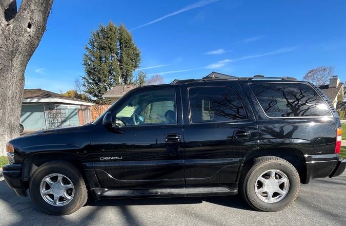

(2) 2003 GMC Yukon Denali
"Drives excellent, one owner , original miles 150k , passes smog , always serviced really well tooken care of, new tires , breaks semi new asking 6800 OBO."

My cursory approach is newest year model with lowest milage and features that I need and never buy one that lived in snow-salt areas of the USA.
Then I look at their Car Fax dealer service history for excessive electrical-related service or MAJOR accidents.
Finally I'll do an inspection and perform what I call the smell test.. where I look at everything, test drive and then go with my gut.
5.3L is okay, should go 300k miles if properly maintained and a smidgeon of good luck.

Yes AWD is all the time. No high or low thus your mileage will suffer. Do you need 4WD? Denali generally has most every option available including leather which may or may not be good for your dogs. Not all Denali came with a 6.0 but most did. I believe the suspension on the Denali is different as well in the gmt800.

Difference in miles between the two you listed is negligible.
Difference in price, between the two is also negligible.
The Denali is newer and may have some more doo-dads than the LS Tahoe. That said, the Denali is AWD. Not necessarily a negative, but the systems are just a little more involved that the traditional 4WD on the Tahoes. As things get older, there might be a little more opportunity for some of the extras on AWD to start showing their age. Might also have stability control/traction control on the Denali AWD. AWD also has implications on having to buy 4 tires rather than two at a time.
That Denali might have the air ride or a self-leveling suspension. Again, not necessarily a negative. But... the suspension and related control systems add just a little more complication to things as components get older.
Just something to think about.
If the Denali was kept 100% all along, then I would say either truck.
In my mind, the way I think now... I am about less is more. If both were in similar condition and maintenance was equally as good on both, I would lean towards the Tahoe.
Just because it has less to go wrong as it continues to grow older.
For me, simpler is better. In fact, I may even look at going to 1990's (or older) vintage when I am ready to get into a "new" Tahoe/Suburban! Less electronic stuff to fail.

I've never owned or parted one out, but I believe even the 6.0 Yukons still had a 4l60e. 4l80 didn't start until 1500hd or 2500 level vehicles, depending on year model.

I would go the Denali route. 6.0 is a great motor and I would always go to the higher trim level, all things being fairly equal. The air suspension is an easy fix if you need to replace the shocks or air compressor. The ride quality will be better as well. No brainer.
Hard to tell, but looks like the Denali is in better shape as well as the tires. It makes a difference.
