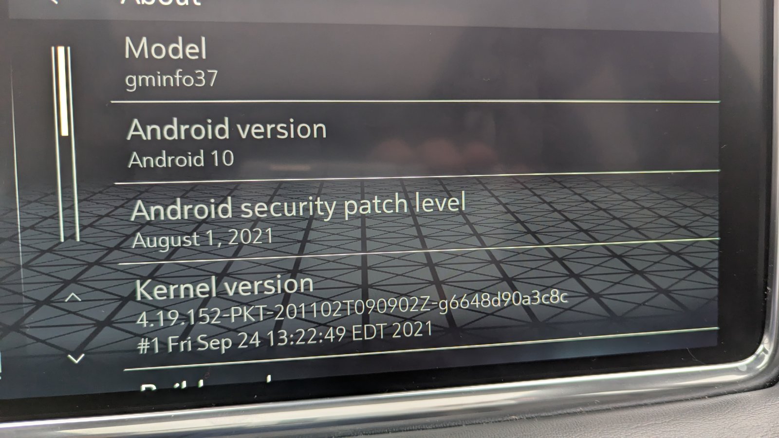

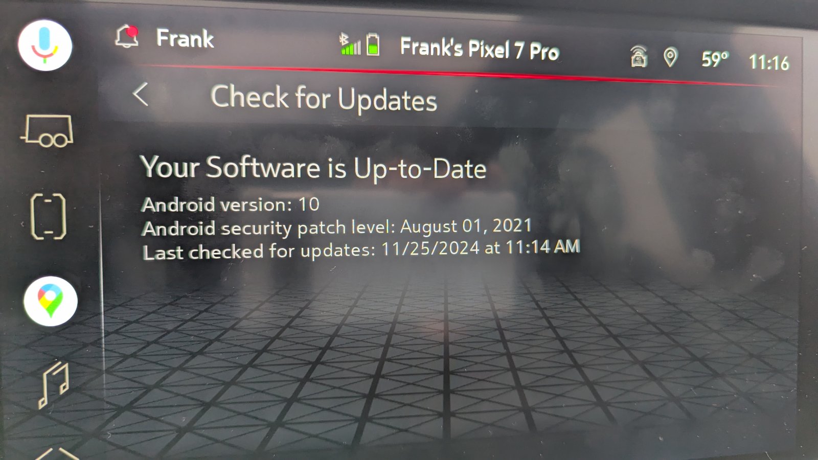

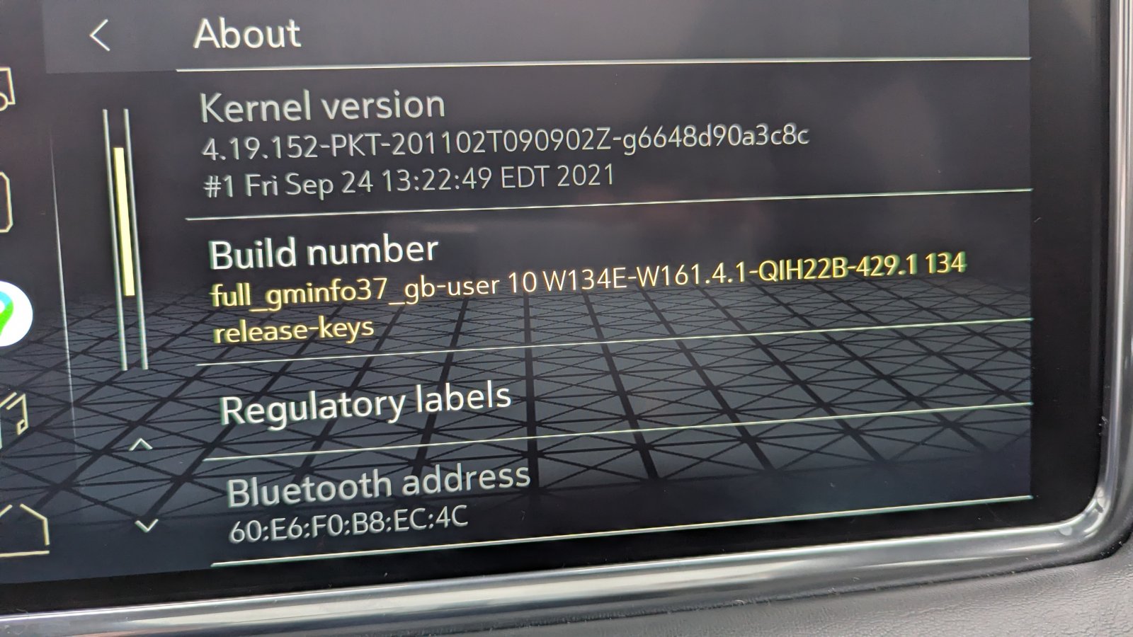

Curious what version software you guys are running? Just got the serial gateway module update and expected to be upgraded to Android 12, but as you see, still on Android 10 and no updates are available. For what it's worth, I have random no starts and battery drain issues. If I try to reboot the infotainment by holding the end call button for 10 seconds (or more) while in Park, nothing happens.

The circled numbers are the "Verson" number that GM often refers to in their TSB's.
I believe the latest released version is Y172, which is what is running on my Yukon fairly problem free.
You can surf through the key "manufacturer communications" at nhtsa.gov and find the release notes on all the versions. Here is the one for Y172 https://static.nhtsa.gov/odi/tsbs/2024/MC-11006812-0001.pdf

Thank you, that is helpful. Shouldn't this update OTA now that the Data Gateway recall has been done? When I check, it says no update is available. Fwiw, the truck is no longer under warranty.
