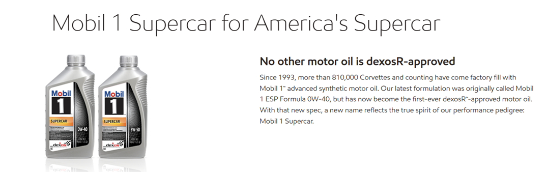

Screenshot below is from the Mobil 1 website, they even state that the supercar oil was "originally called Mobil 1 ESP" (aka the green labeled stuff in the first pic) but has now become the first ever Dexos-R.
So technically there are two options for Dexos approved oils in 0W40, but if I were in Vegas, I'd bet it all on the two oils being identical, or virtually identical.
Again though, just because an oil isn't Dexos approved doesn't mean it wont do just as good or better than the Dexos approved stuff, just means the oil manufacturer didn't pander to GM enough to get the seal.

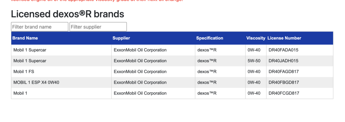

Some oils have been added to Dexos R. More than 2 now.

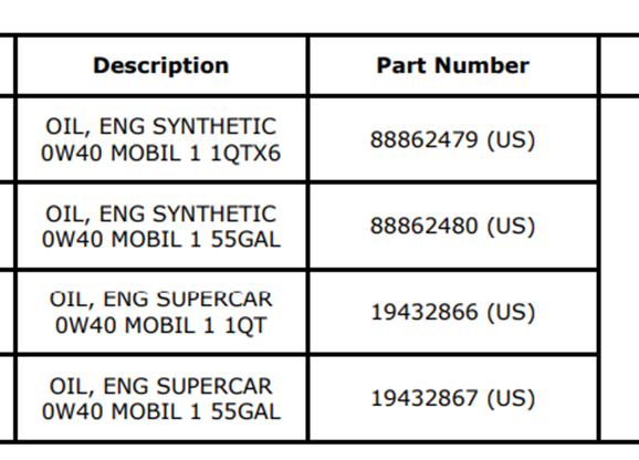

Aren't those are just the different part numbers for various size containers the oil can be ordered in (i.e box of six quarts, 55 gallon drum, etc.)?
Here are four of the part numbers (same two oils, just different quantity), there is a a fifth part in your pic, but its for a 5w50 variant of the supercar labeled oil (which I suppose one could use 5W50 if they wanted to, but we've been talking about 0w40s so far at least).
No, the bottom 3 on my list are 3 different types of mobil 1. Mobil 1 Fs is a european oil and may be harder to find in the US.
