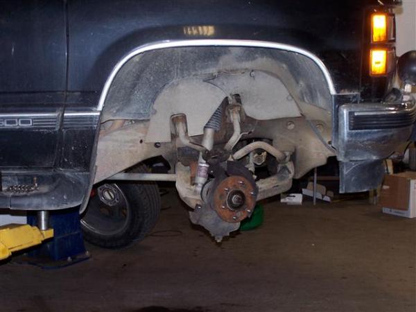

Of coarse I picked the one Saturday that our shop decided to close on. So I was completely by myself. I couldn't find tools, and ran into problems.
I subscribe to the 'put stuff back exactly where you got it from and clean up after yourself' therom, so the Mechs gave me keys to their boxs and the shop. But again, I'm server certified, not wrench certified, so it took me over 8 hours to do this swap (well, and install a new Corsair H70 in my home machine :) ).

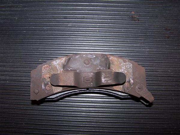

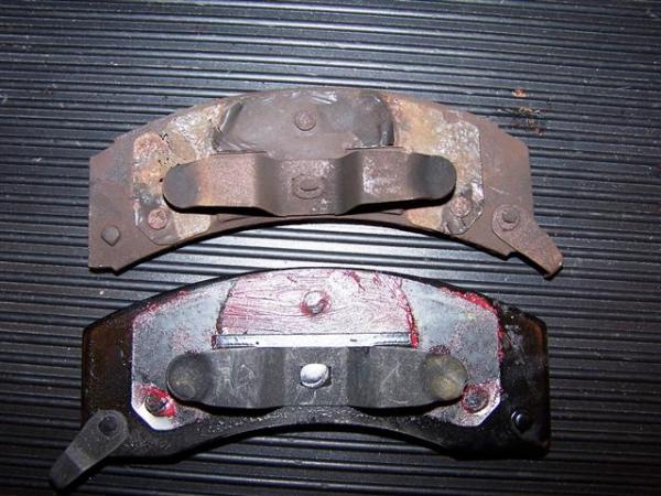

Turns out that even though Summit racings webpage confirms that the set of Hawks brake pads say they fit my truck, they don't. They are too wide, and are grinding on the hub of my rotors. I had to quickly order up a cheap ($18) set of pads to put on. I've already emailed Summit to ask 'what's up with dat'. Here is what I ordered.

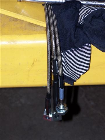

And I couldn't install the SS brake lines. My existing lines are too rusty to crack off, and I was turning the line, so I instinctively stopped and reused my old lines. I will wait for a Mech to install the SS lines.

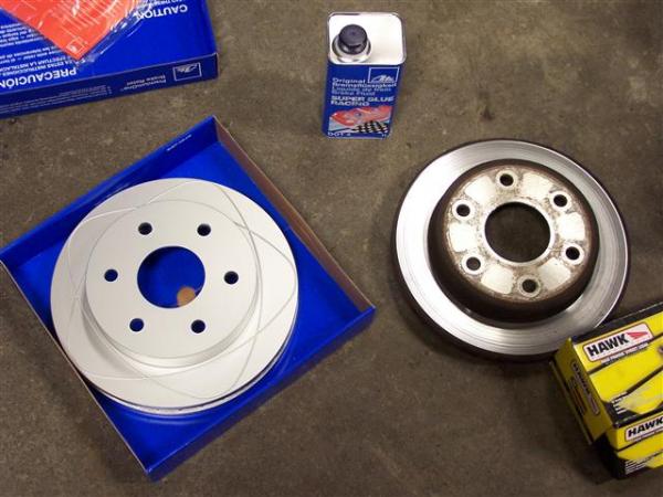

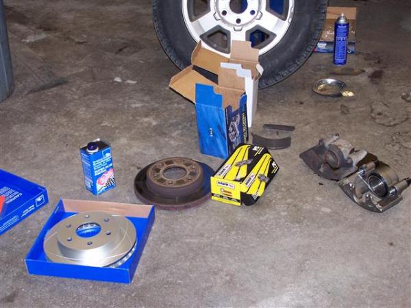

Gather up all of your parts required;
ATE Premium Slotted Rotors, ATE Super Blue Racing Brake Fluid, Incorrect size Hawks Premium Ceramic Pads.
Upgraded 3/4ton Brake Cylinder. These bolt right on, and have no clearence issues anywhere. The 1/2ton pads(when sized correctly) fit right in. The Only difference is the bigger diameter cylinder.
Russell SS Brake Lines which I couldn't install.
Swear and Curse at wrong Pads. Old on top, New on bottom. Actual pics I emailed to Summit Racing.
