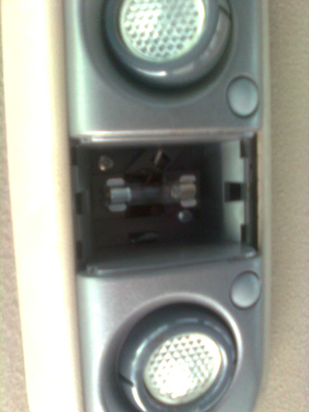

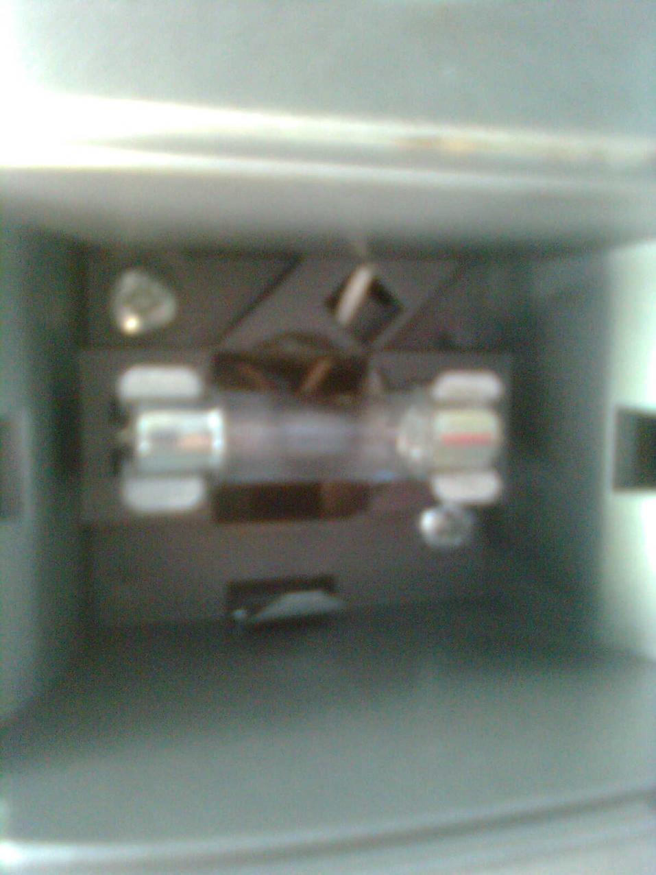

Anyone know what kinda bulb the round ones are?? And what the number the cylinder shaped one is?? Wanting to swap them out for LED ones.

Well i wanted to get all my LED's from superbriteled.com but i could try that too unless someone else chimes in and tells me the number on the bulbs

Thats exactly what i did lol i just wanted to make sure the length of the 211 bulb. Im ordering my LED's today so i'll post up pics when i set them up next week. Oh and i tried to take out those map lights but wasn't able to pry them off. Is there another way i can do it??

Taking down the whole assembly, that is what I did.
My ass couldn't pry them off either.

I figured out how to replace the map lights after much hassle lol just push them in slightly and turn them counter clock wise and the whole light piece will fall out. Just pull out the plastic bulb holder and wala swap out the bulb.
