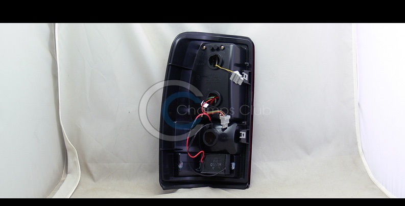

The little black box on the back bottom of these led tails, is it a load resistor?
coolchuck
maybe Escalade bound?
Oct 30, 2011
570
DC Suburbs
Yep, thats the resisitor.
---------- Post added at 06:36 AM ---------- Previous post was at 06:33 AM ----------
Also, make sure to line up the black wires on the harnes plug with the black wires on the tail light plug. If not, you'll blow a bunch of fuses.

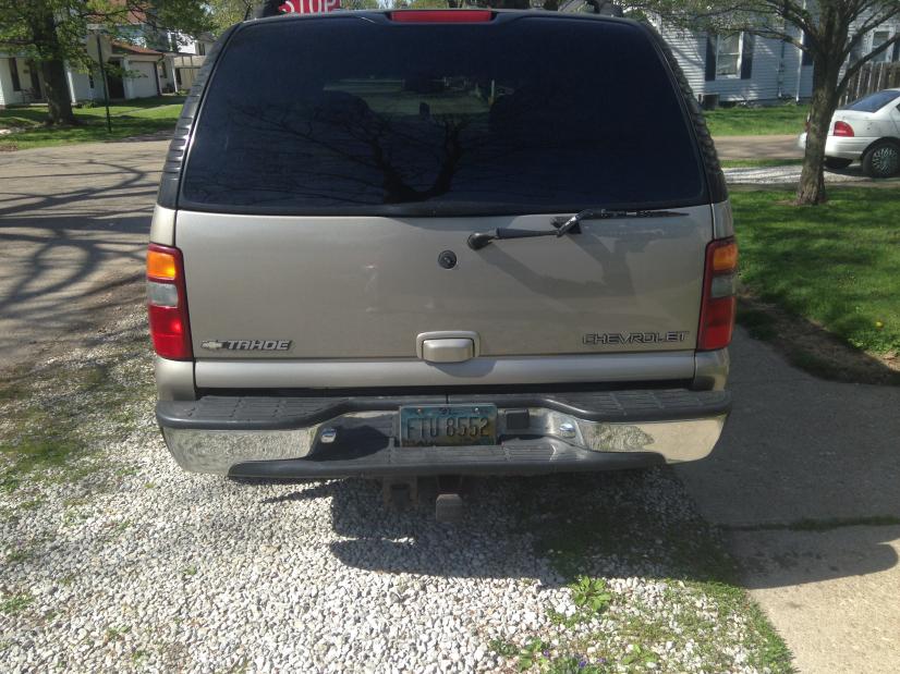

Got them put put on and man they look way better than the factory ones.. really sets off the truck. photo 1 (1).jpgphoto 2 (1).jpg
