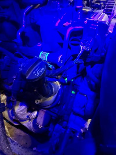

What is this part that is leaking coolant?
InspectahDEck
Oct 15, 2013
76
66

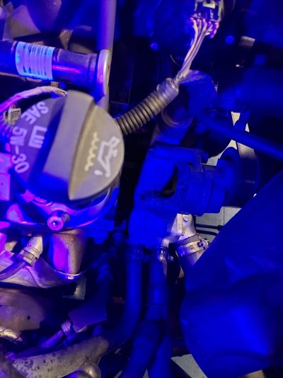

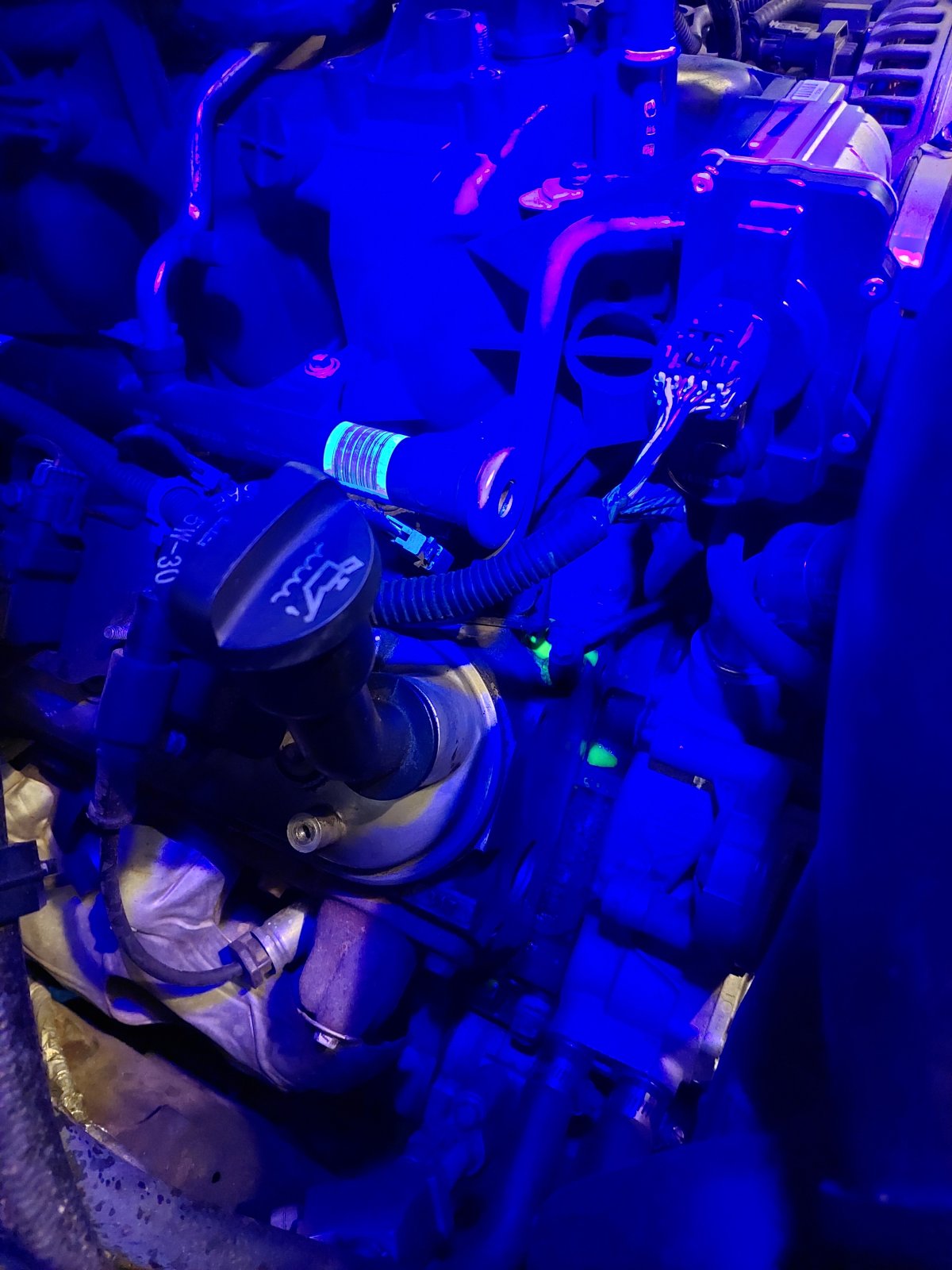

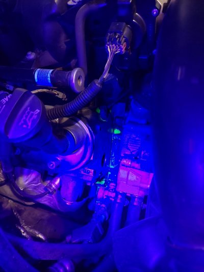

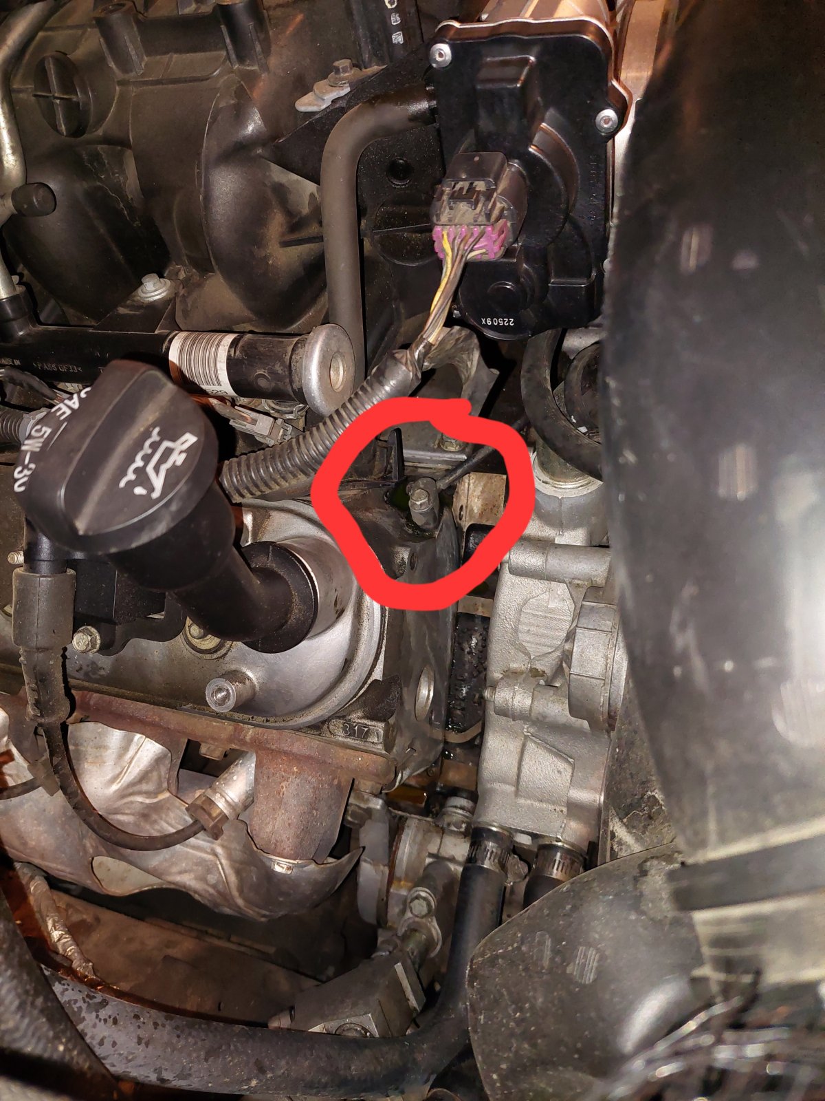

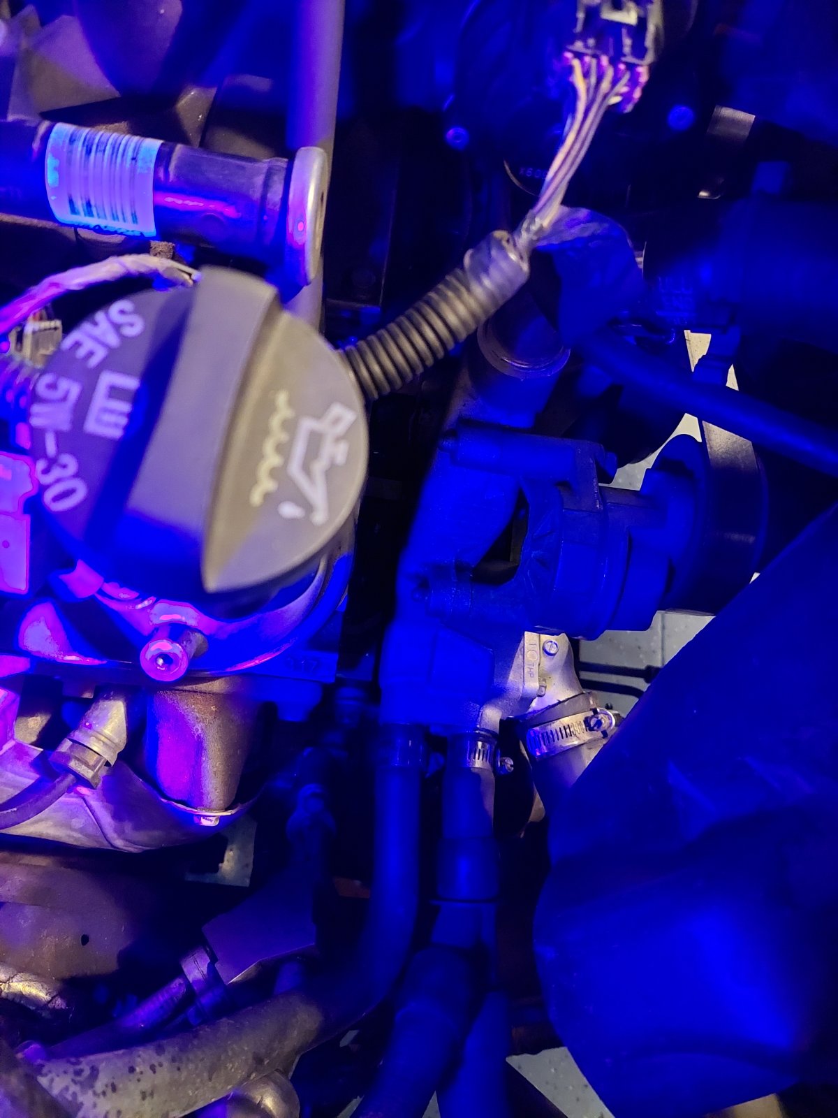

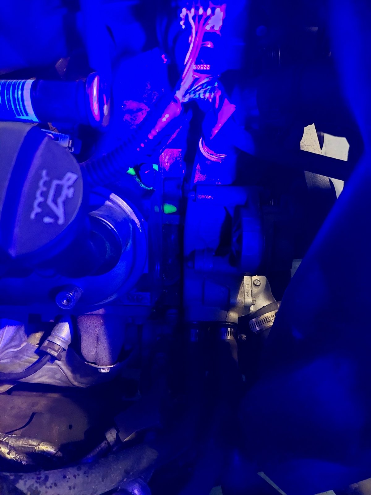

I have a coolant leak that I thought was from the thermostat housing, but after replacing that and the thermostat the leak continues. The thermostat area is completely dry, so I added some dye so I can find the leak easier. It seems to be pooling from the area circled red, I also included some photos with a uv light which shows where it's dripping down.
The part circled red, what is that which could be leaking coolant? Any help appreciated

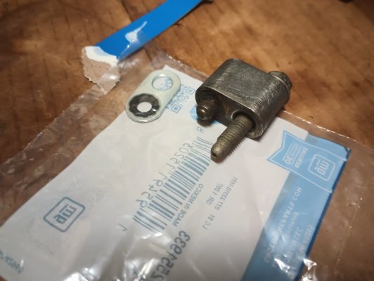

Yes, they make replacement gaskets for those.
Unfortunately, this picture doesn't have the entire part number. The are like $12 each IIRC. There's a pair on the front (with the crossover pipe) and another in the back of the engine (just solid little plugs like on this photo.)

It's called a coolant bypass seal (or head steam port crossover). I presume they are the same my truck took but confirm your year, make, and model on RockAuto... There they are $6.06 plus tax & shipping.
ITC billet makes an upgraded steam port crossover that takes regular o-rings. However, probably not worth it. I just used the factory one with new seals when I built my engine.

Yeah just unscrewed the one side that was leaking, fluid started coming out so I quickly lifted the crossover just enough to put the gasket under and quickly put the bolt back in. Lost a decent amount of fluid though still, engine was still warm fwiw
