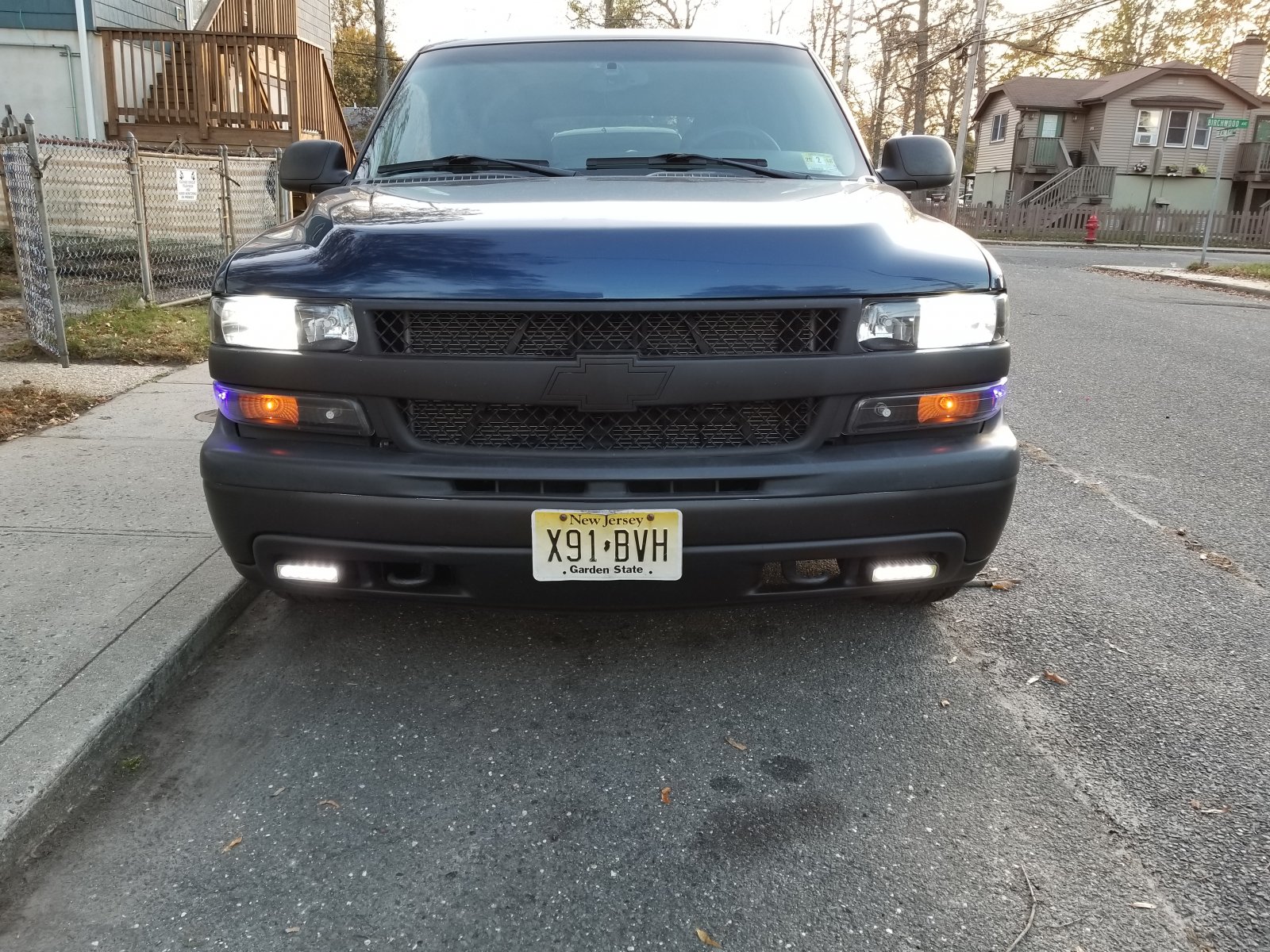

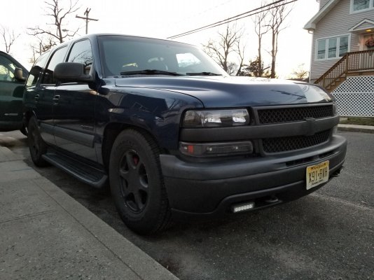

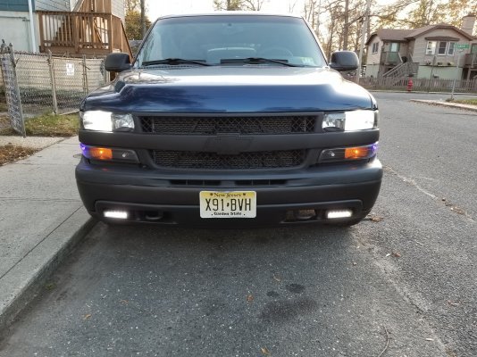

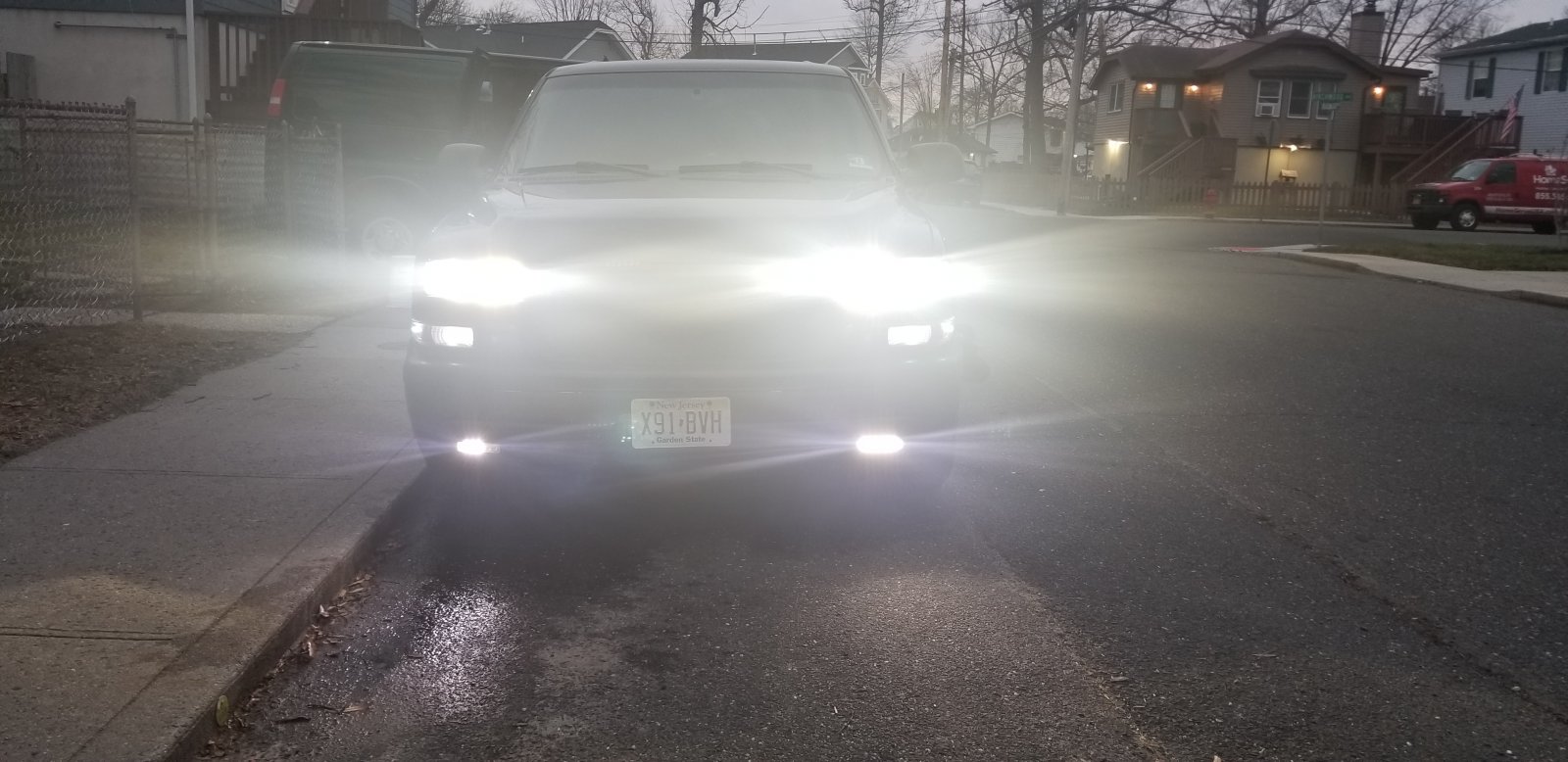

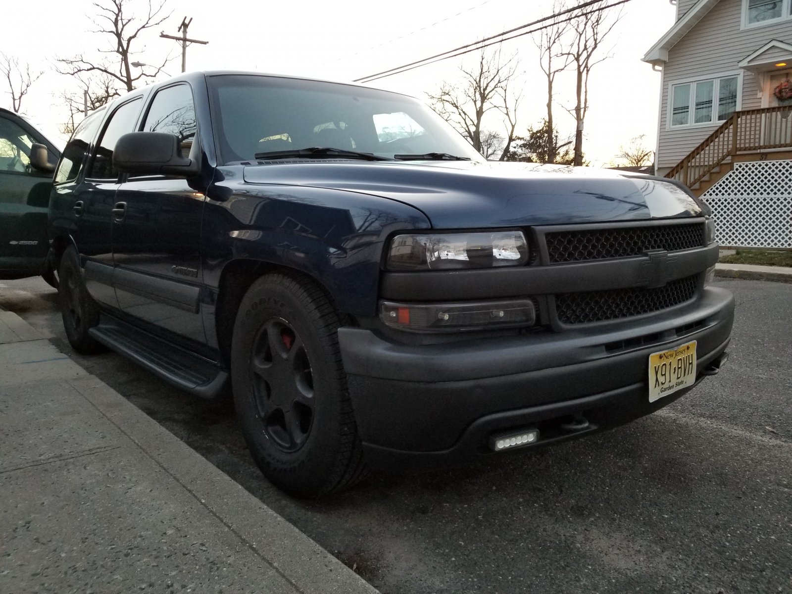

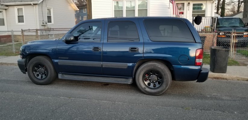

All of my exterior lights are aftermarket. When I got them I ran a bead of silicone around the inside edge, and some dialectic grease on the bulb gaskets. I've had them installed over 5 years and I've never had any moisture issues. My headlights and lower marker lights are made by Spyder.

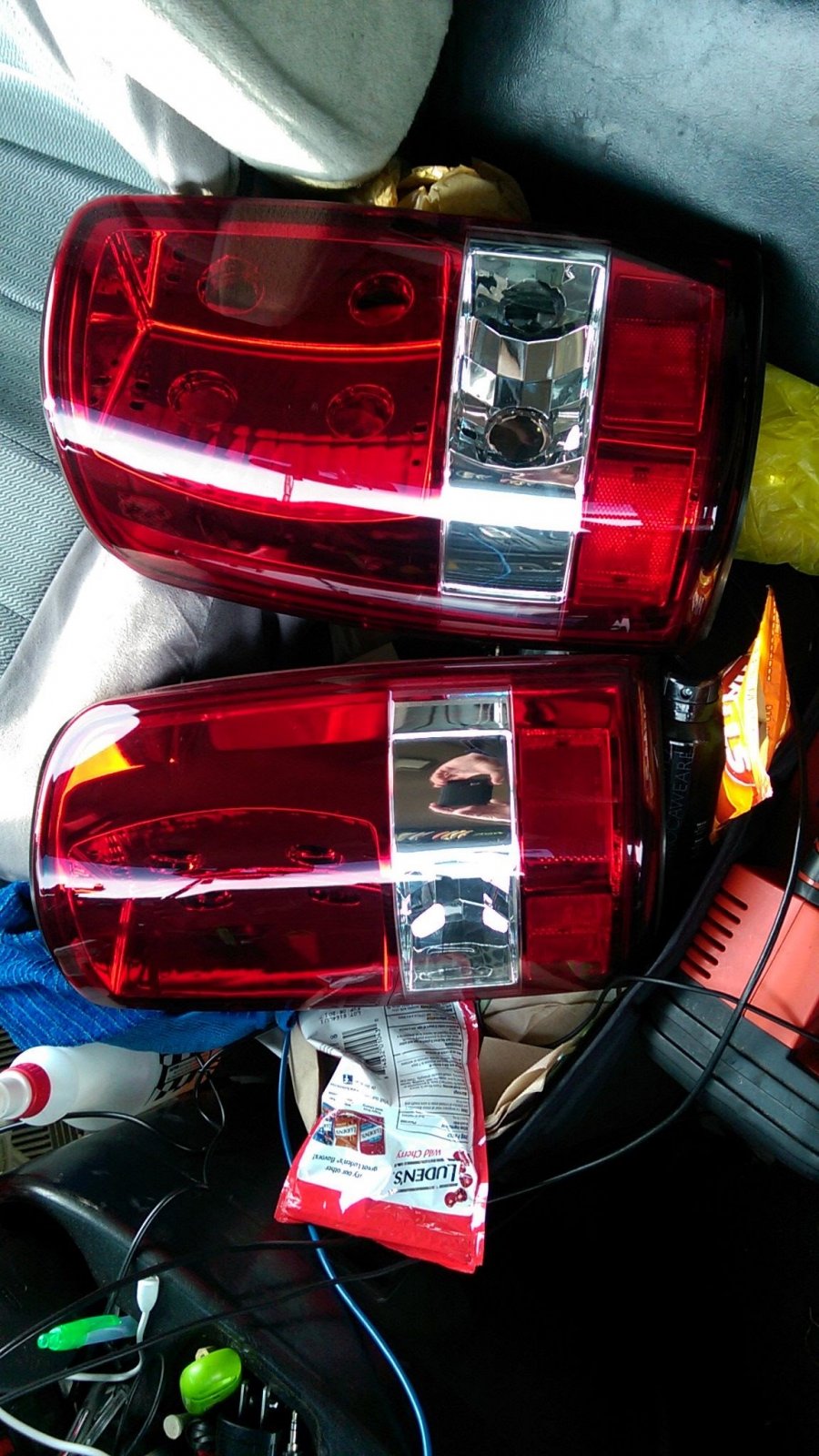

I bought them off CL used, but they were actually still new. These are the non LED lights with LED bulbs in them.
I'm not really sure of the manufacturer.

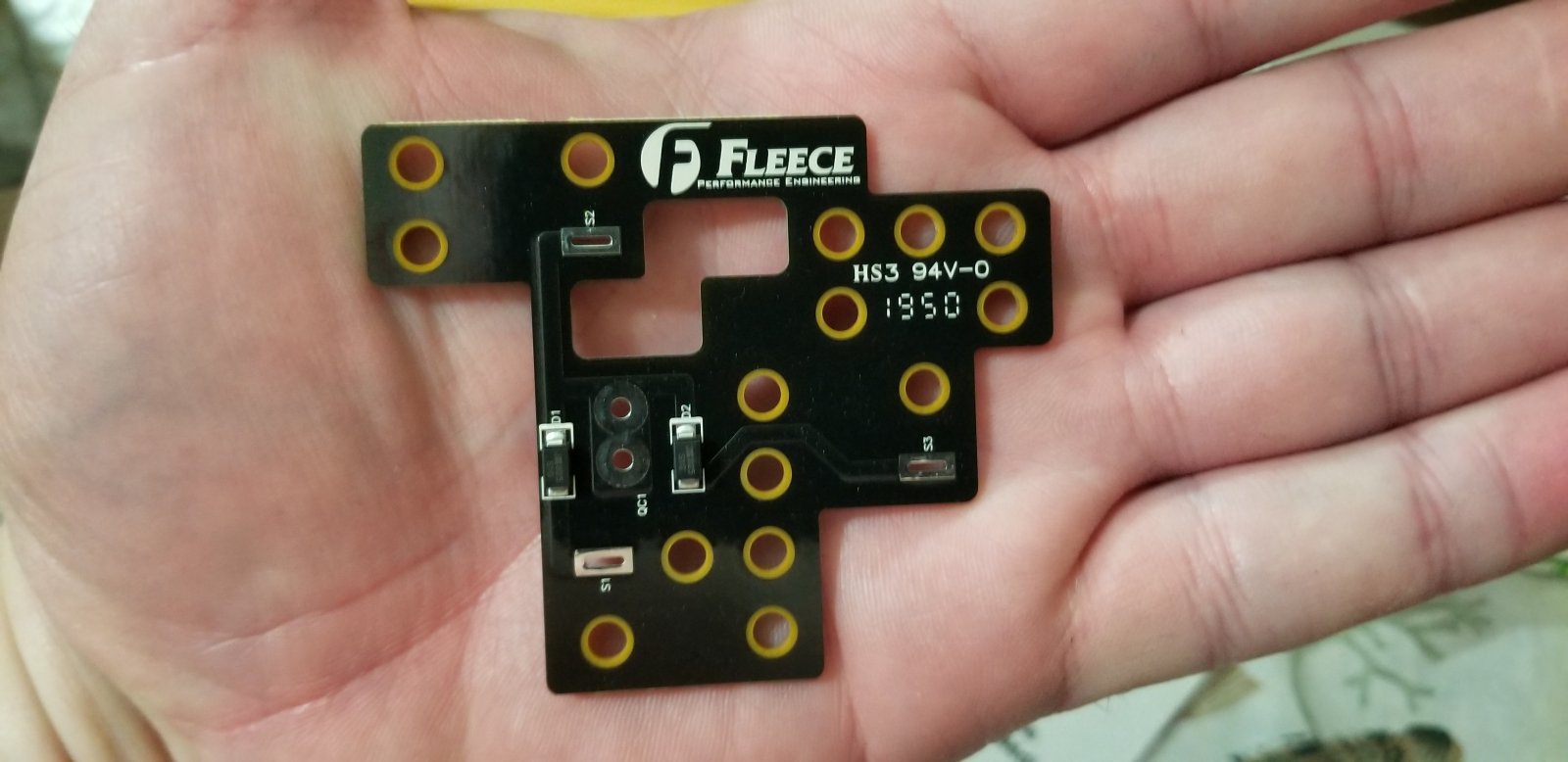

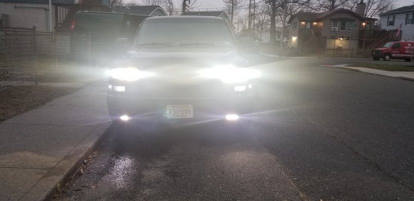

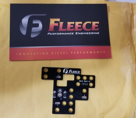

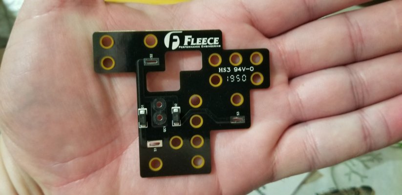

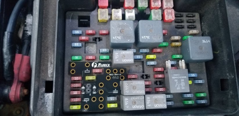

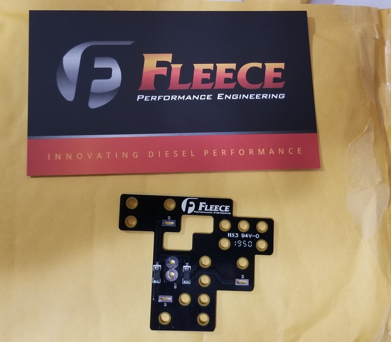

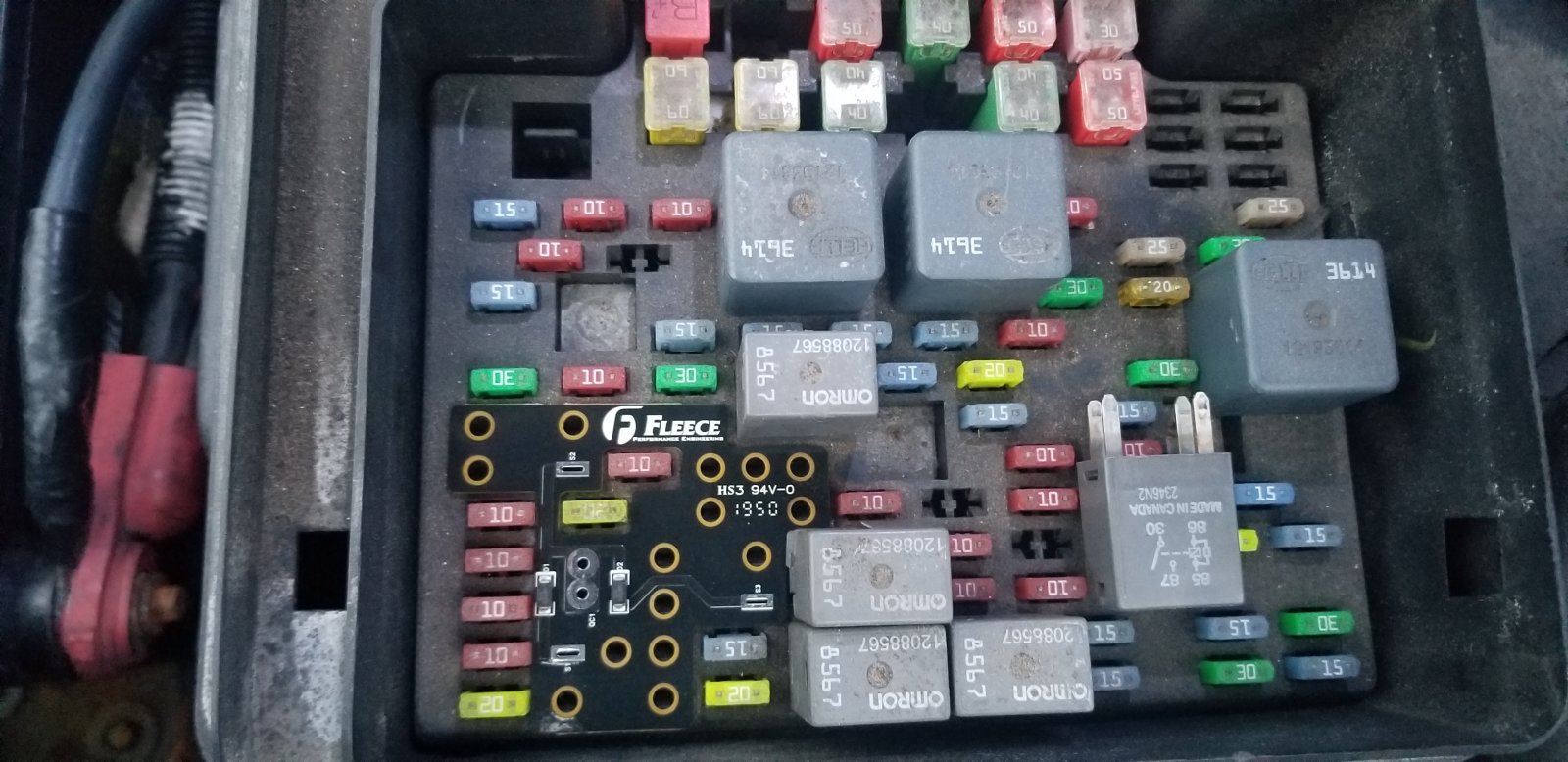

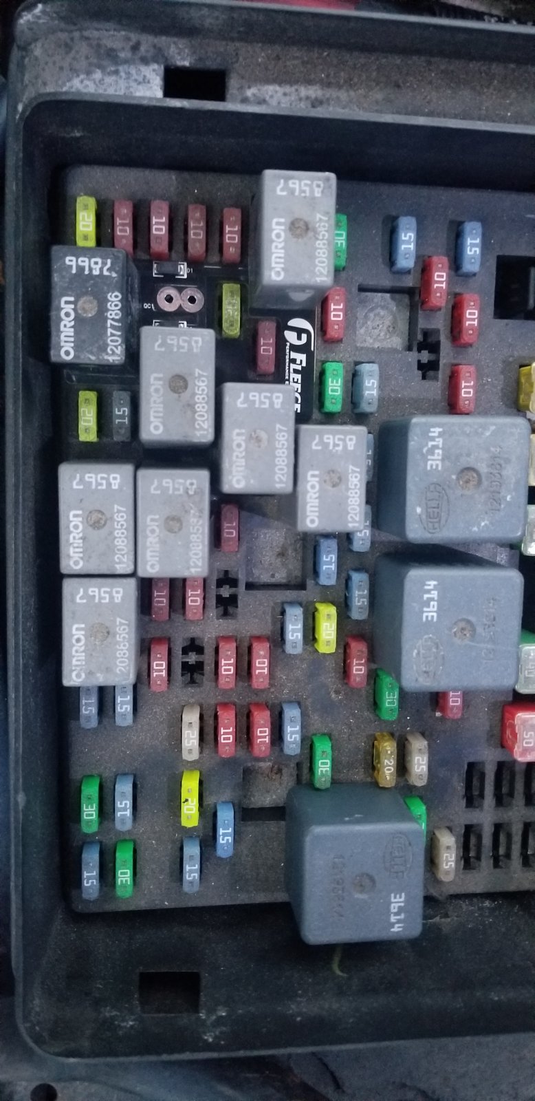

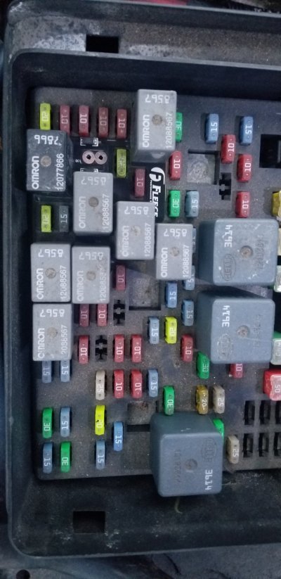

I also have the LED bulbs in the front. I like them much better then the HIDs. I have the Fleece module--everything comes on with the high beams--lows and fogs.

Yeah I have watched some you tube videos on it. It is inexpensive and appears from the you tube videos easy to install.
