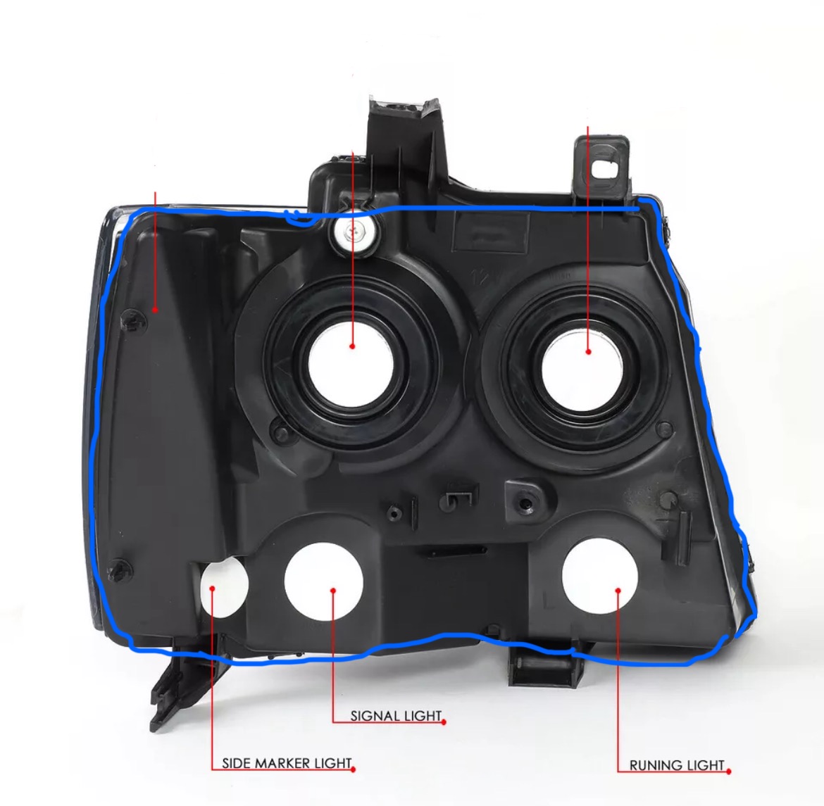

I bought some headlights from Ebay because I think OEM style headlights look best.
I want to seal them to ensure moisture does not get inside of them. I was thinking of getting clear silicone and running it around where the clear lens meets the headlight body.
I put a picture for reference
Is there anything else I should do to help keep moisture out?

OE and all aftermarket lights that I know of are already sealed, but if you mean additional sealing, I'd use Windo-Weld (yes, "windo" is correct).
Yeah, I mean additional sealing. Would I seal it following the picture I referenced?

run a bead of silicone sealant along where the lens and housing meet just for added insurance and make sure the vents are open and clear
