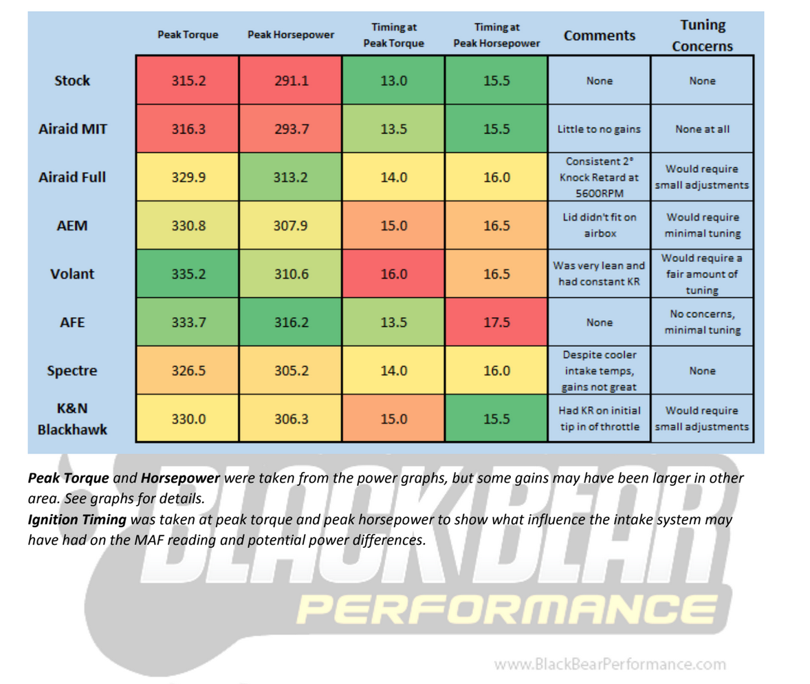

The OEM intake tube is designed to reduce engine intake noise, and the engineering design with those spaghetti baffles is to produce eddy air currents which counteract the noise of the intake air flow. As such, it is not as efficient as it could be.
The are Heimholz resonators, and act as sound-wave attenuators. You can see BBP's dyno comparison on a 2016 Yukon 6.2, and the full data here: https://www.blackbearperformance.co...bear-performance-cold-air-intake-test-results
Power runs:

Based on that chart, looks like the AFE is the wiser choice over the Volant.
(See graphs for details? Anyone still got the graphs?)
Mind that those are PEAK gains, occurring between the peak torque RpM & Peak horsepower RpM.
Despite typically driving like an impatient jacquesarse (even with riders aboard),
I MIGHT get above 4000RpM 3x a day; 5x on very rare days.
