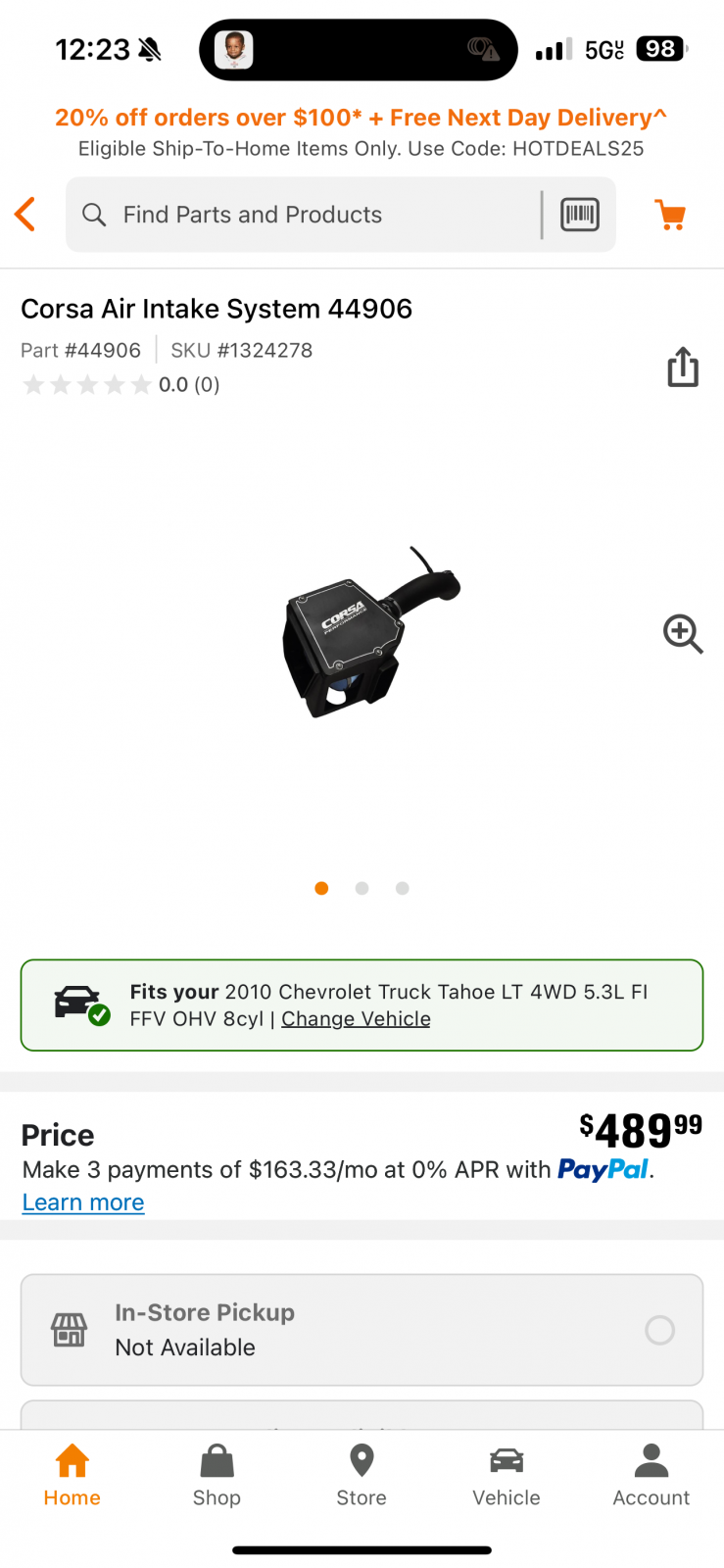

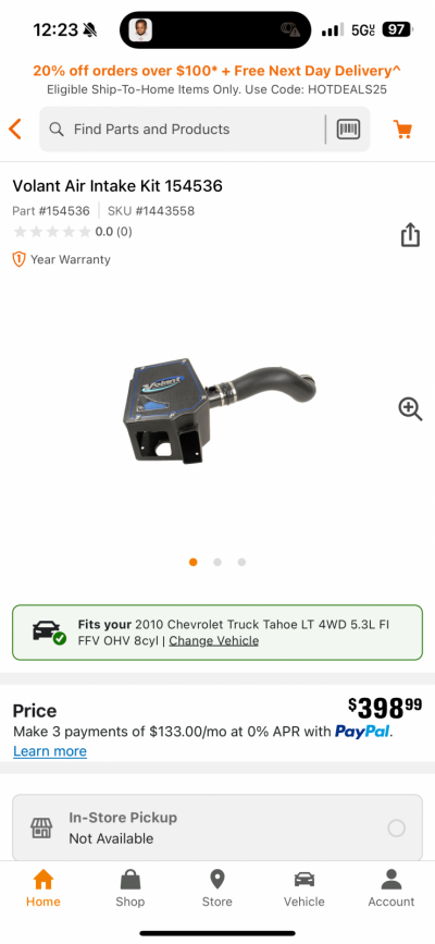

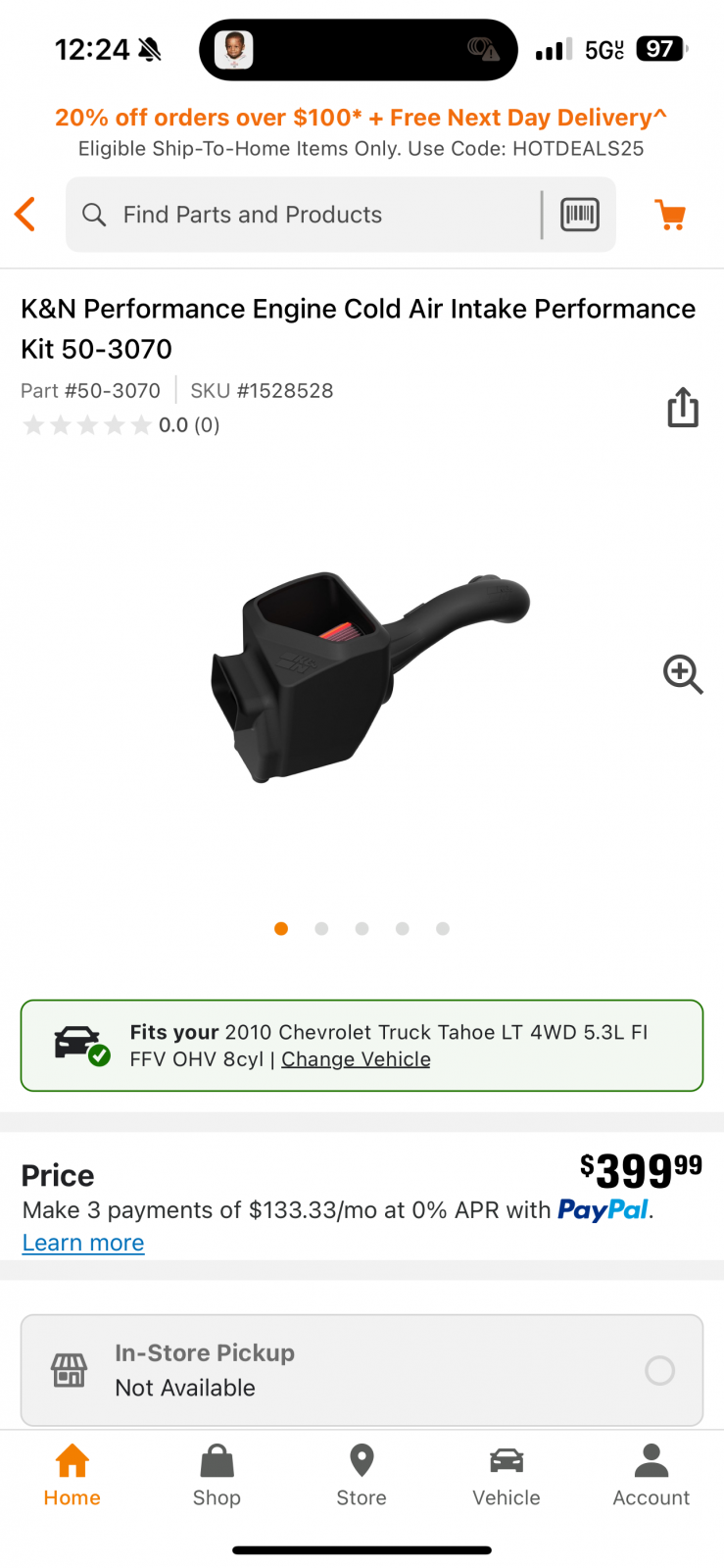

What is the best intake to buy looking for a cold air box intake for my 2010 Lt Tahoe 4x4
Esemaico91
Jun 7, 2025
Really looking to build up the 5.3 a bit looking to add long tube headers a cam and xpipes with a tune eventually just got the truck to 100% health no issues at all atm

None of them, your airbox is perfectly fine. If you want more air or s tiny bit of growl(minuscule sound) get a drop in k&N filter that fits factory box or similar (dry type because you'll mess up the MAF sensor with the oiled type) and try to find an straight intake tube without the baffles or modify your oem.
All the open ‘cold air intakes’ are not quite ‘cold’ they are open to the heat and dirt from the engine bay, defeating the ‘cold intake’ claim. The factory box draws air from outside the engine bay for a ‘truer’ cold air intake…. My 2 cents

Agreed with @PG01 100%. Anything aftermarket is not designed and tested as the OEM stuff is. That intake will flow more than enough air, and pull it from a cool fender area instead of from under the hood behind the hot radiator.
Some of what you shared will do the same thing as OEM, persay, but it's not going to reinvent the wheel by any means. They just look prettier than the stock one.
The only thing those do, IMO, is add some shiny HP (perceived) under the hood.

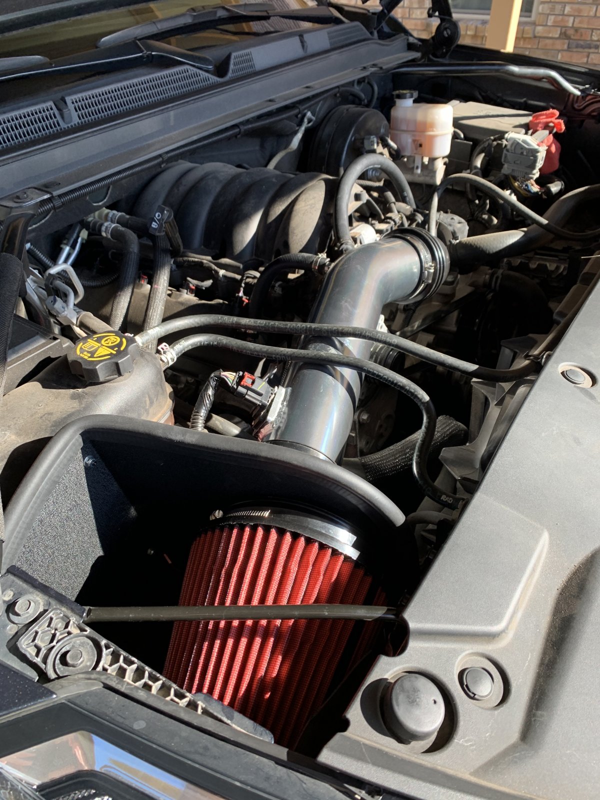

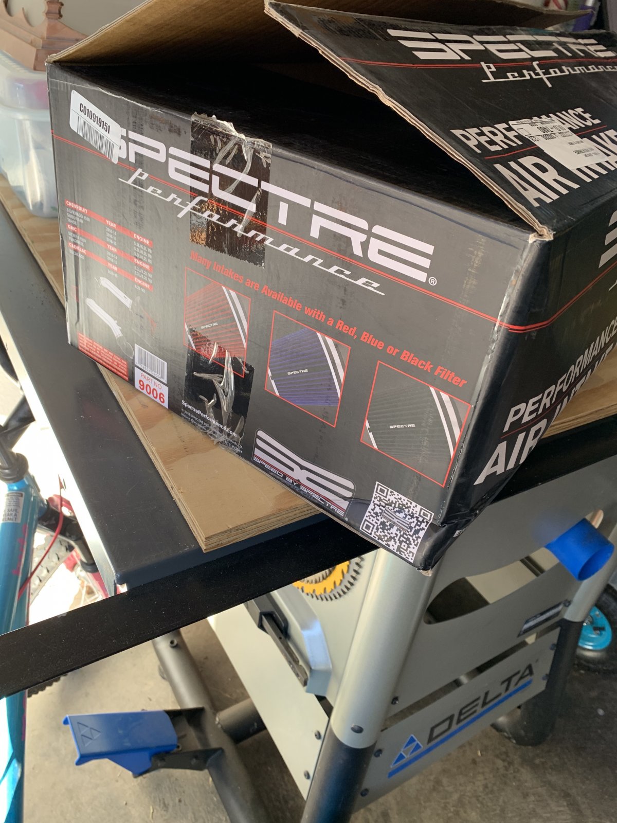

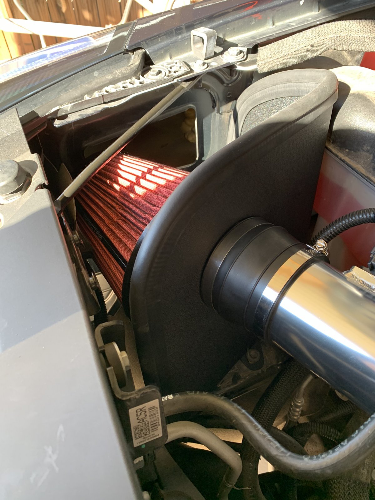

Personally I purchased a Spectre, PN 9006, for my 2019 Yukon XL, I like the noise {which is only noticeable when I DON'T drive like gramps.... AND I use the Oiled filter. I've been running it since 12/2020 with no issues. I live in a dusty Abilene, TX so I clean/reoil it every 5-6 months.

... purchased a Spectre, PN 9006, for my 2019 Yukon XL ... AND I use the Oiled filter ... with no issues ... in dusty Abilene, TX ...
Ever consider a prefilter, like desert racers use, or even some pantyhose?
That's an HAI system, HOT Air Intake.
Have you measured inlet air temps while idling and at speed?

Nope. Filter seems to work fine. The noise everyone is bitching about takes me back to my 283 ‘64 Chevelle in high school. I worked on military helicopter weapon/flight control systems my entire adult life. I can hear any dam way. “)
