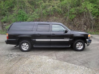

What is the best way to black out the chrome strips along the sides, the bumpers, and the grill? I tried to paint the grill years ago on a 95 suburban and the paint crazed on me. I used steel wool on it to scuff it up and wiped it down with thinner. I dont want it to happen to this one. I want to debadge and black it out.

you will need to sand with 320, prime with self etching primer and sand again with 320 ten prime with reg. primer and sand with 400 then paint

+1.. I would add a couple clear coats as well.

So will spray bombs give me a good finish with using a clear? 2005yukonxl, what setup is on that white truck. It looks awesome.
