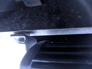

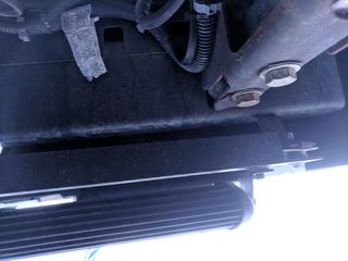

Can’t you show or take picture of where you installed them how to screw them on to what
10,339
14,988
Sure.
First, a 1" right angle bar stock is attached to the existing lower rear bumper support brackets, thus creating a stable platform, upon which to attach the LED light bars. Spacer washers are used to properly position the right angle bar stock in relation to the bumper.
Then, the LED light bars are attached to the right angle bar stock, using spacer washers to achieve the proper height position of the LED light bars in relation to the bottom of the bumper, for the desired light dispersion behind the truck.
Let me know if you have any additional questions.
Rear view installed:
Angle bar stock to lower bumper support bracket connection view:
LED light bar to angle bar stock connection view:
