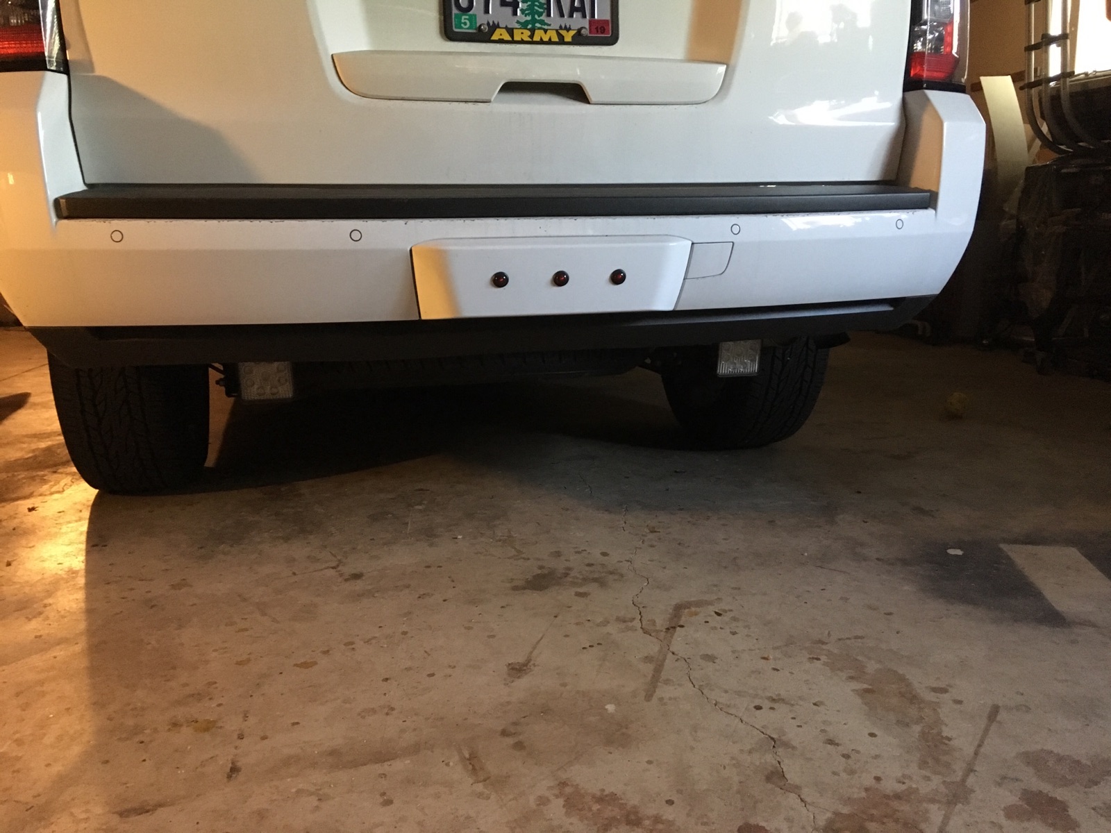

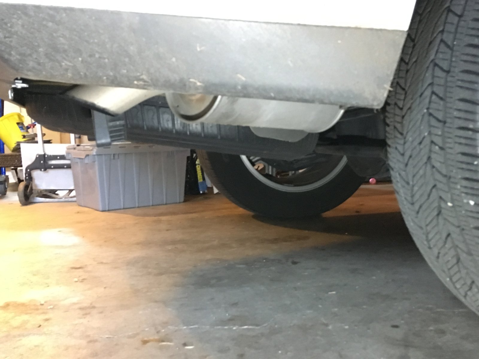

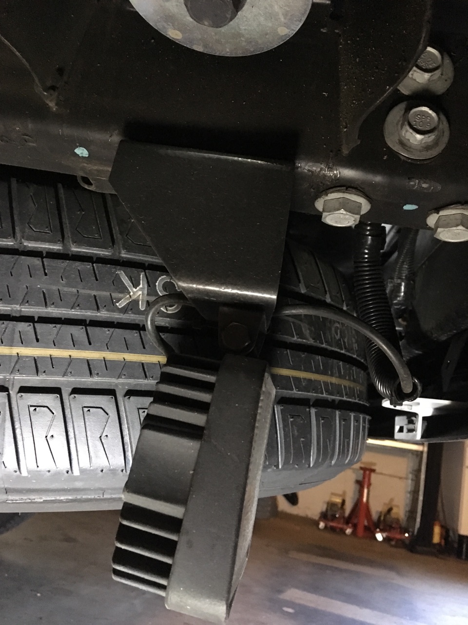

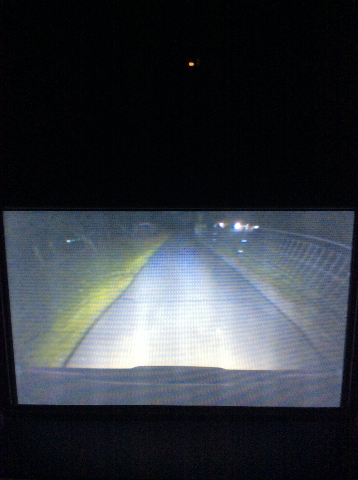

So, I wanted to show what I did. I actually used 27w LED pods, not necessarily a "light bar." I made a stand-off for each light from 3" square tube, painted them and used an existing body (?) bolt that went through the chassis. Angled slightly downward, they work great, not too much light cutoff from the body and barely visible. No beautiful body lines ruined. Power? I cheated. I used a 7-pin trailer plug and plugged it into the trailer outlet. No wires to run, no relays to add. If I'm towing, I disconnect it and hang it right there (I bought a rubber cap for the plug too). If I'm towing, then I probably won't be needing those backup lights anyways.
