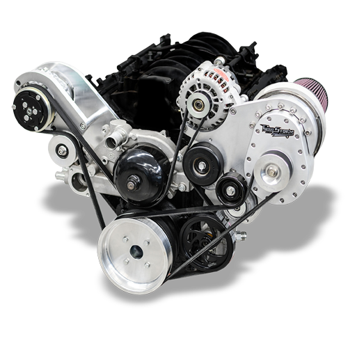

What super charger are you going with? I have a Magnusson and love it but leaning strongly toward a Torqstorm for my Tahoe. I feel with the dedicated 8rib drive, self contained oil system and all billit design its by far the best value out there. But they are somewhat limited to about 700hp which is more than my daily driver needs.
Initially I was looking at them but the 3-4 week lead time kinda turned me off. Plus I found this kit that has more in it and I don't piece together anything

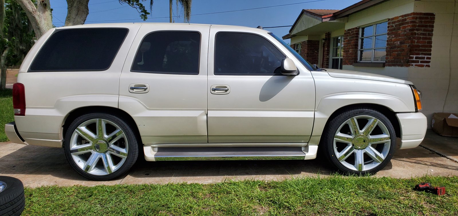

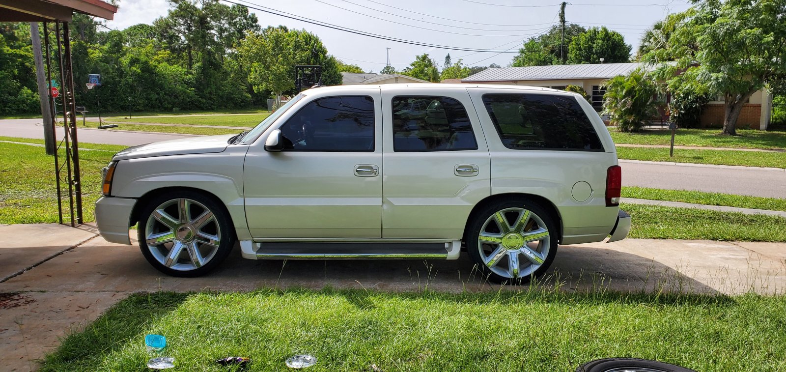

I'm thinking about painting the grey in between the chrome inserts on the wheels the same white diamond of the truck but unsure if it would look good.
Other than that installed a eaton truetrac posi unit along with 4.56 gears to compensate for the larger rims.
