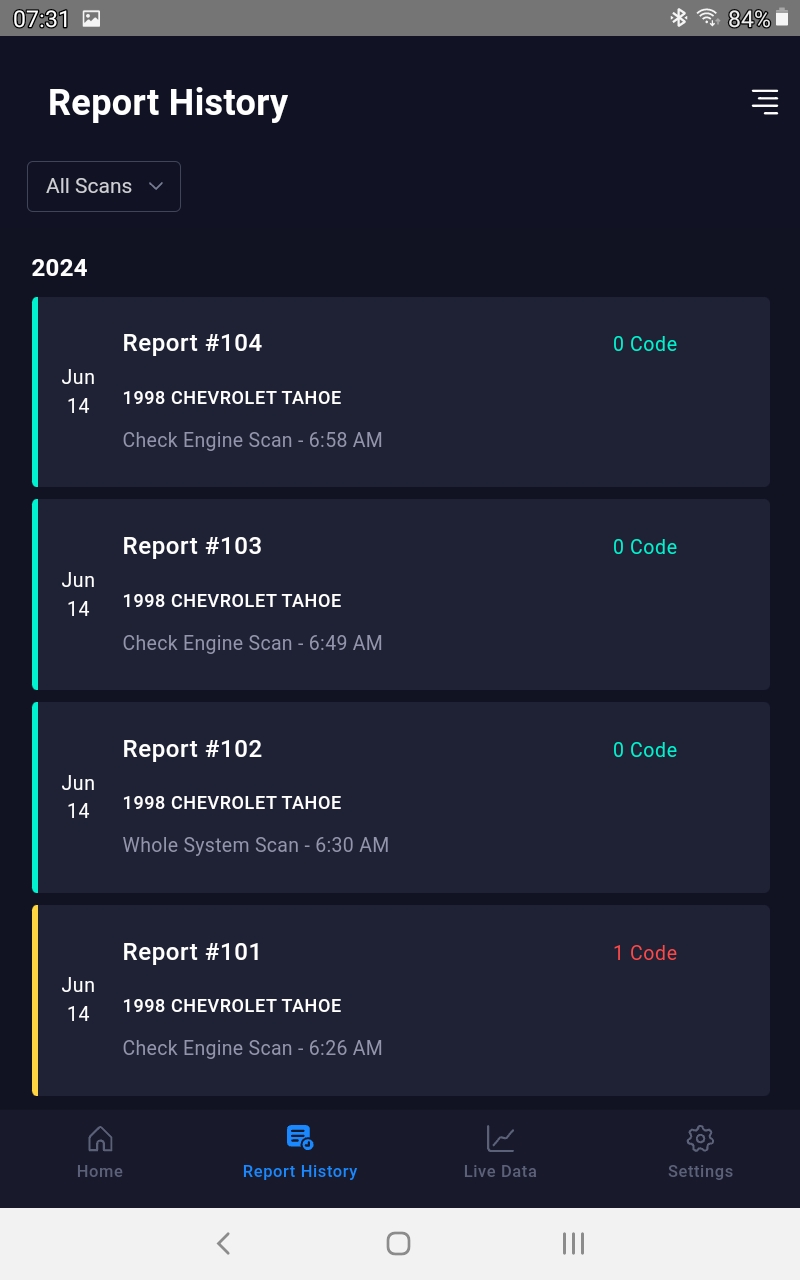

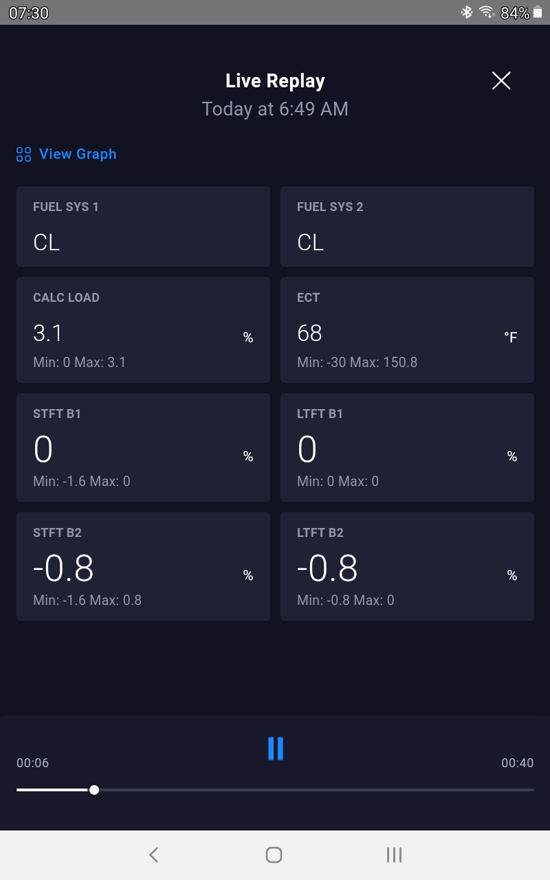

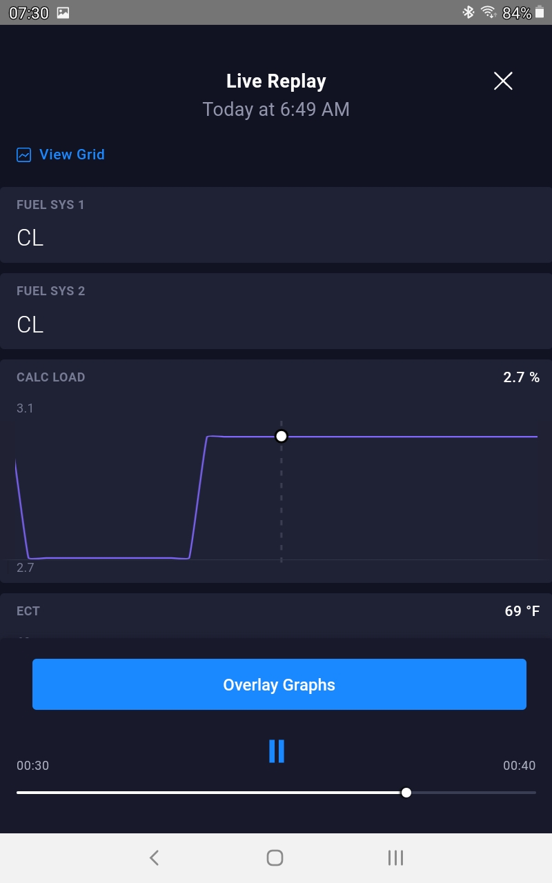

Works. Pulls up all sorts of data and records 'Live Data' while engine running. Also has an Enhanced Code mode for GM products which showed all sorts of MAP sensor and other codes (about 40) but I can't tell when they were set or if any work was done afterwards.
It allowed me to clear everything, so I'm back to no codes and no Service Engine light on the dash.
I'll try to record live data next time I drive and see what it shows over a longer run. I only did it for a few minutes in the garage, but it reacts to throttle with RPM which matches the Tach on the dash.
Initially it showed the same Evap code as noted above.
Connect to my Tablet using RepairSolutions2 which saves data and can be reviewed.
