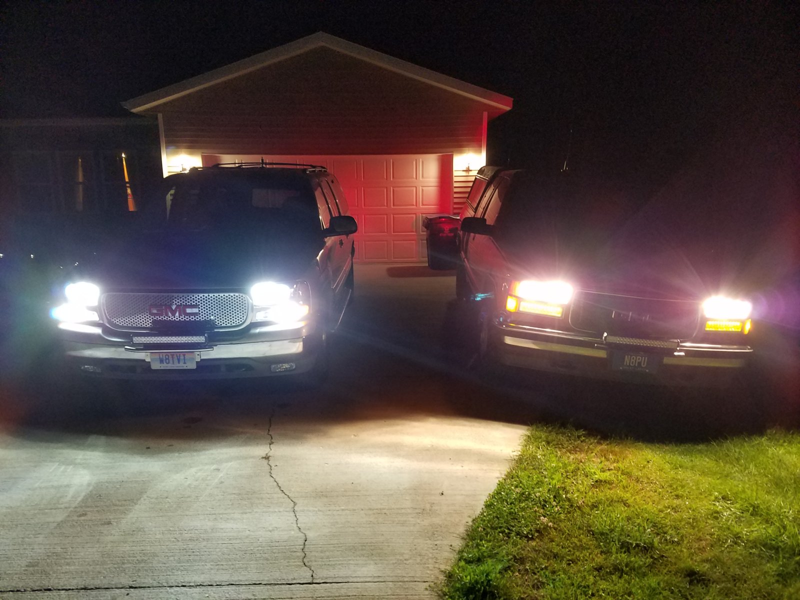

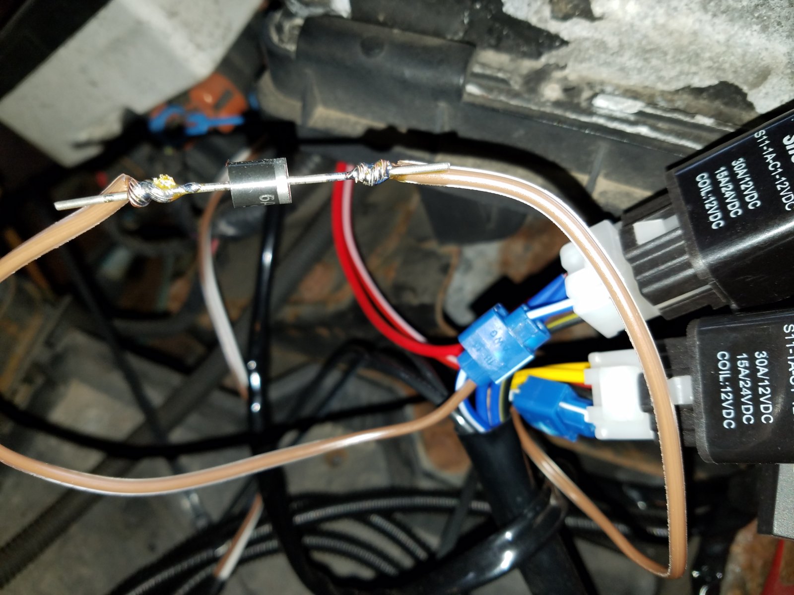

I did the 4-high mod on my dads '98 Sierra, and my 2000 Yukon XL (GMT800).
I know that they aren't a GMT400 Tahoe or Suburban, but I though you guy might be interested anyway, as it was a super simple mod if you have a relay kit for your headlights installed already.
Both our trucks have an aftermarket headlight relay kit installed, so it can run the 4-HI mod with out taxing the stock wiring.
Because both trucks have the aftermarket relay kit, it was VERY easy to do the 4-Hi mod.
On my Yukon XL, I only had to jumper from ground to the low beam trigger/input ground wire.
On my dads truck, I needed a diode and I ran a wire with diode in to from the high beam trigger +12 wire to the low beam trigger +12 wire (cathode (the stripe) of the diode pointing to the low beam wire). If we hadn't had the relay kits, we would have had to use a relay instead of a diode to run the low beams on his truck.
I would recommend the relay kit as the headlights seem brighter being ran directly off the battery/alternator.
