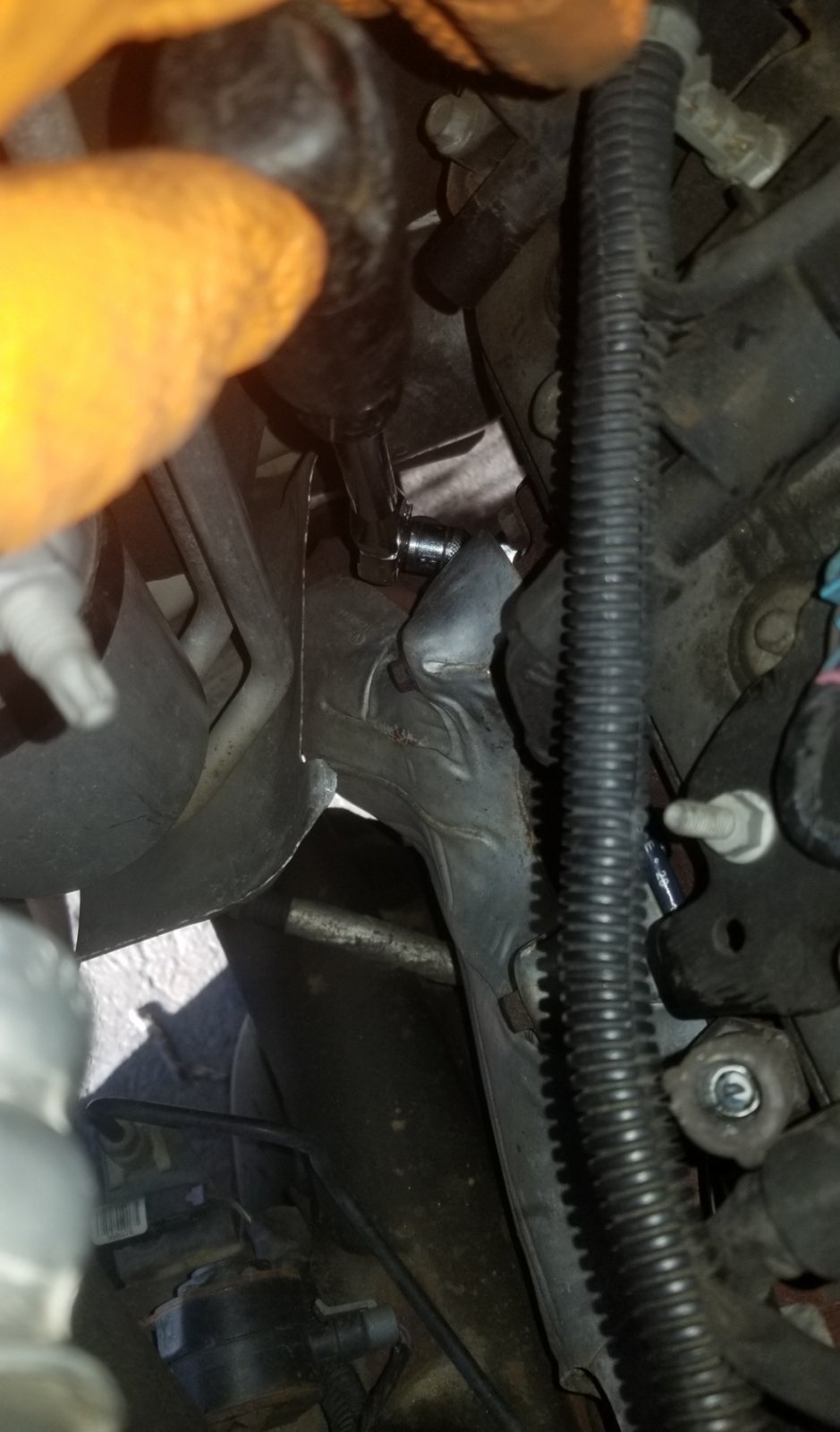

nah, hit autozone and buy there in house brand (duralast) map sensor, lifetime warranty
install, clear the codes, drive it 2-3 days, if the code does not return your golden.
5 minute job
already done the basics. swapped a oem one in there. looked for any air leaks cleaned maf and tb. idle relearn. still pops back up as soon as it runs the test. map and baro sensor reads within range of the chart. 5v ground and signal all look normal. book says possible coolent temp out of spec and cause it too, haven't been put meter on it, but looks normal in the scanner.
fuel trims are spot on at - /+3%.
code sets like clock work. blah. I did use it as can excuse to buy a smoke tester. but I don't expect to find anything. I sprayed brake cleaner all around which watching the fuel trims and nothing moved. usually seems to have many other codes with it, to just have the one seems rare
code sets like clock work. blah. I did use it as can excuse to buy a smoke tester. but I don't expect to find anything. I sprayed brake cleaner all around which watching the fuel trims and nothing moved. usually seems to have many other codes with it, to just have the okd seems rare
have a spare throttle body?

reading it, it seems it runs 4 tests. maf and tb always pass, both map tests fail.
seems weird to me the truck runs perfectly, and I happened to be watching the live map data as a graph while it set the code and the signal didn't show any change or spike.
i'm going to guess since you already swapped a map that it might be the maf instead you have codes for both, I believe one may trigger the other.
the map on the silverado failed with flying colors a month or two ago, luckily that's all it was but while looking into it theoretically it could have been a bad maf also.
