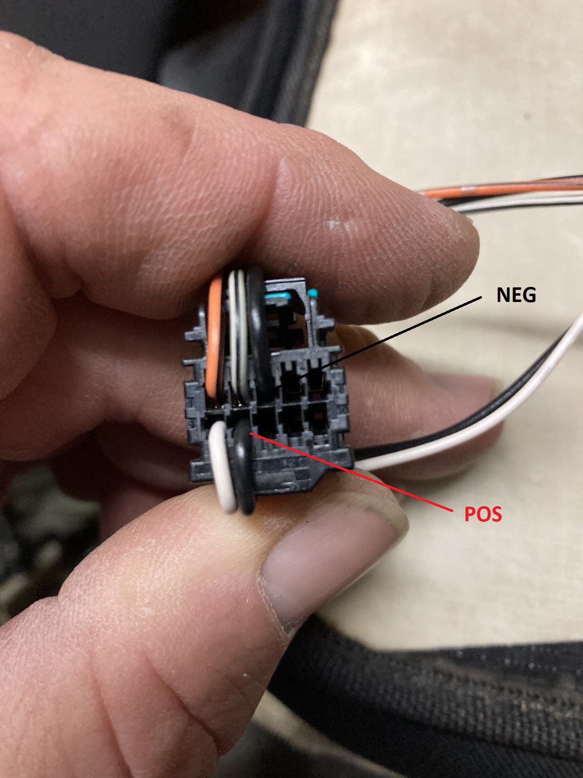

no pretty sure they work anytime you press the button regardless of the temperature, they are on a timer which I believe is 10 minutes and then they automatically shut off until the button is pressed again
Yeah sounds legit. I would think that would be mentioned in the owners manual which it isn't. So I did some testing and now I def have the driver side working but not the pass side. And for sure for future reference for anybody the marked wires in the attached picture are on the mirror plug and for the heated circuit. The pos does come on and off the the rear window defogger switch. And the neg is a constant ground.
Freezing my ass out there tonight so hopefully tomorrow I can check the pass side circuit.
TAG heated, mirror
TAG heated, mirror
