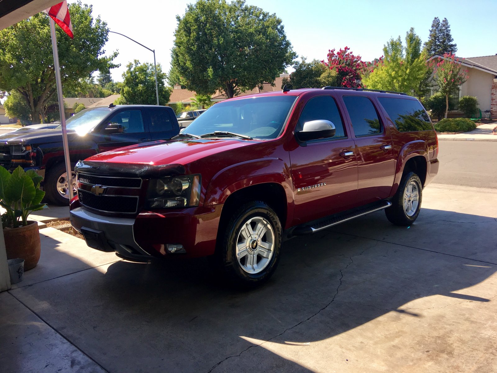

Pic works but not sure whose Suburban that is??
Seems like some gap in them fenders and different wheels.
Wonder if he's a member on here?
