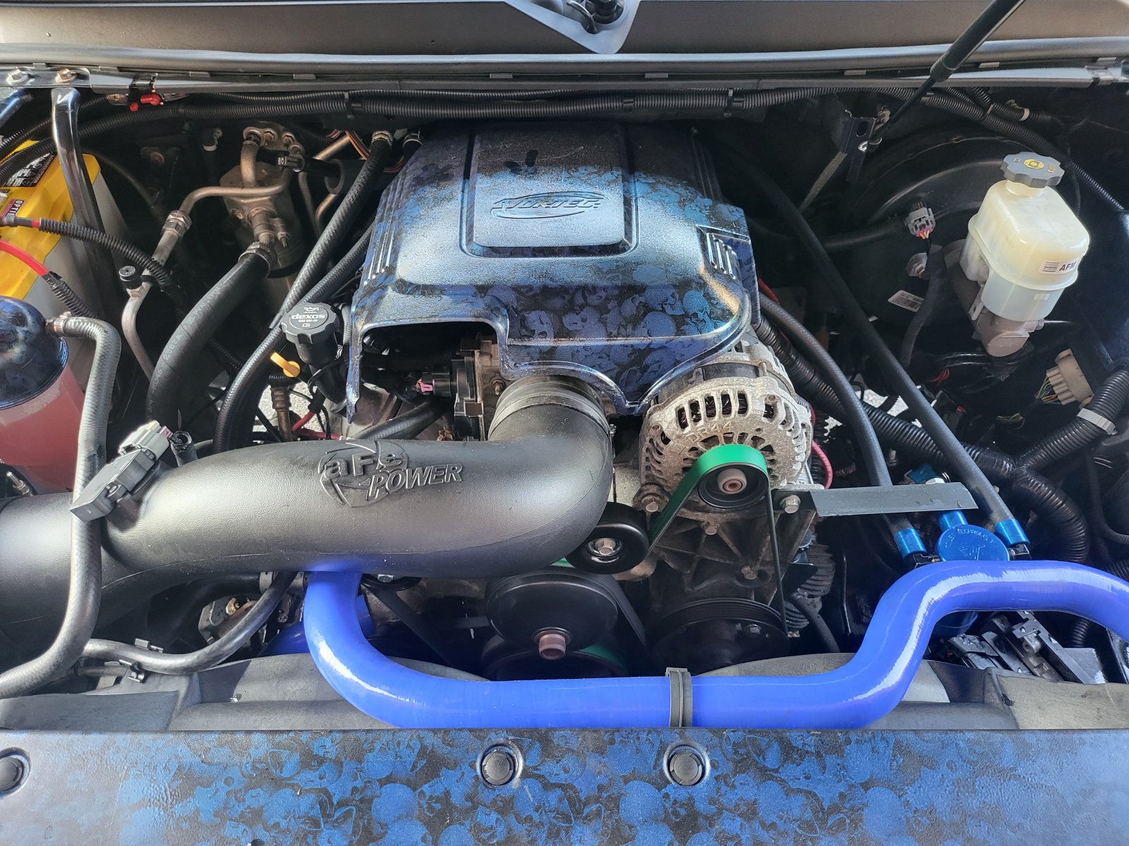

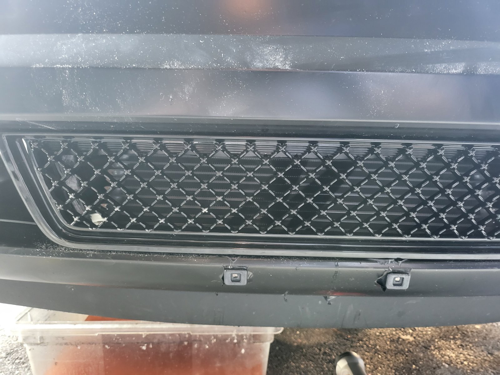

Swapped in the mishimoto radiator ,the 700w fans & added the trans cooler. Mounted the cooler behind the false lower grill cut it out to make it functional Also did the Gates bell tensioner & both belts. Radiator went in with no trimming or any issues. Short drive after & coolant temp seemed to be about 10 degrees lower than normal
